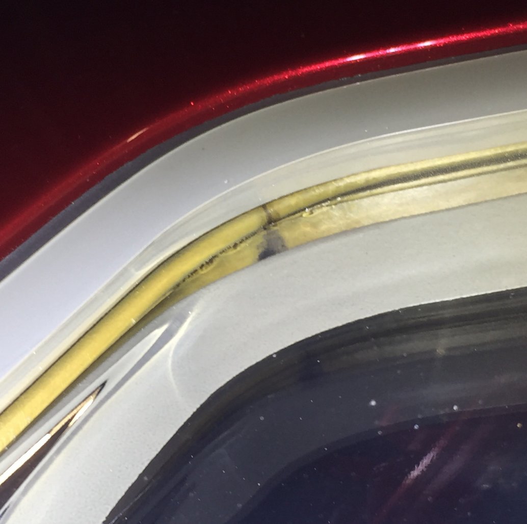

Gizmo - what did you try for re-sealing the outer lens? We've got one that seems to have a failing seal. Not feeling hopeful but wondering if we can find som FM for it ...

Not sure what I have going on - we'll have to pull the headlight to figure it out. Car hasn't been wet in about 6 weeks (though it's been in a garage where other wet cars have been parked) & after being parked in the sun for a couple of hours the driver headlight had some condensation on top. Looks like it has some kind of split/crack/leak at the top where the black spot is. Maybe it will be an easier fix than trying to re-seal the clear part. :dunno:
Just in case you need to add some external sealant:
Although I have not run across this specific problem I have had remarkably good luck using Permatex® Black Silicone Adhesive Sealant (NOT RTV) available at AutoZone. We use it to seal emergency lights into the headlights and tail lights of our police cars and it works great, keeps the lamp enclosure water tight.
I have used this product for a variety of automotive applications and it's excellent at sealing things along with being an adhesive. Prior to curing it cleans up easily with WD-40.
