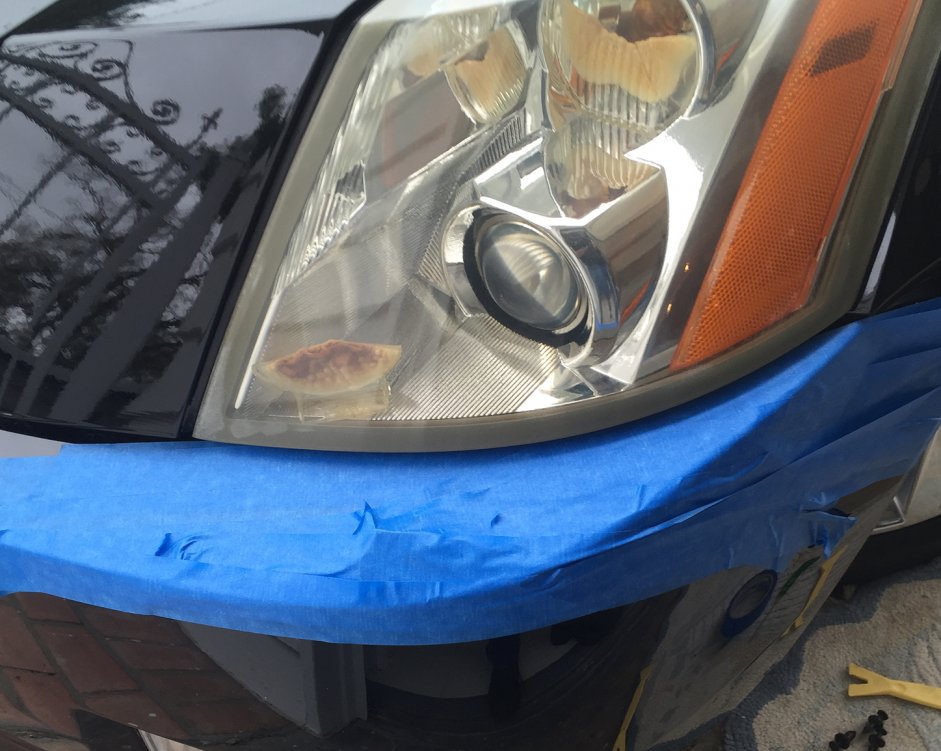

Until I can get new headlights here's an option IF your DRL lamp plastic light diffuser is melted or has partially broken off inside the light housing.
If you follow this procedure do so at your own risk... and remember these lights are hard to find.
Protect your bumper!! I used some painter's tape

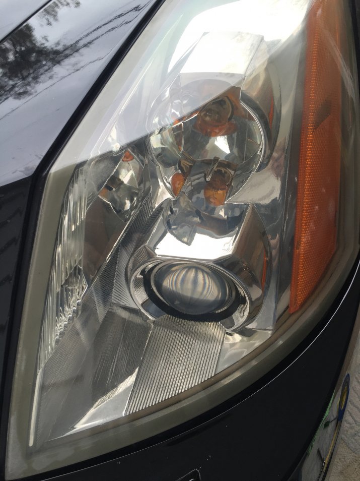

After removing the DRL lamp it's possible to reach through the hole and knock out the melted plastic insert. The melted / brittle plastic lens will break apart easily with a pair of long needle nose pliers and the pieces dropped out.
So does the bare bulb look better or worse than the melted lens insert? Well probably not but this is going to have to do for a while.
View attachment 5976View attachment 5977
