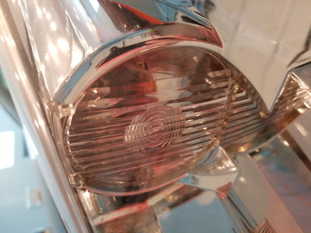

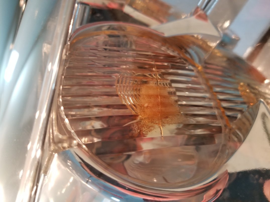

Anyway, checked headlights (see photos)... Driver side 'looks' ok but I can just start to see the beginning of some orange burn color.
Passenger... uh oh, but JUST starting... this forum helped me out, so I caught it in time I think and I can live with the small spot.
Yanked BOTH bulbs, no sign of any splices in the sockets nor do they look burned? (My Porsche 911 used to COOK these things)... so never touched by a recall etc.
So, I will look here at the posts for the best idea on a part number for LED replacements that doesn't upset the computer in the car.. unless someone has a specific part # that works ok

Do a search on LED replacements for DRL’s. I wrote an extensive how to last year. You have to install resistors to avoid hyper flash.
apparently the bulbs I have must have the resistor made In them as they flash the exact same speed as the old bulbs. I have used these in all my cars with no problem, I put some on my trailer and they flashed fast but I found out that was because I needed a bigger flasher in my fuse box and now they work fine. They are not the 1$ a piece china bulbs but the 5$ apiece china bulbs that the parts store sells for 25$ apiece .You can get them at bulbs are us or batteries are us I think they changed their name. I have them in 4 xlrs in the area no problems at all. I will try and find a box to post the part number . here is a quick fix fro those that do not want to try. Just buy this bulb adaptor for a plug and play easy installation. I just looked and the bulbs I bought and have been using are now 25$ each on ebay as they are a factory replacement bulb for Italian cars.

Can’t recommend Tim’s how-to info enough - we used it to replace the DRL’s lights on both of ours with great success. This really is becoming a must-do for any year XLR, since as time goes on some of the later models are also developing problems.
LED's and thanks again
LEDs are in, I have a lift in my garage so wheels off, panel off and headlight out made it a breeze. (FYI the SLK 55 AMG requires the same thing to put bulbs in)...
Resistors on order to solve the fast blink. No more melted headlights ever.:blinzel: Right?
