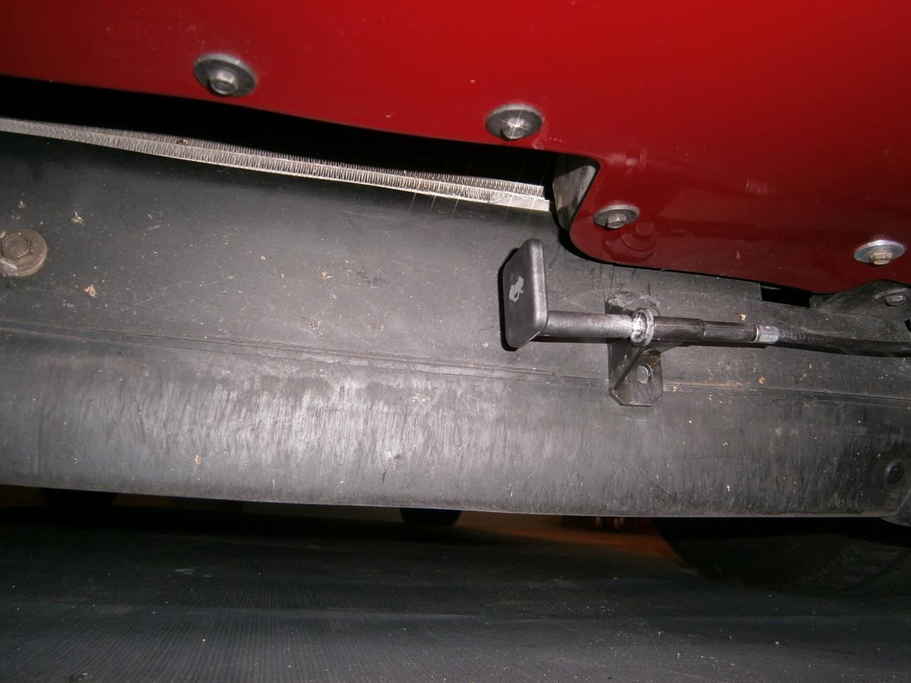

Ben, I think everyone that owns a XLR has battery problems if they let them set. I was told by my mechanic at the Chevy dealer that specializes in Vets that because these vehicles are all electric there is a constant pull on the battery to keep memory in the computer which causes the battery to die if not starter frequently. I have installed a external release for the hood so I can get to the battery easily. I will try to attach photo.
