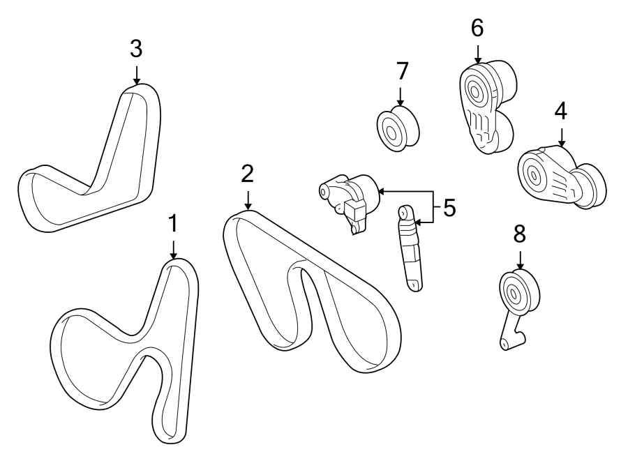

4 is " Accessory Drive Belt Tensioner Assembly. SERPENTINE TENSIONER.
This Fits Your 2008 Cadillac XLR V Convertible 4.4L Northstar V8 A/T
Part Number: 12598023
Supersession(s): 12589201 " ...and lists as available 'soon' from my perspective.
6 is "Accessory Drive Belt Tensioner Assembly. SERPENTINE TENSIONER.
Part Number: 12582465 " ...sadly lists as discontinued.
I'd wager what you have can be rebuilt providing it's not physically broken. And though the GM drawings don't ever seem to be super-accurate, if the design is even similar to the available one, maybe a bit of swapping pieces would work.
