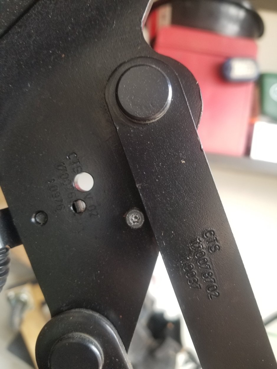

It is not the cylinders; the struts hold it until the pressure is reversed from the cylinders. I know from my own experience btw there are some small screws near the top of the metal lift brackets you have to remove to get enough up to lock in the shocks. It is a t screw on both sides remove them and it will allow you to raise the mech enough to pop the top of the strut on. There is a post on this forum. must read replacing trunk lid struts.

It is not a Video it is part of this forum " must read replacing trunk lid struts".Once replaced you will notice a huge differance in the trunk and no more droping unless you tell it to. The struts are so easy to replace can be done start to finish in less than 20 minutes. Keep in mind that you will need ether a additional person to hold the trunk up while you change them or a prop, handle or pipe. I was able to do it myself and used a stick to assist. Once the screws are removed use a flat head screw driver and slide it behind the spring behind the knickle of the strut (and reinstall will require the same) then wiggle the lid up and down to free the shock. Both sides will require access to the bottom driver side the carpeted pump cover and the pass side the storage bin. You will need a slender flat head screw driver to hold the spring open in the storage bin when in place remove the screw driver to lock it in place. be sure to reinstall the torq screws you removed as they are a travel limit stop and if not there could cause damage in the operation of the opening trunk and mechanism. By the way this information came from that huge service manuel you mentioned. I can not be sure if the drilled and slotted were available then but I put them on mine just because I wanted to and the rears were grinding on the rotors so I decieded to do all fours and using ceramic pads (less dust)! Do some on line shopping to save.
