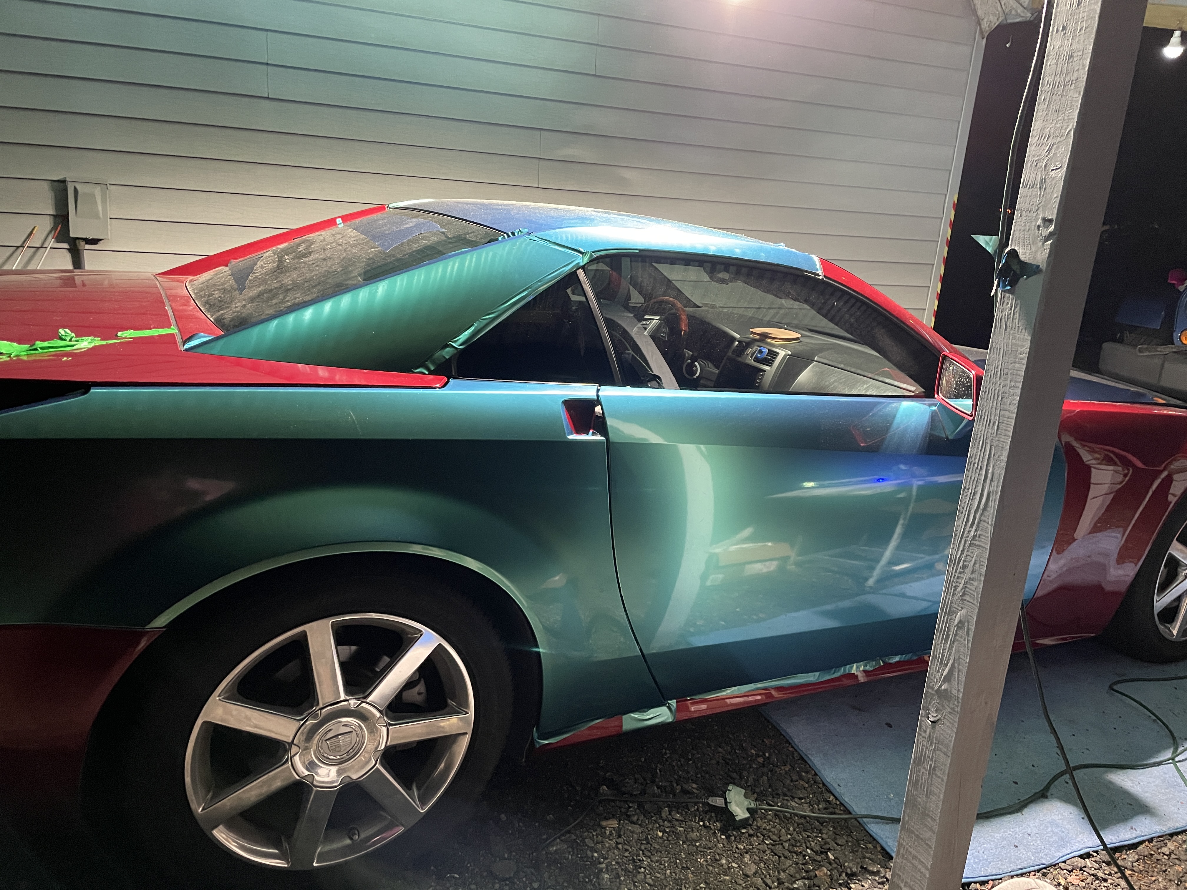

Thanks so much, Gord, for responding! My XLR was recently “totaled” due to both tail lights being damaged. Everything else in working condition, and I stumbled upon a SET of working tail lights for $1100!! On OfferUp. Installed those, replaced the bumper and trunk with parts all for less than 5K. Decided to vinyl wrap car to get a unique color and removed door panel to loosen side mirrors. Great advice on speaker, that will give me better access. DD8CE934-B6E4-455D-B7F9-1ABB796DBB42.jpeg
