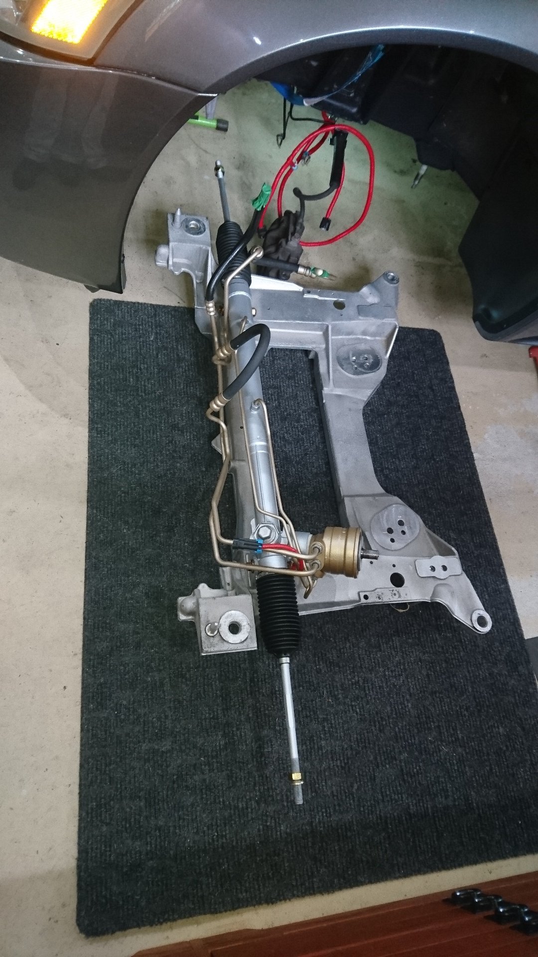

I guess it was Sunday past, I managed to get the front subframe and steering rack reinstalled. Quite easy actually and so, so nice to have the 17 years of grime all cleaned off as well. That makes for such a nicer environment, especially lying on your back!
Biggest hassle had to be not having an 18mm ratchet-wrench and not having the sense to at least snug down the top nuts of the motor mounts while the frame was out. Right side went quite well, left side...that took ages. They're conical locknuts, so every rotation requires a fair amount of pull. And when you can't get more than about 1 flat at a time without flipping the wrench....arrrggh!
Lesson learned - now back to hanging all the suspension and easy stuff! :)
Oh, a P.S. This of course was on account of a damaged oil pan. It arrived complete with gasket, fasteners, level sensor...the works. Fresh motor mounts too.
I went to hook up the oil level sensor and surprise...it was a 3 pin unit versus the 2 pin connector this car has. No big deal, it's accessible at any time, more just a FYI in case you end up having to do the same task.
I'll suspect the 3 pin is more recent (maybe >'05), so if and when you order the pan and if you do have a 2 pin connector, 'splurge' and get a 2 pin sensor from wherever so you'll have it handy just in case. They're like $12 and I would not reuse the old one...plastic, cheap and rather crispy after so much time in hot oil.

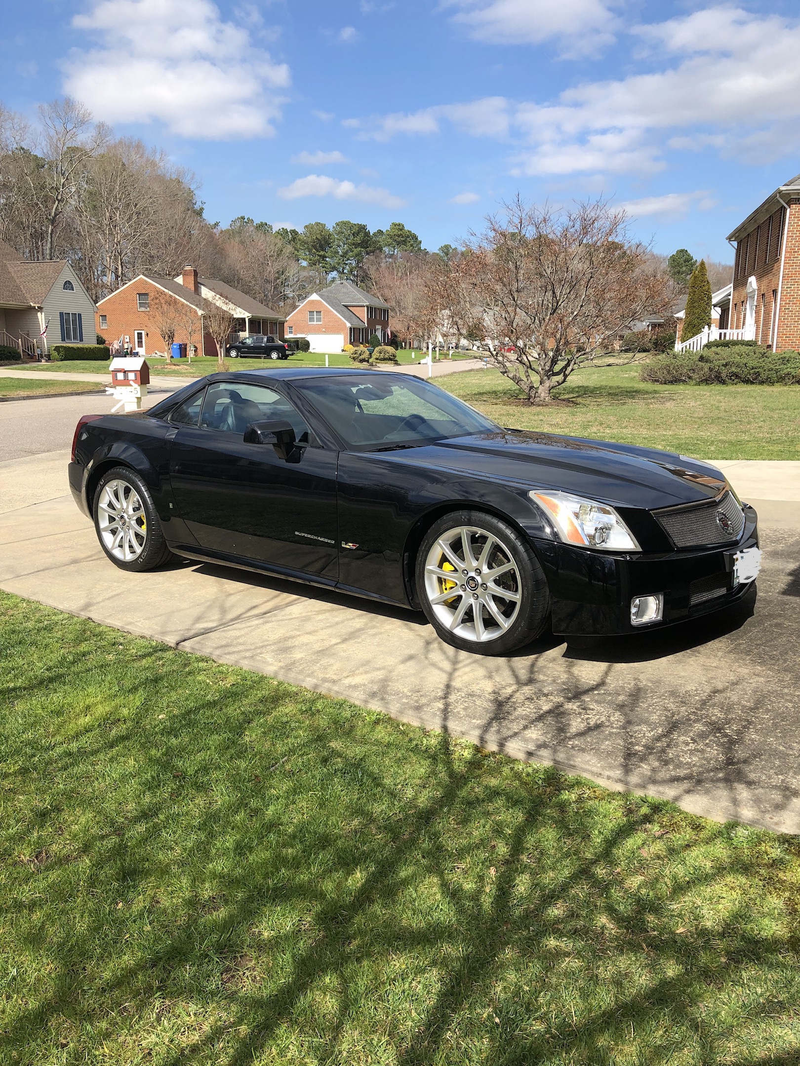

Yay, roughly 6 mos. later I’m the first to have done anything “postable” with my XLR. Took the V out to stretch its legs today, been a LONG time since it’s been out. Low 60’s, sunny skies. Tomorrow we get a wintry mix …
