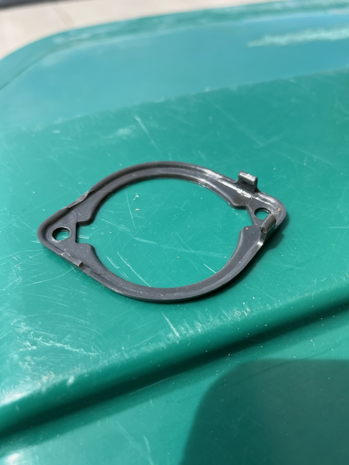

Has anyone heard of someone reproducing these speaker grill retainers? If so,
can you post who has done this and how to get in touch with that individual?
I am in need of two cause I am in the middle of replacing my driver side seat back leather.

Any luck? I need the same
Reviving this thread. I need both for driver's seat. I have a friend that can write the gcode for 3D printing, and I have a printer. Working with the op and will post up our progress. Show of hands, anybody else in need?

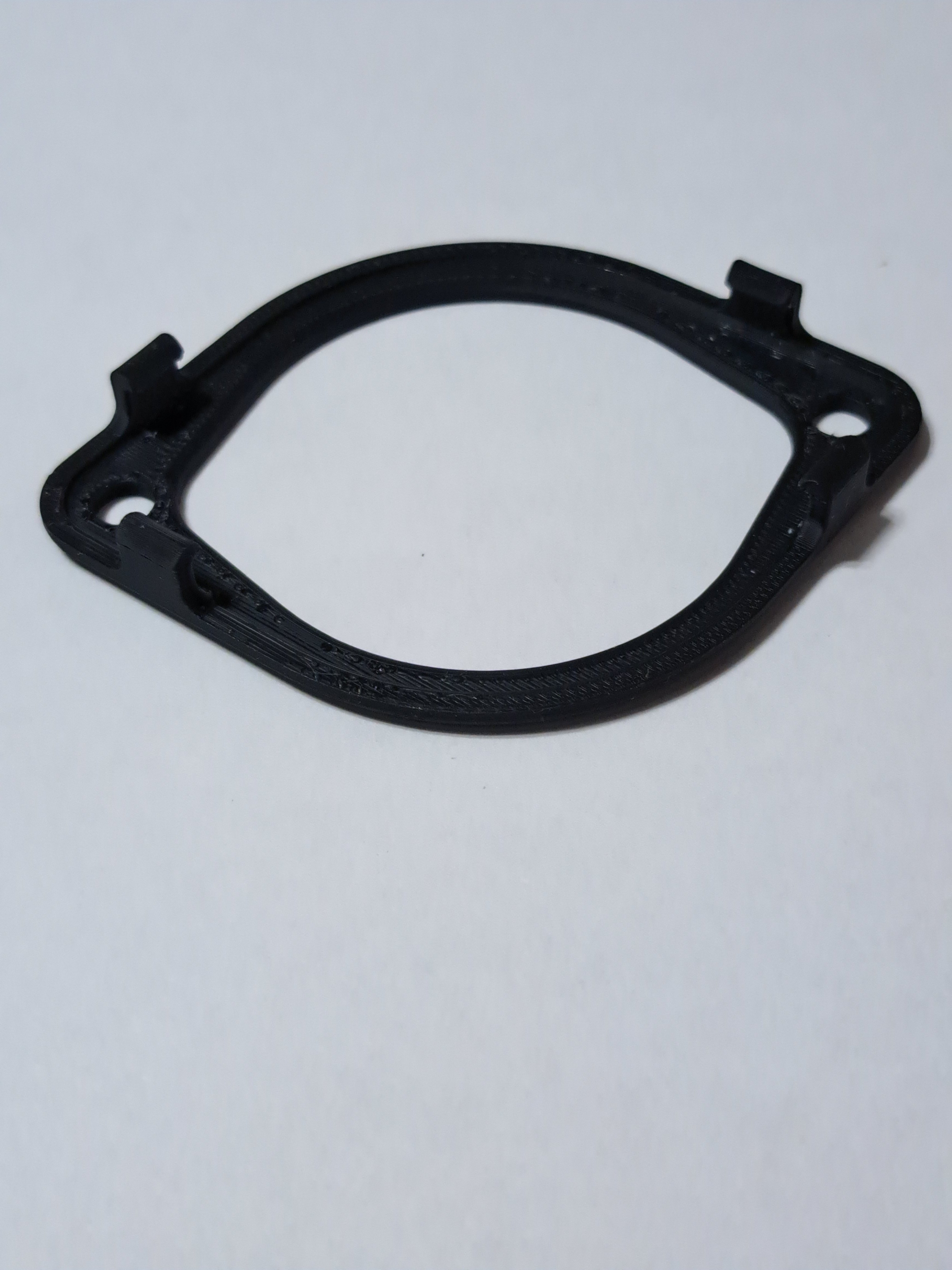

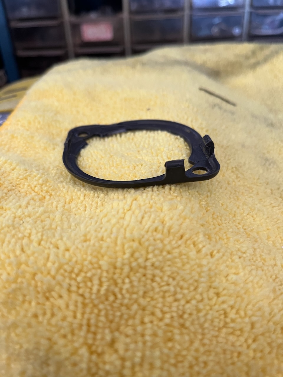

Update Feb. 29th, 2024, Seat Speaker Retaining Ring.
Received some drawings for the part and attempted to do a drawing myself. Sent my drawing to the CAD guy and as he tried to model it, it wasn't working. The op, "TheOldMan" has sent his ring straight to my CAD guy for clarification. I removed one from my car and it instantly became 4 parts, Thanks to the op for sending his part.
I've alerted CAD man to BOLO for the part and to check his email for updated drawings. We've discussed strengthening the tab to increase strength, it appears it can be thickened up a bit, so the tabs don't just snap off.
I expect some trial and error in the prototyping phase, however when we have a suitable part, I'll let y'all know.
I have the PETF filament and also bought a heater/dehumidifier for the filament roll, a pre-heater which as I understand benefits the material I'll use.

We had a member that made them and i bought and used a dozen on them worked perfect. They were made with a product that is printed then baked and is more like a metal. Any 3d printing materail is made of lines of material that are bonded to each other. Anything this thin will not stand up. It will break at the joint lines. If you are a programmer and can write your own code you can make the part strong by printing in solid and the finest line you can then each pass has to be made at 90 degree angles to the last pass. . best metod woukd be to make a mold and injection mold them. Thats how the factory did. then with a carbon fiber product it would be strong enough.

What you say is correct mickeytee, the filament is ABS and the process you've said is called tempering. PETG is not suitable for this application. To print in ABS my setup will require some minor upgrades of which I'm in the process of doing. The attached photo is our prototype in ABS.
Well at least its a part that does not have a lot of wear andbif you caj snap it on one time that shoukd be it. The four clip areas Really could be built up a bit and still not rub the covers evan a taper at the bade would help. All the parts people have made and sent me are made so thin to try and duplicate factory when they can be larger and thicker with no problems. Jusr remember the sun coming thru the window can heat them up to 100-120 degrees
