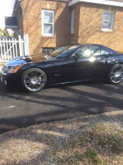

It's the 'V' model grill. It was on the car when I bought it, but I probably would have put it on anyway. I like that mesh a LOT better than those Venetian blind slats on the base models. Also have it on the lower grill.
Have added Magnaflo mufflers. Curb sensor. Heat shield under the center console, and wind deflector. Red's getting pretty close to what I have in my mind's eye. Still would like to add backup camera, and upgrade the navigation system (the standard one SUCKS!). After that, maybe a little paint chip repair, and he'll be PERFECT!
