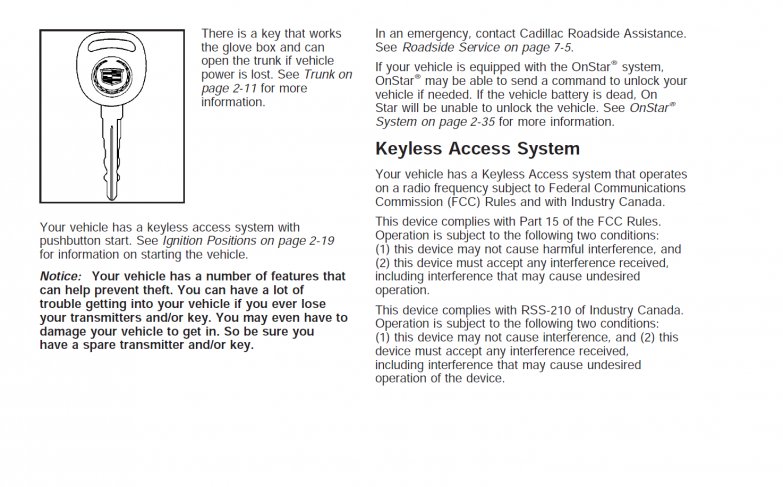

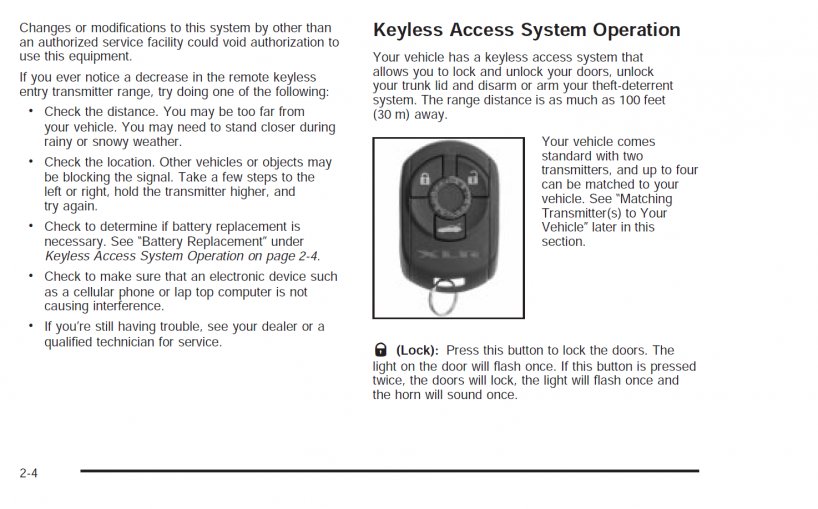

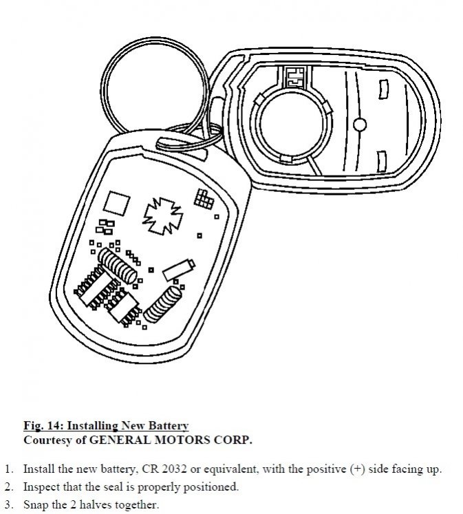

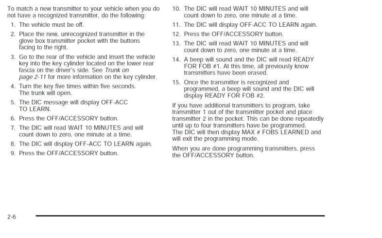

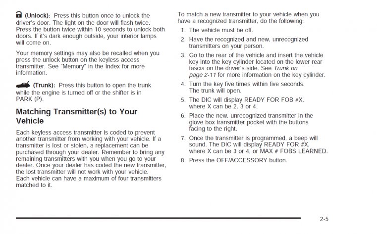

Enclosed are copies of the 2004 owner manual that shows how the FOB battery should be installed, then on the last text send to you, GM explains on how to get stared the car with the FOB in glove compartment.
Read these pages it could help you in getting the XLR to go, as the car battery is full charged and the theft system cycle should be completed.
If the XLR refused to start, the last solution is to have it scanned at the dealer, hoping it is not the starter again.
