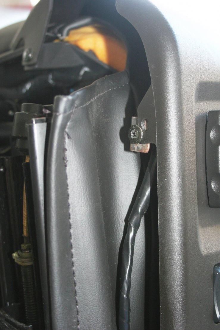

I've attached a pic showing two of the screws on the switch cover, --one of which is recommended the seat to be removed for access on the lower/outer edge. On mine, it wasn't even fastened through the tab hole. On the passenger seat, the mounting tab was broken off. In both cases, the switch cover was loose and flexed whenever entering/exiting the car. I've attached a pic.
Seat removal is fairly easy, but a second set of hands is recommended since the seat is bulky and a lot heavier than it looks, making it very easy to scratch the kick panels when moving the seat in or out. A heavy mover's blanket or something similar is recommended to protect the kick panels as well. I've documented seat removal on this site in another post.
