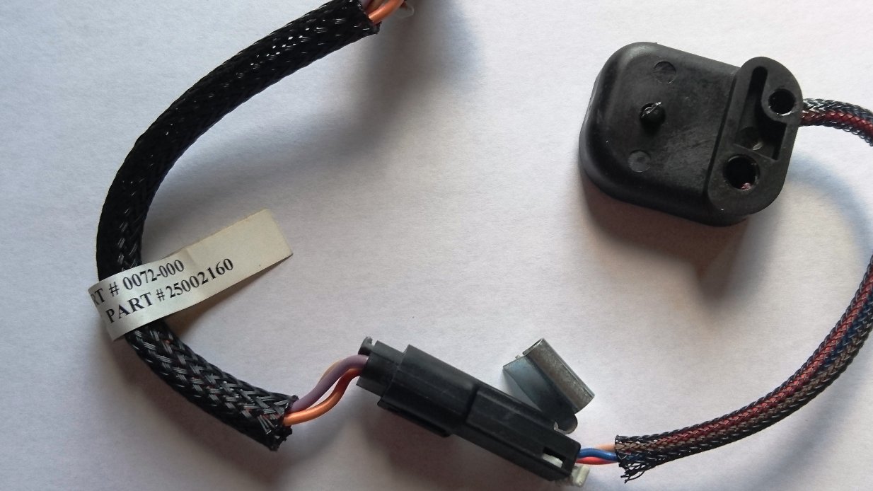

That thing is a potentiometer of sorts. I suppose it could decide to quit outright but I seem to recall that the top has to be cycled as though new, in order for all these "switches" and such to get their settings, i.e., it's not on and off best as I understand, it's ohm value 1 versus ohm value 2.
I'd have to ask if "Sheehan Cadillac" has been savvy enough to know this, and if so, what sort of resistance readings is the potentiometer giving back when in the appropriate positions.
I've taken a picture of mine and it has a couple of other part numbers on it. One says Micro Craft #0072-000. They probably made the thing. Below that is CarTop Systems #25002160. C.T.S. of course made the whole roof contraption and not only for Cadillac, but for just about every other automobile manufacturer in the world that offers an Origami roof (probably the same switch in say...a Volvo or Daimler).
Maybe give Klaus a call or write at Top Hydraulics. He's no doubt a shipload more familiar with the failure rates of things like this than anyone else on the continent. I'd still wager it's just not set-up properly or maybe it can be cleaned with a little electrical cleaner down through the potentiometer's 'spindle'.
