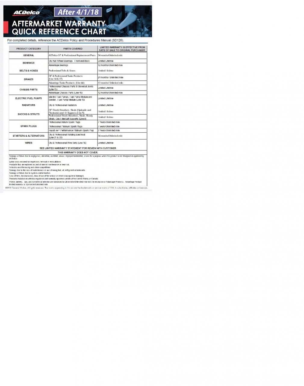

For your information.
ACDELCO warranty for ist parts, before and after April first 2018, is that a foke from the GM supplier.
See Rockauto fot the warranty also ACDELCO.pngthey confirmed Limited lifetime warranty for xlr S/A.
I have try paste the ACDELCO warranty but their file is to big.
IAN.

garantie AC DELCO.jpgHI LTS.
ACDelco is a parts supplier for the after market parts sellers and for the GM dealers, their warranty is for the parts only as they do not service cars.
If the an ACDelco parts is purchased at a dealer, the warranty for the parts should fairly been respected as per ACDelco warranty policy, however the installation is not their business.
ACDelco is a GM supplier and they should work together with their dealers, if not, it makes no sens if there is no cooperation betwen them…..same GM network.
I have made a copy of their different type of warranty on the previous post…..I found it at Rockauto site, i knew the limited lifetime warranty was available for the XLR S/A as i purchased somes in the past.
IAN

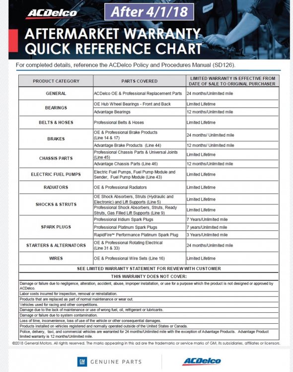

Hi LTS.
Line 3 means…... normal wear on wiper blades, tires, brake pads, bulbs etc....
Anormal wear out is as such……. leaking S/A after a short period of time, that should normally be covered by the seller or the GM dealer who has done the repairs.
If the S/A was purchased from a parts seller and then installed by a GM dealer or a repair shop it is obvious that the labor could be a problem to solve betwen the customer and its dealer or the repair shop.
The customer then will have to go and see its seller for the warranty of the parts.
It is like having cook its own T bone steak by its best restaurant on a Saturday night, the relation must be excellent or no restaurant would do that.
The Life time warranty is a game to promote sales, we all agreed, but when it is written black on white, that it is a commitment even if the policy was written on first of April, ( fool day ) by ACDELCO and GM.
IAN.
