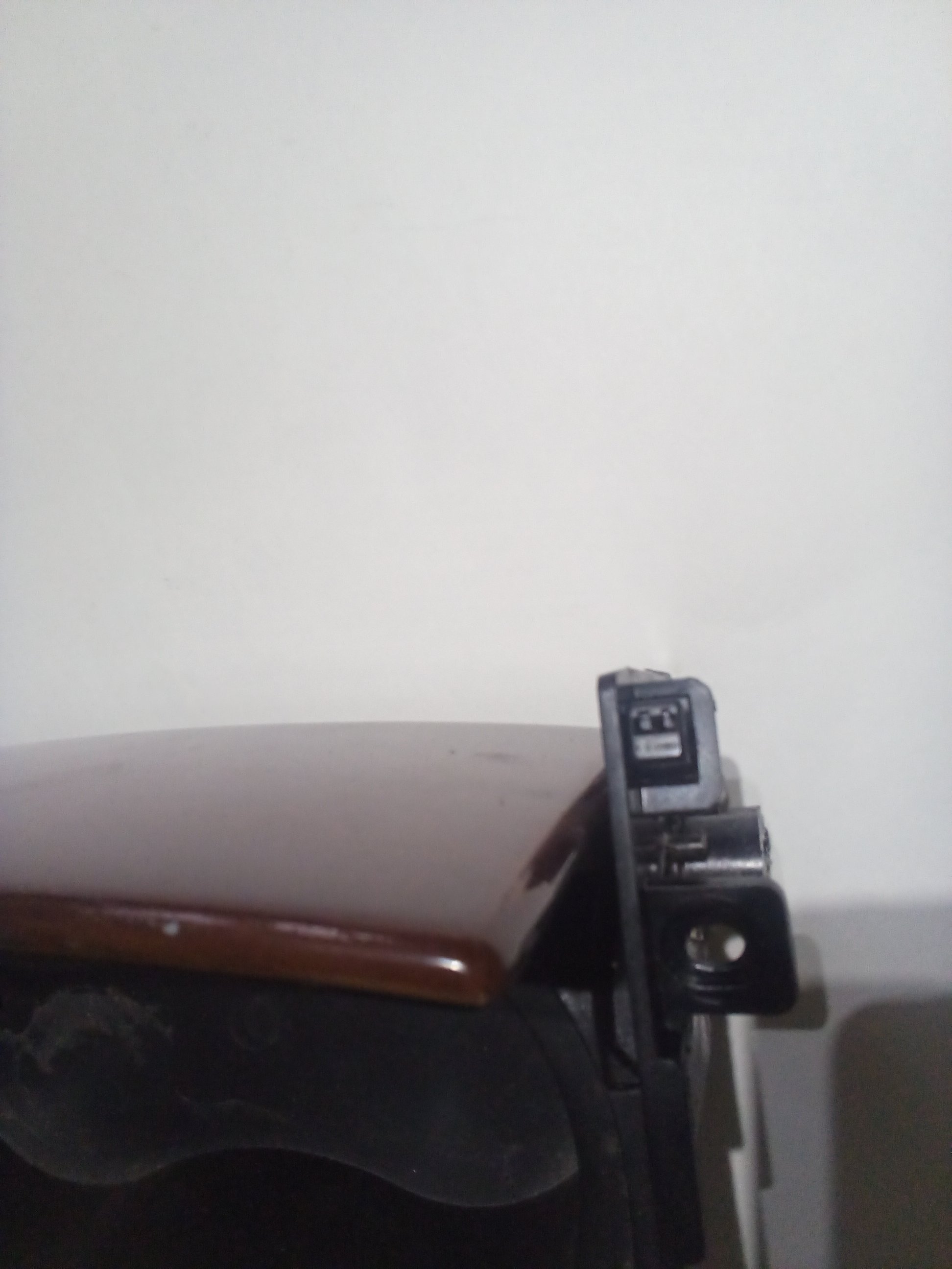

The cupholder lid if still hinged on both sides just needs a latch to repair it. I have them. 20$ shipped. Fairly easy fix
The lid is still hinged but it appears the latch as you call it, closest to the rear, is what's defective. Can you reply back with a pic of what you're describing and how to purchase? Thanks!
