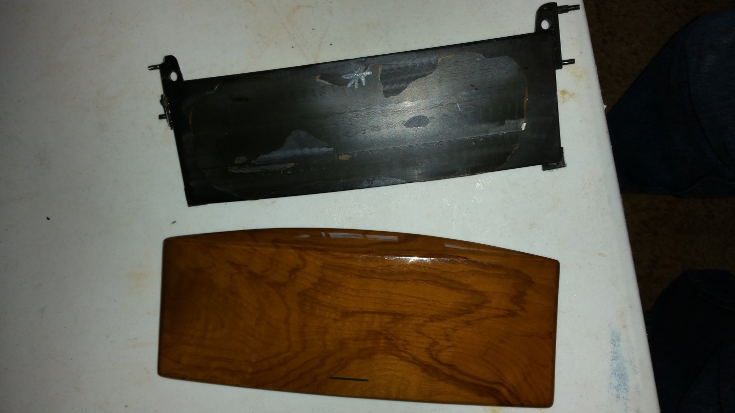

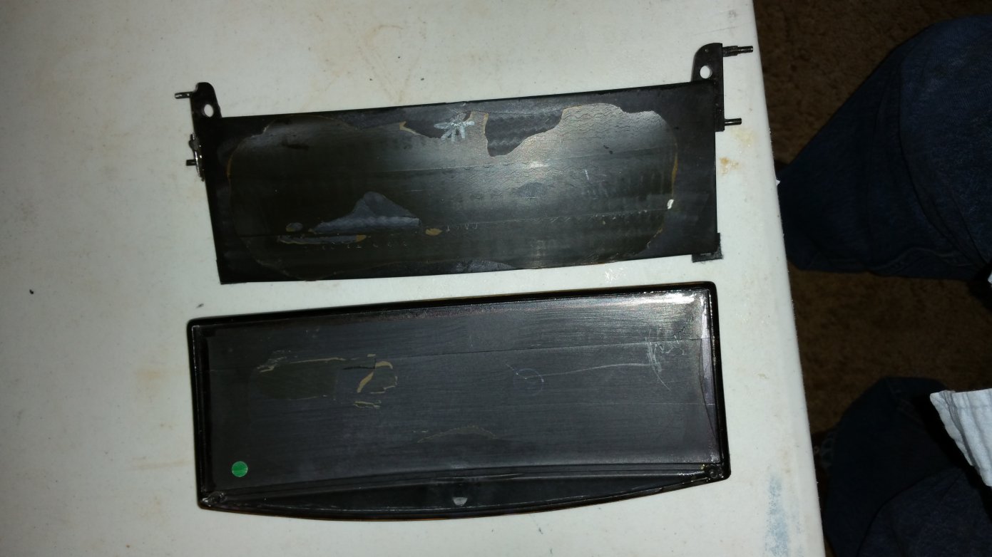

Nice weather today, drank my coffee (sorry ccclarke) and started in on changing out the console cover with the ebay cover. Getting to where I can pop it off without using plastic trim tools ;)
First thing discovered that the wood grain color was slightly off from the upper console and wood trim on the shifter side of my original cover. Soooo, removal of a couple of screws on the folding lid, small screwdriver between the wooden cover and the plastic hinged lid popped off the wooden lid, did the same on the new/old lid and epoxied the original wooden part on the ebay plastic lid. For those of you that have a working console cover probably won't think too much about this, but I'm finally satisfied with what I've done without popping off 500$ plus to get a simple thing fixed at a reasonable cost.

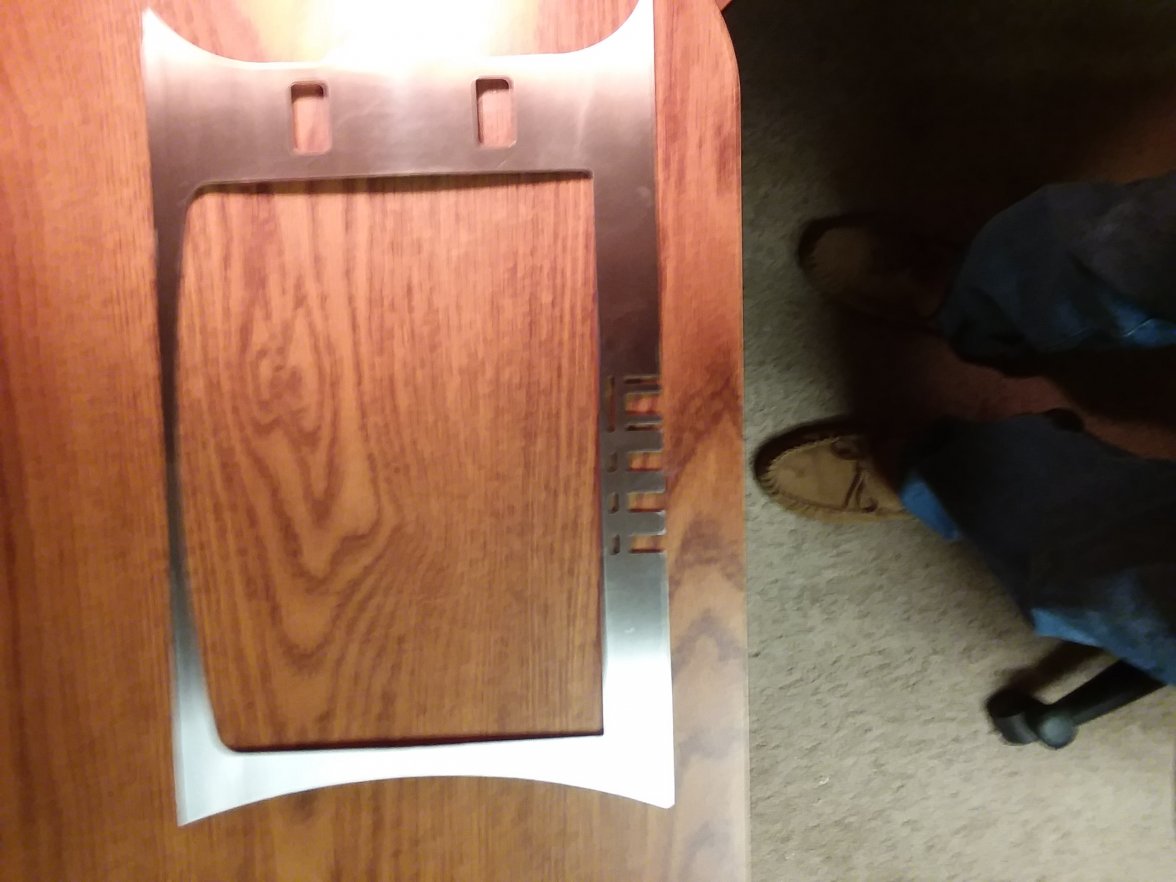

Just read the thread about the console dents etc. I'm with you about the aluminum garbage. Part of my jobs is working with Autocad. Took all the dimensions off my XLR, really time consuming, I cut it out of .074 stainless, sanded it a little bit and sprayed it with clear acrylic. I'm working on the top console now. That has to be 2 pieces because of the double contours. The problem with those brushed stainless ones you can buy are they don't even come close to the aluminum top piece. Carid sells them on ebay. Too shiny I think kinda tacky. I cut it on a water jet. I'll try to upload the .dxf file and a pic. If you know a company out your way that has a water jet, there you go. I don't know how to upload the dxf file, says it's the wrong kind??
