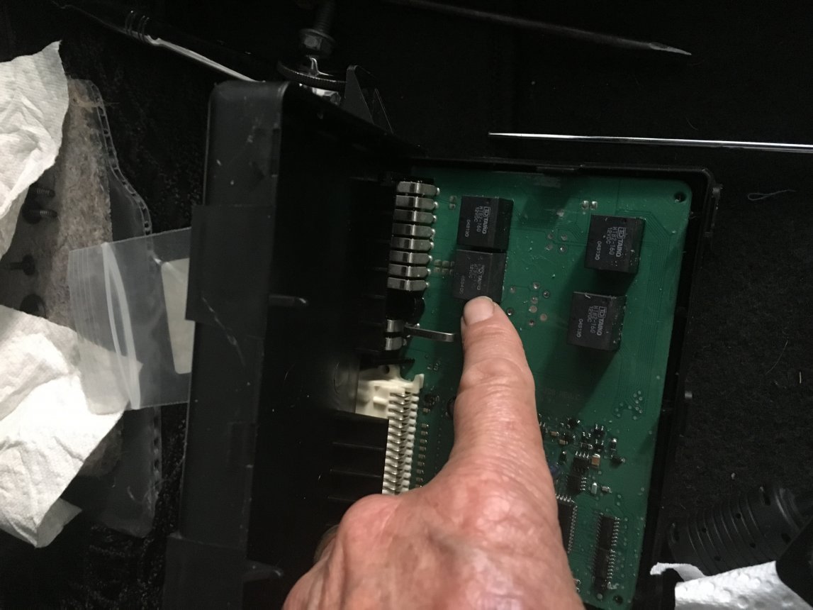

We have success... Since you cannot buy the Top Control Module any longer from what I have found, this is very important. The problem was the relay that is soldered into the TCM. I attached a picture of the relay inside the TCM that controls the trunk motor movement at the same time it triggers the solenoid valve. The voltage meter did read 12v at the solenoid valve, but it was only the low amps power, the relay did not trigger the solenoid valve to open. This is why I would get the motor spinning but no lifting of the trunk.
I ordered this relay with the same name to match the one in the TCM from EBAY, I also am attaching a picture of the one in the TCM to be changed if someone has the same issue as I did.. Photo Aug 29, 9 26 26 AM.jpg
[FONT=&quot]TB2-160 12VDC TAIKO Relay
Huaiy Components[/FONT]
