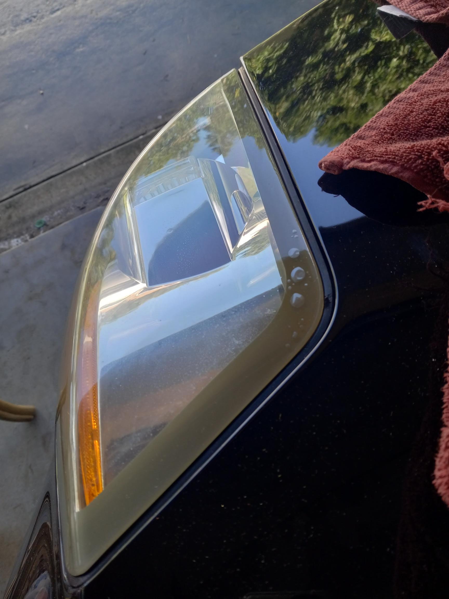

OK, so will be looking for a driver's headlight now. Can not believe the luck here. Anyone have a lead to a decent one, '06 or newer ?
Garaged and not driven in bad weather.
After having repaired both tail lights (one twice) , all the top cylinders, the starter, and now to see this, the desire to even drive it is no more. It used to be the most fun thing to do.
At least it is a trailing edge.
Bill
Hate to see it bill. This is a problem.people should be awarebof. 06 headlights were changed from 04/05 and a new manufacture was used. Many of them when new became delamanateing on the outer lens and blew off. Warranty replaced them a d that's why GM ran out and used are so high.if you look at a used light I highly recco.end you avoid any made in 06. That's whay a few eBay crooks will remove the production label 06. You can look and if you see a variance in color on the greenish gray reinforcement it stating to come off.
