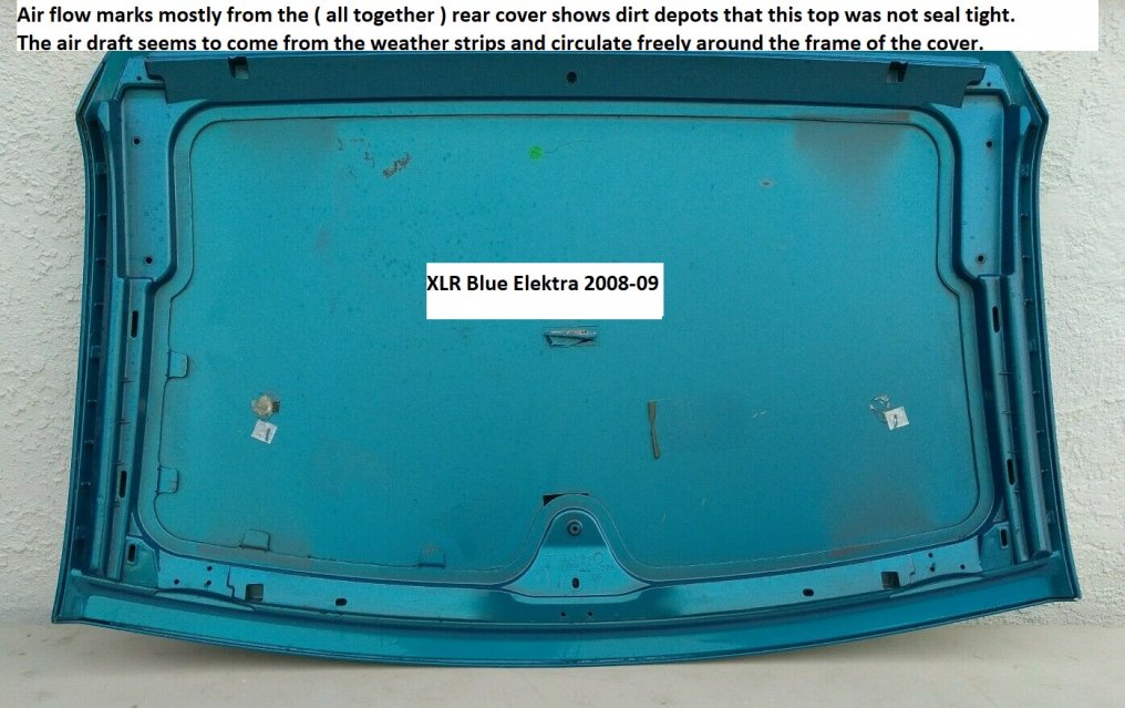

Now today i realise that it could happened, as we saw on this site some roof covers flying on the road, they say that a photo worth a thousand words is in it, enclosed is a photo on internet that shows a 2008 Elecktra completed roof cover, the cover shows internaly the air that circulated freely and the air seems to come from the rear and the sides weatherstrips.

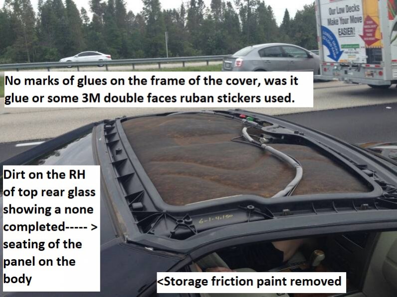

An other photo shows of pop out roof cover, showing dirt on the RH side indicating that the cover was not seating properly on the roof boby and it could get the air coming in as per previous photo shows it, the possibility of unlevelled cover could withthe help of the vibrations and the hot weather had the roof unlock and creating a very strong air pressure.
An other photo shows the type of material to bound the cover on the roof frame, it looks like a 3M ruban stickers, if that tiny ruban do not propely with both shapes of the components there could be a chance off bad bounds is in it.
The last phase on a folding top, is the roof latch to lock properly, if an hydraulic or else problem occur it could release the lock, and the top could open of a quater or half inch and create a monster air draft and the roof cover with its sticker could not be able to stay on.
