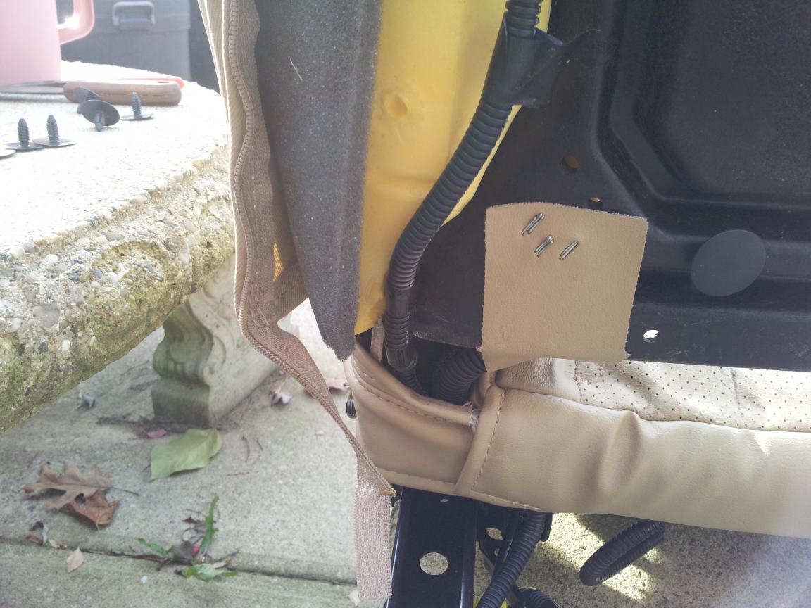

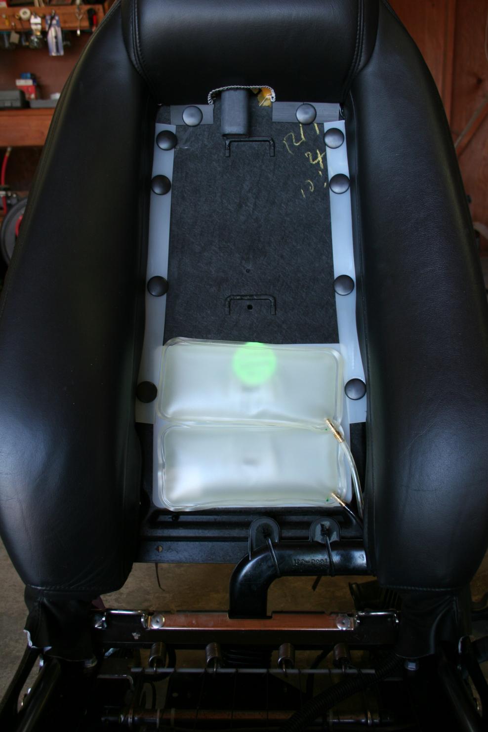

Going from memory, which is not as good as it once was so I expect I'll forget something.
The center section is completely separate from the bolsters/sides. It has a separate foam and cover. Each seat has 3 pieces. Bottom, outer back and inner back.
After removing speakers from the seat back unzip and lift up the center of the back section to expose two "buttons".
Remove the tab from the "buttons" that a flap sewn to the bottom of the center section is attached to on the back of the frame.
Push the bottom of the center section slightly towards the front of the seat.
Push down the center section to disengage from the heating/cooling duct.
See the "buttons" near the right side of the photo. Also notice the push in retainers on the bench in the background. These came in from the front side and hold the bolsters and air bladders in place.
It is now free to remove.
I remember I wish I had deflated both the lumbar bladders before beginning.
Hope this helps, No problems asking questions.

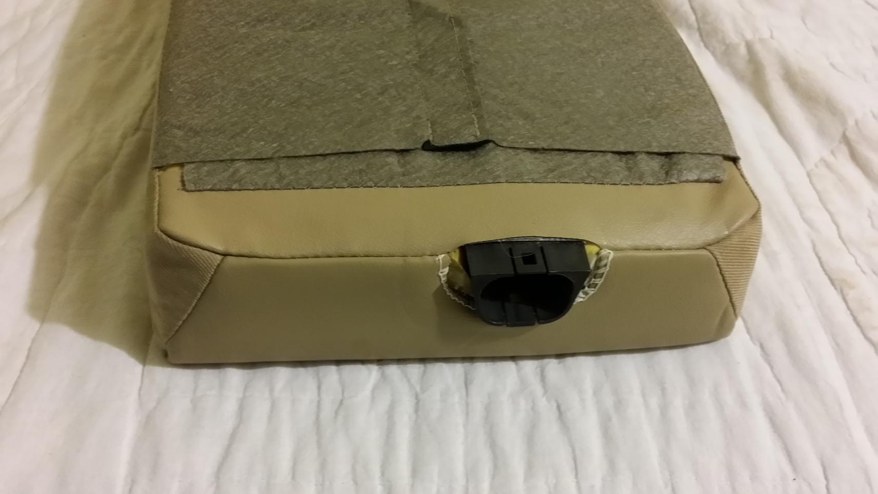

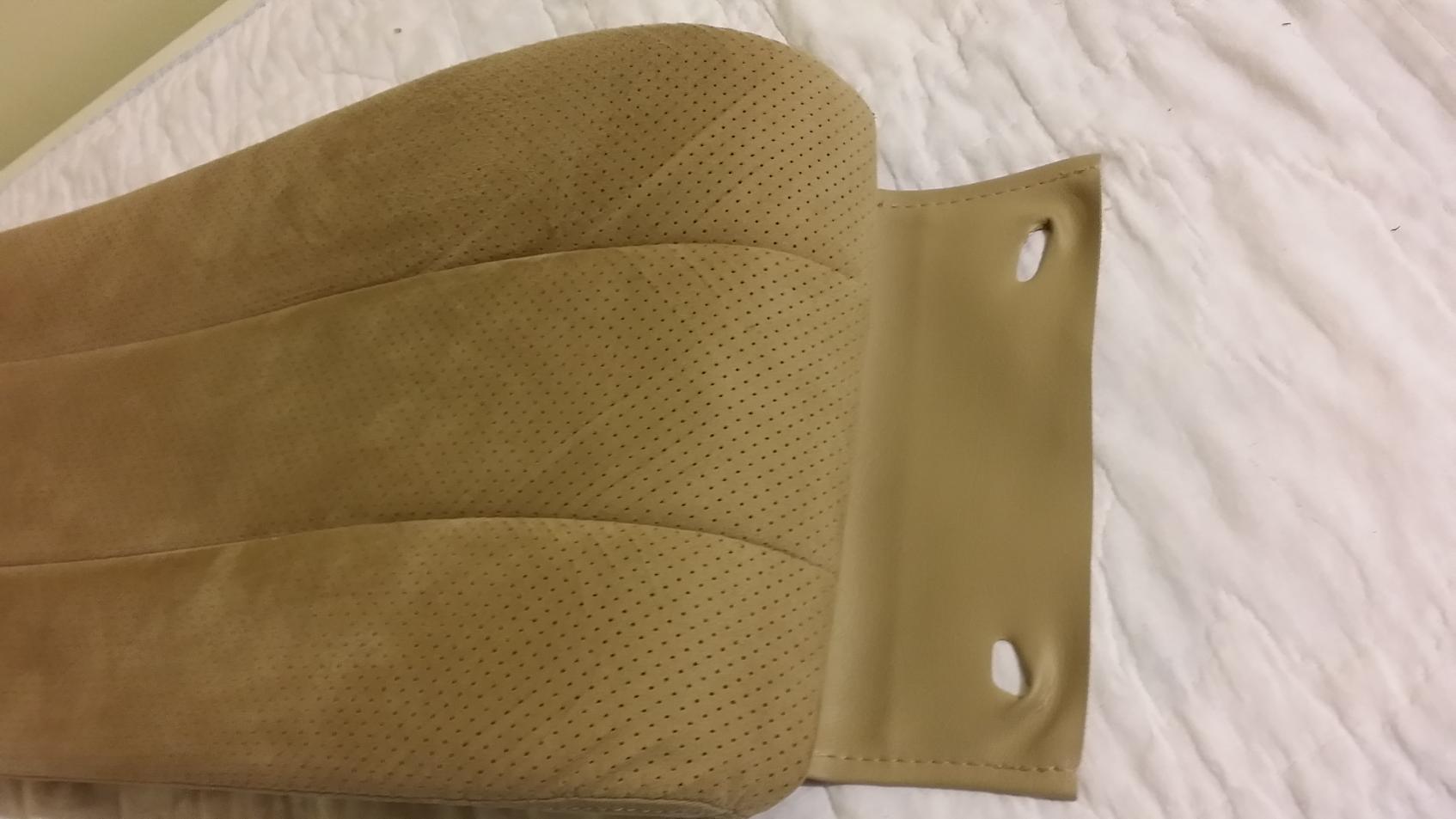

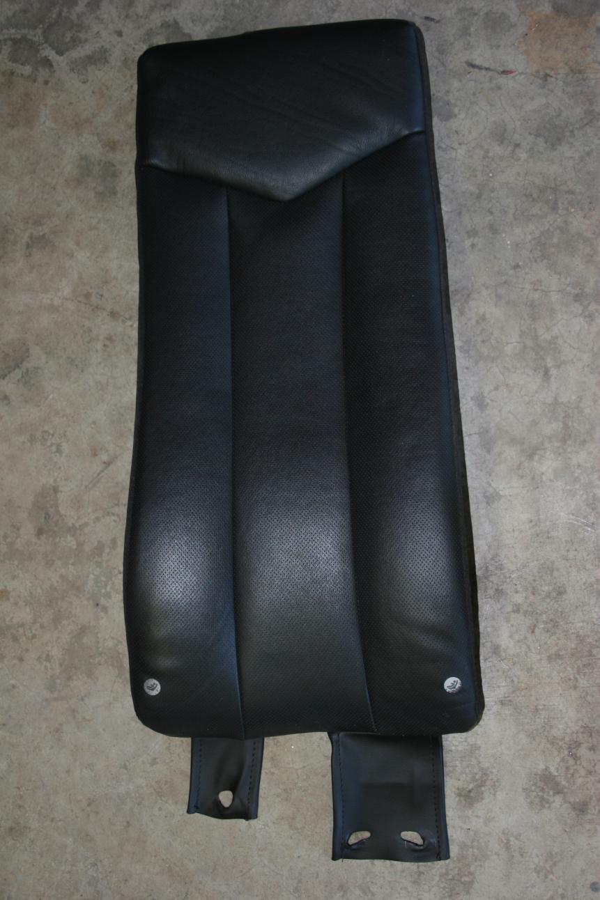

I remembered after my last post that I still have some pieces left over so I took some pictures of the center section.
There are two "buttons" that the holes on the tab fit over on the back of the seat.
Hope this helps.
You have to use a lot of downward force to free the seat back cushion from the vent tube at the top of the seat. This pic (of the passenger seat) should give you an idea of how long the tube is.

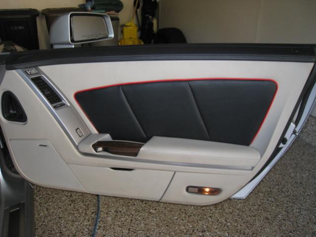

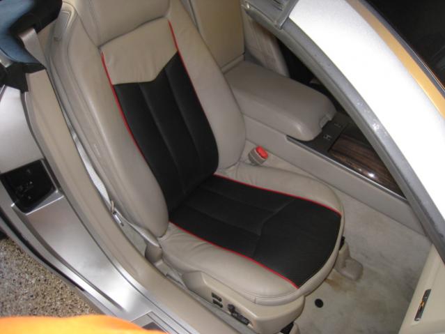

I hate to say this but that's looking like 1969 Cadillac seats, I have photos posted in this thread showing a re-upholstery job on my 06 seats that look brand new. Removed the fake suede & installed black perforated leather in seat inserts and inserts on door, so they can be freshened up, it's just going to cost a few bucks. Mine cost me around $800 which is cheap. Find yourself a older man like I did that had been in the business, of course this is in CA, but there are people around that will do it for bread money.
