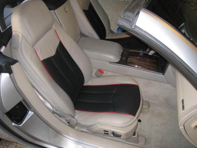

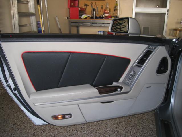

My fake suede inserts on my 06-V were starting to look seedy so a found a guy in Santa Ana, CA about 10 miles away that took the seats out, removed the suede and installed perforated black leather inserts in seats a door panels with red piping. It gave it a much sportier look like the 09. New interior seat2.jpgNew interior panel2.jpg There is Weseloh Chevrolet in Carlsbad, CA that can get just about anything for these XLR's

What did you do about the temperature control air passage in the seats? Perforate the leather?

My fake suede inserts on my 06-V were starting to look seedy so a found a guy in Santa Ana, CA about 10 miles away that took the seats out, removed the suede and installed perforated black leather inserts in seats a door panels with red piping. It gave it a much sportier look like the 09. View attachment 3168View attachment 3169 There is Weseloh Chevrolet in Carlsbad, CA that can get just about anything for these XLR's
looks great. now the big question is where in florida can they do this? my personal opinion would be to have them take the black all the way up to the headrest. But still looks great.
