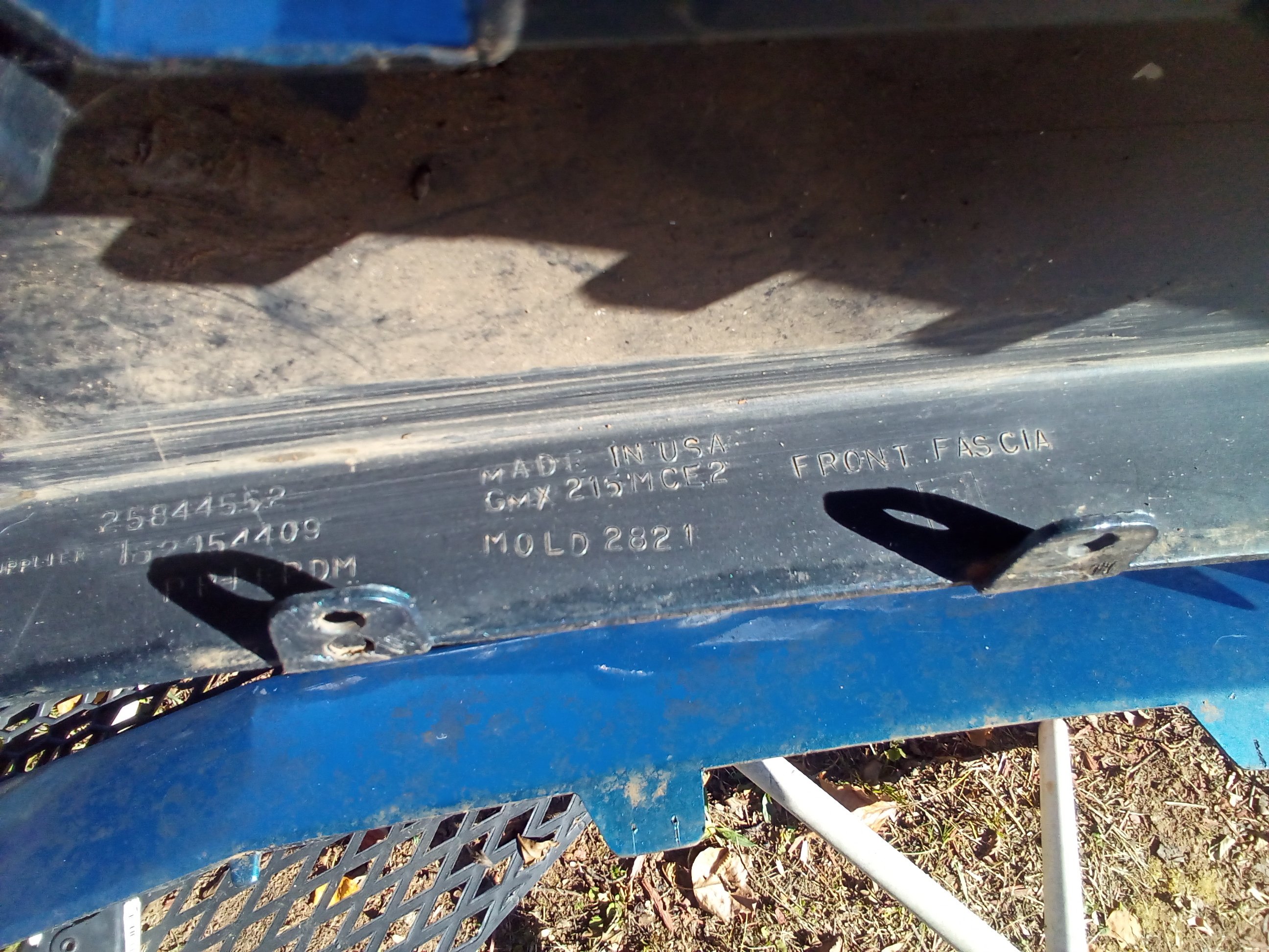

You may be correct . ibmw and mercedes all have numbers on the bumpers made into them. also they are required to have a series of production clocks stamped into them. They show shift day month year they are made to identify failure runs. Ive not needed to lookfor numbers in years but i did just look at a used 09 and it does have the vin id sticker required by federal law and the original part number sticker still attached.the numbers molded on them are usually in ares that dont show and the material is plenty thick enough to not result in any shadowing. Ill look at a bew cover i have . i looked at all the undertray pirces and they all have the numbers on them
Federal law used to require all plastics to be marked with the type of material they are made of. That may have changed
Had me curious so i looked again at the 09. Numbers still there with all the other info

Thanks Ruby and Mickey for the info - and photo. When I get my eyes on this one I'll post what I find. Appreciate your help.
