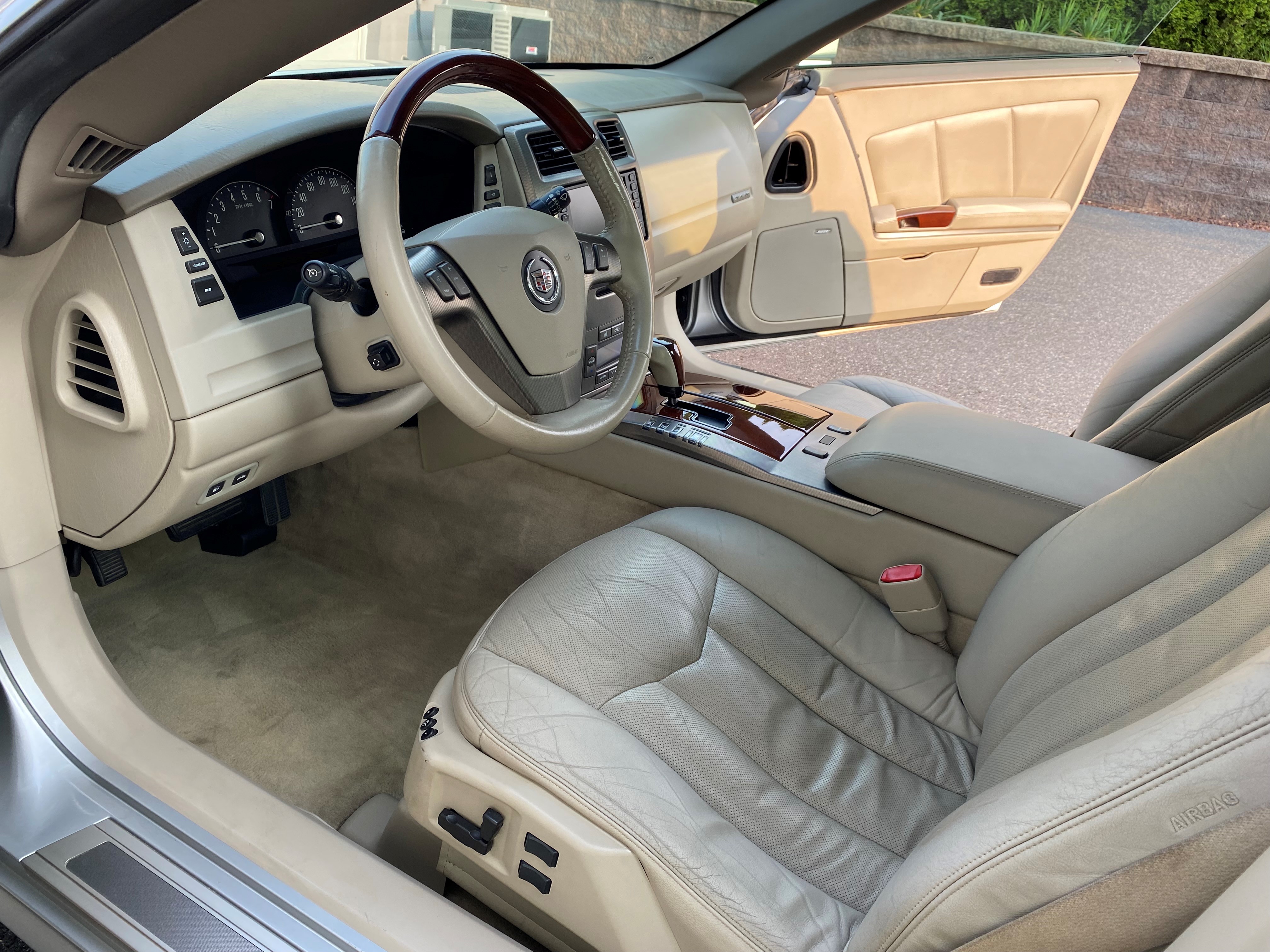

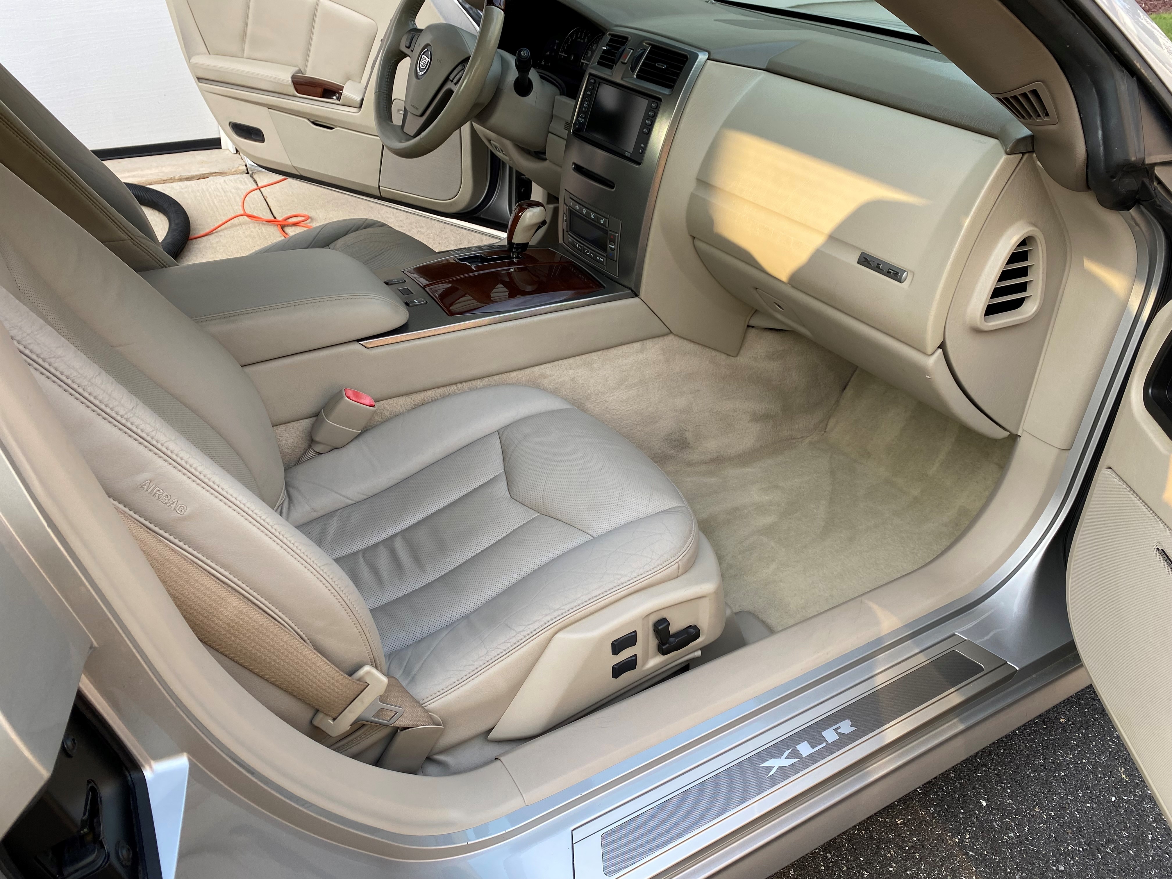

Yep, no removal. When I got the car it was 10 years old and the seats hadn't been taken care of. The leather wasn't cracking, but plenty of "wrinkles". I treated the area twice, then used Zaino leather treatment. I treated the seats once a month and never had to use the dye again. The secret is to make sure the seat is perfectly clean and dry. I've used the treatment on my King Ranch Expedition leather seats and it works just as well
Rexster,
Thanks again for info!
The seats in my XLR are the same, no cracks, just the usual "wear wrinkles", and is Shale, so shows much more than Black.
Was suggested to me by a dealer to dye the seats, to make them look better. Would help with a future trade if I would ever do that.
Did you get the "prepping products" for cleaning/prepping from Seat Dr as well?
I think they talk about using rubbing alcohol too?
Also, did you use a sponge to apply the dye?

I bought the kit. It included everything needed for spot repairs. It does need to be feathered out past the spot repair for better blending
