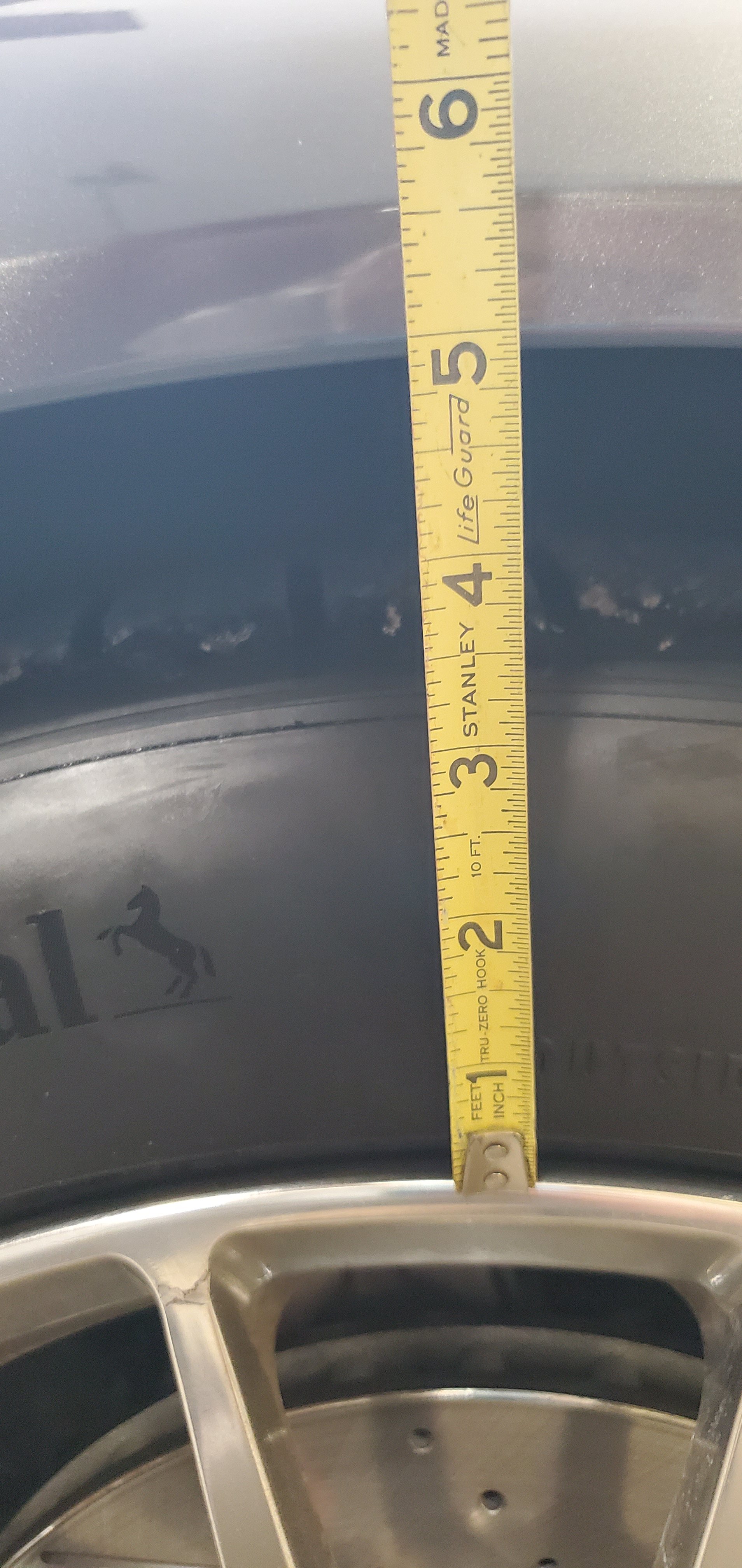

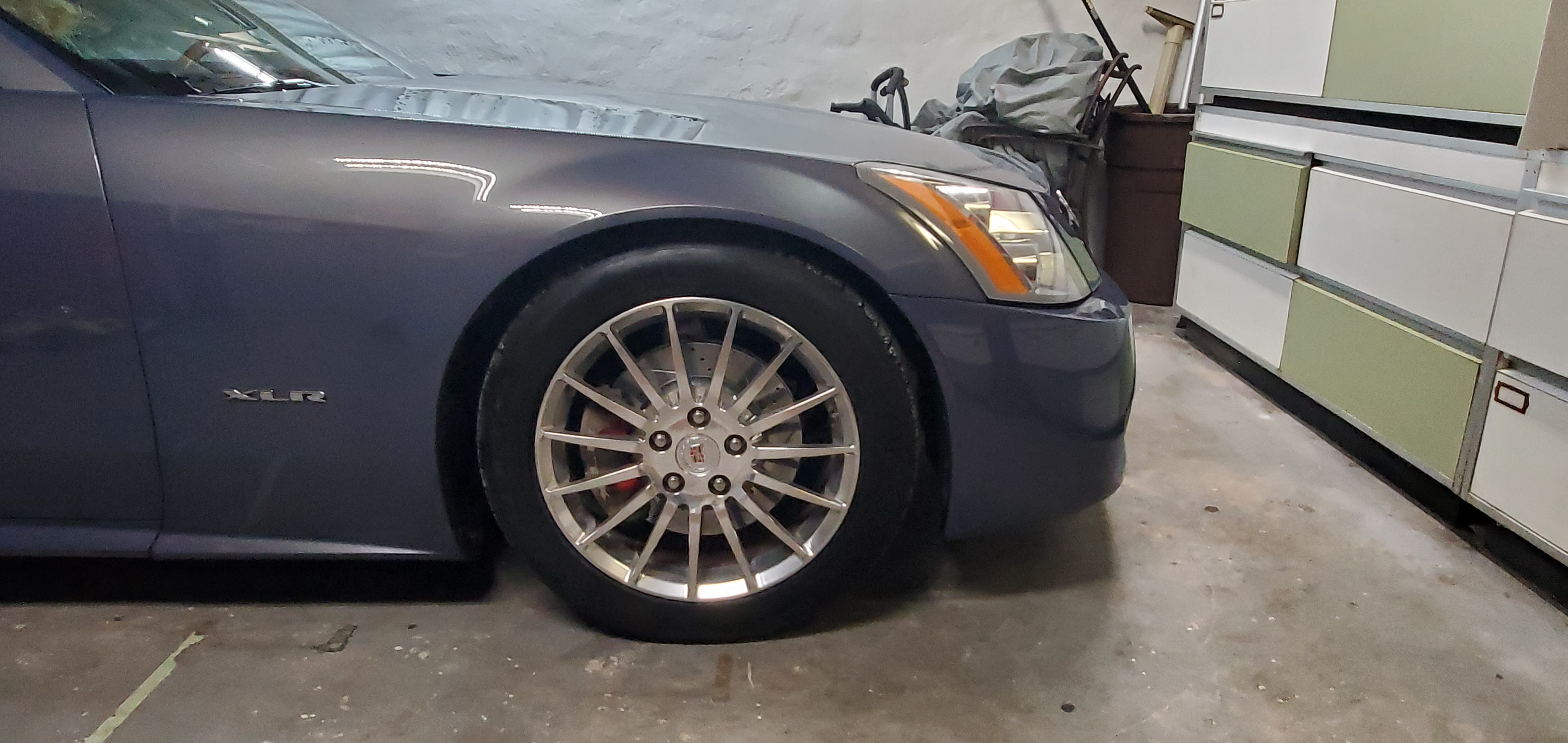

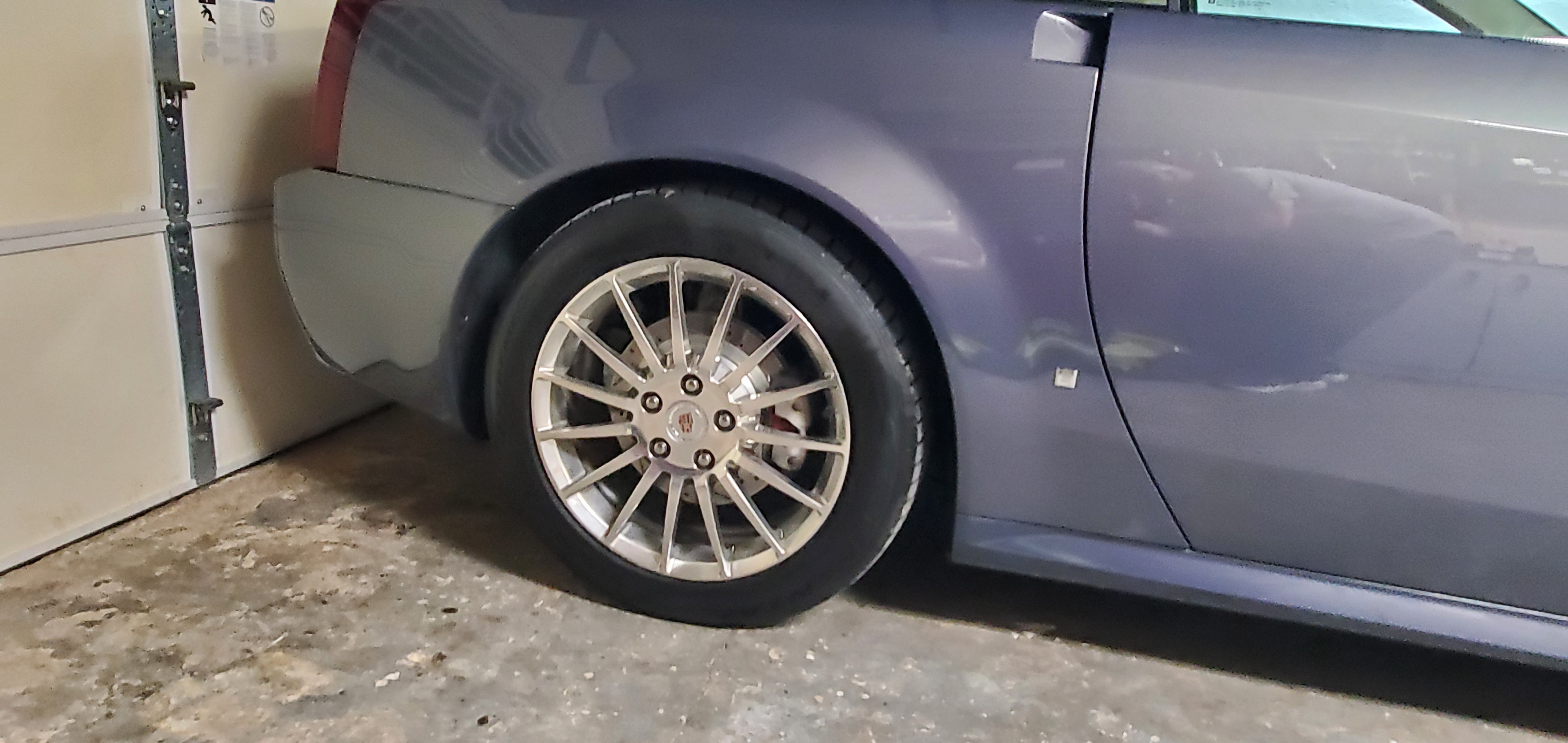

Hi all, I just got the Bilstein shocks done on my 07 xlr. Along with new brakes , rotors, and tires. Stock 18 inch wheels with CONTINENTAL EXTREMECONTACT DWS 06 PLUS, 235 50 18. I know this isn't going to be an exact measurement, but I feel like my ride height is off. Can anyone check their rim to fender measurements like in the pics I've loaded?
Mine are as follows
F driver 4 5/8
F pass. 4 7/8
R driver 5 7/8
R pass. 5 4/8
I did have new ride height adjustment bolts/pads installed a few years ago, so maybe only 10k since they were done, I think they should still be good. But maybe just need adjusting. I know I don't want to drop the ride too much because roads in PA suck and I don't like scraping anywhere. But I think they should all be closer to even. Perhaps slightly higher on the drivers side when the car is empty to compensate for when I get in it? Thx for a little feedback on your fender measurements.

Oh and do you think an alignment shop would adjust the ride height as part of an alignment? Should I get an alignment after doing the shocks? Especially if I get the height adjusted? Or do adjustments to the ride height bolts really not effect the alignment...
Ride height can change the camber a very small amount.the shocks wont change the alignment unless you mixed up the washers on the uupper control arms if you pulled them off. The shocks being new may hold your car higher a 1/16 -1/8 inch but drive it and they will settle. Theone concern would be if you had the suspension off the ground on the rear and you tightened the lower bolt. That one needs to be tightnen with the car on the ground or the weight of the rear on jackstands out near the rotors. It can hold the rear higher. The photos look close. Ill look for the factory specs and send them to you
I like those wheels. to me the spacing is equal on both the fenders looks good.
Yes gonna drive it a month and recheck. Was done at a Corvette custom restoration, specialist shop. County Corvette , in West Chester PA . They don't mind working on the XLR. They are more picky than I am. Lol. I didn't measure this before. Just checking it now. I gotta detail the wheels after I break in the new pads. Summer is here😎
