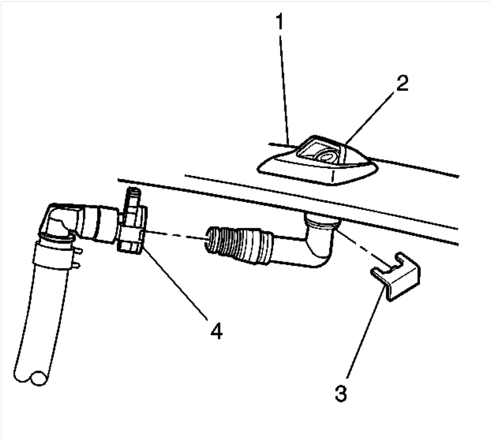

The headlamp washer hose consists of multiple sections (4), and slide-lock
connectors (5), from the pump to the headlamp washers (1). It may be
necessary to work underhood, or inside the front fascia to service the Tee
fitting (3), and hose clips (2). If it is necessary to access the washer solvent
container hose, refer to Washer Pump Replacement - Headlamp.

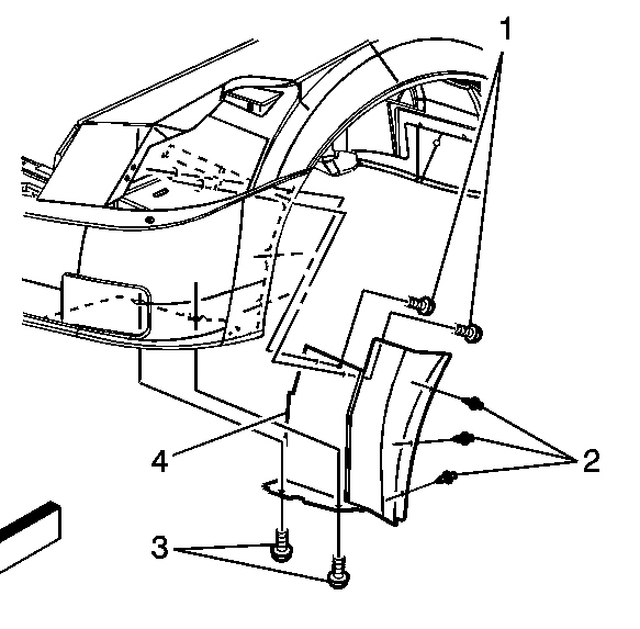

1. Remove the forward wheelhouse fasteners (1), (2), (3) and the splash shield (4) to access the underside of
the bumper cover.
IMPORTANT: Carefully grasp both fittings of the hose and elbow, to ensure the nozzle is not cracked during removal
2. Slide the hose lock connector (4) at the headlamp washer supply hose, and disconnect the coupling
Installation Procedure
1. Connect the headlamp washer supply hose to the headlamp washer. Slide the lock connector (4) to the
closed position.
2. Verify the operation of the washer. Inspect the washer for leaks.
is not cracked during installation.
