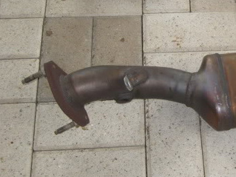

I'm installing the Magnaflow exhaust manifolds/cats and can't find the part number for these studs that go in the end of the manifold and have springs on them between the exhaust manifold and the intermediate exhaust pipe.
Any part numbers for the studs, the springs, and the nuts would be appreciated. Thanks!
Would you post a photo of the Magnaflow exhaust manifolds/cats? I'm sure everyone would like to see them! :)
They certainly aren't as nice and clean as the pictures. lol
So, there aren't springs in between these studs, just the studs.
