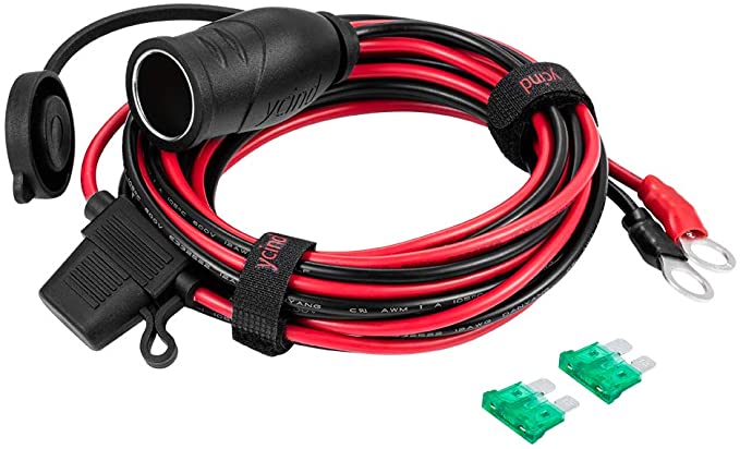

I purchased a Cobra JumPack XL H2O power pack on sale from ShopHQ along with a 6 foot female lighter socket battery boost cable from Amazon (see pictures).
Near the front of the car on the passenger side there is an opening just large enough to fish the eyelet terminals up through using a coat hanger. You may need to shine a light under the car to see the opening. Then run the wiring along the passenger side fender. I suggest wrapping the wiring in 1/4” protective wire wrap for a factory look. I used Velcro to secure the socket end to a bumper support.
I tested this setup and it works. It took about 10 minutes to slow charge a slightly depleted battery back to full charge.
