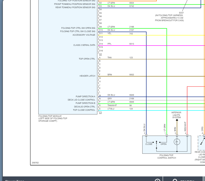

I have an 07 XLR and I'm having some issues with the top. I' searched here and other websites without much luck. My 07 has been sitting since June 2021 with a battery tender on it. I went to get it out of the garage and the battery tender had died. So, I jump started the car, put the top down, replaced the battery, installed a new tender, and had PA inspection/emissions done. Now I cant get the top up. I have initialized/relearned the power windows. I have 12v coming from each switch output at the convertible top module. With my scan tool, I can see the module is getting the switch output to lower the top, but not to raise it. If I supply 12v to D10 at the module, the top module does not recognize it. If I I supply 12v to D9, it does recognize it. I have replaced the top control module. I have no codes stored in any modules in the car. There is no messages about the top in the DIC. I'm attaching part of the diagram I'm using. Any help is appreciated.

The fluid level is ok. Pushing the button to lower raise the top does nothing. The pump doesn't run at all. The module is not showing that it's getting a signal from the switch, even though it is.

You need a candi module with your GM Tech 2 to communicate
