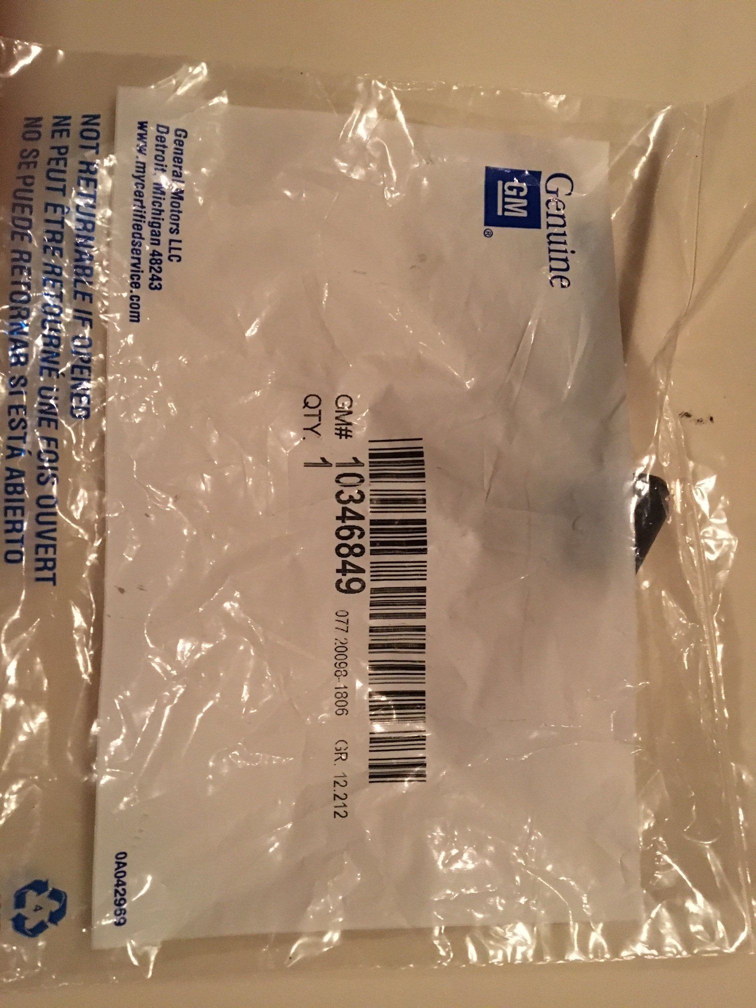

I have 4 of the trunk bumpers--GM part #10346849 in the original bags. Will sell for $50.00. Will ship them USPS priority mail. Email ssfarms1@hotmail.com
