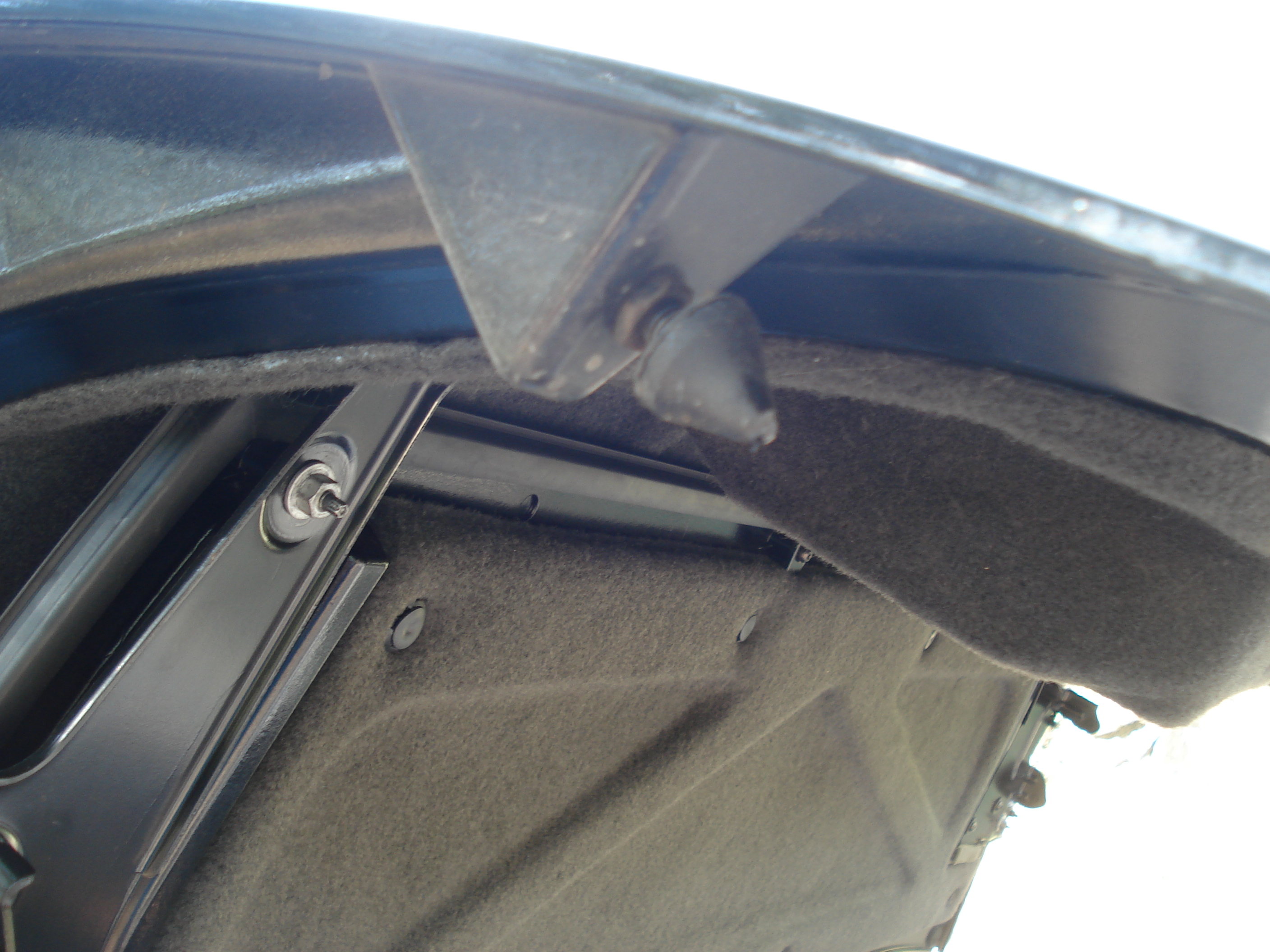

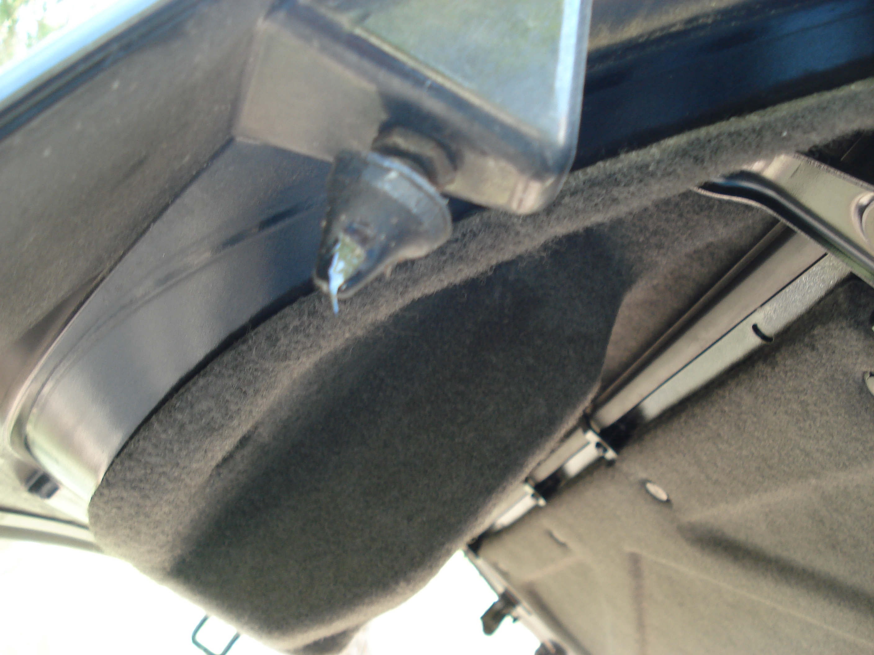

I don't know what these trunk nipples are called....
they are both very soft and sticky... (see pictures)
They stick to the fingers so not ideal when they are in their notches when the trunk is closed

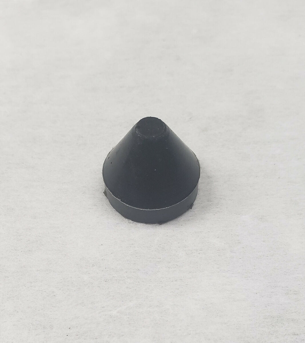

No longer available. One guy makes some on eBay but they are soft and some like myself have said they pull off since they are not bonded to the bolt but rather slip over it. Still better than the factory goo ones

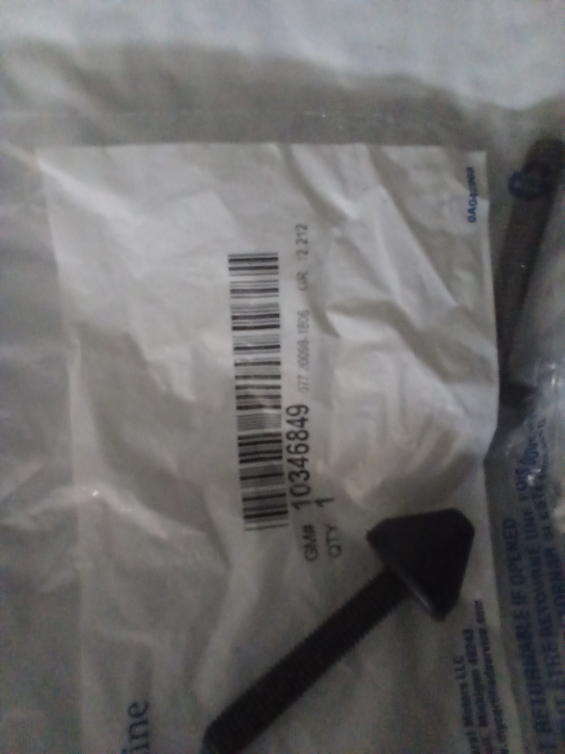

Part number is 10346849. There might be some over your way.

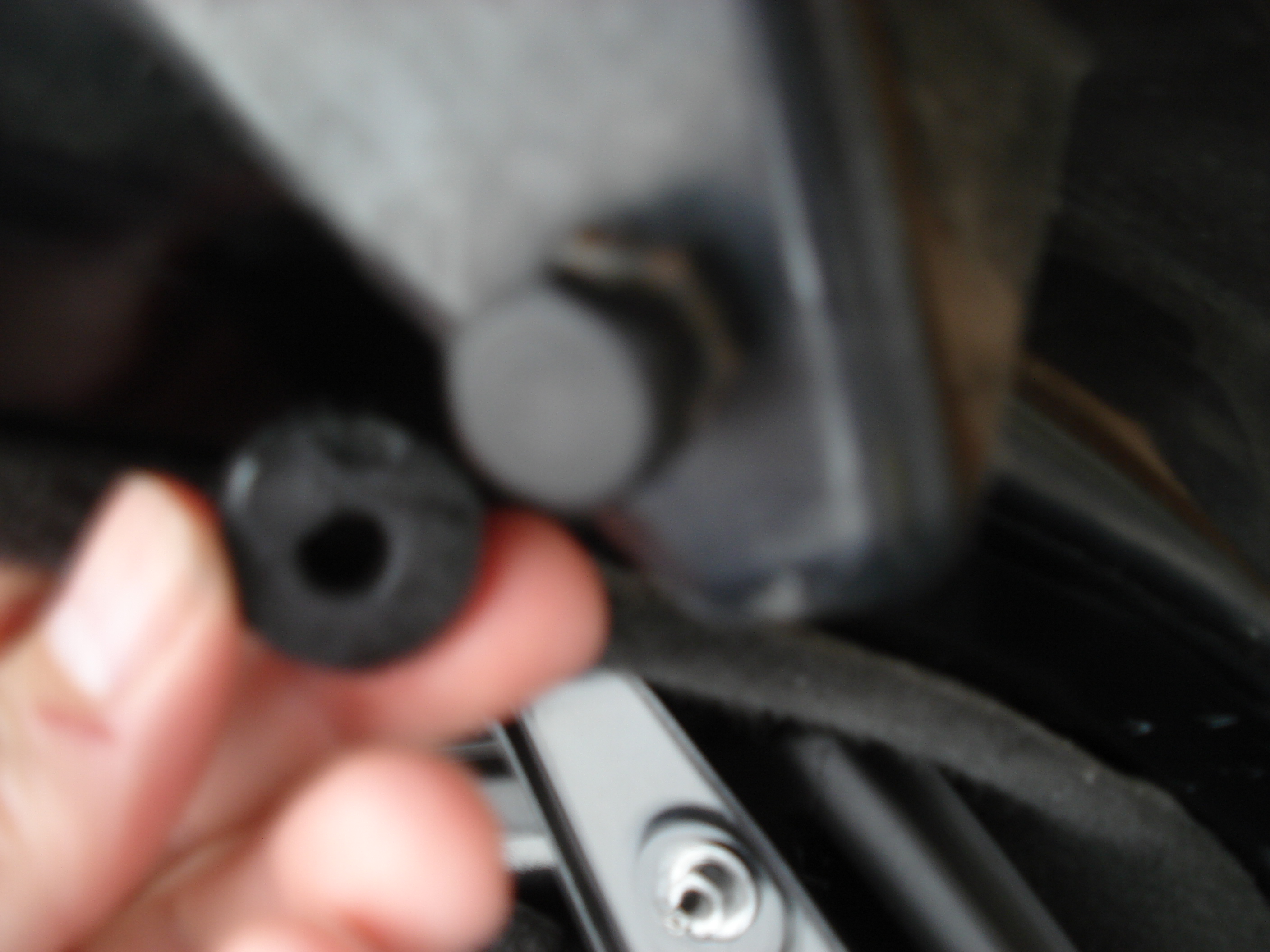

I received the trunk bumpers but not like the photo, they are just the rubber ones... the hole is very small to put it on the bulo; do we have to heat it to put me on?
Follow the instructions and remove the old rubber from the bolt. Do not remove the bolt. The opening is designed to stretch and slip onto the bolt head snugly. Do not apply heat.
ok - I insisted by starting by pinching it and turning slightly; No problem ! - Thanks for your return ! :)
