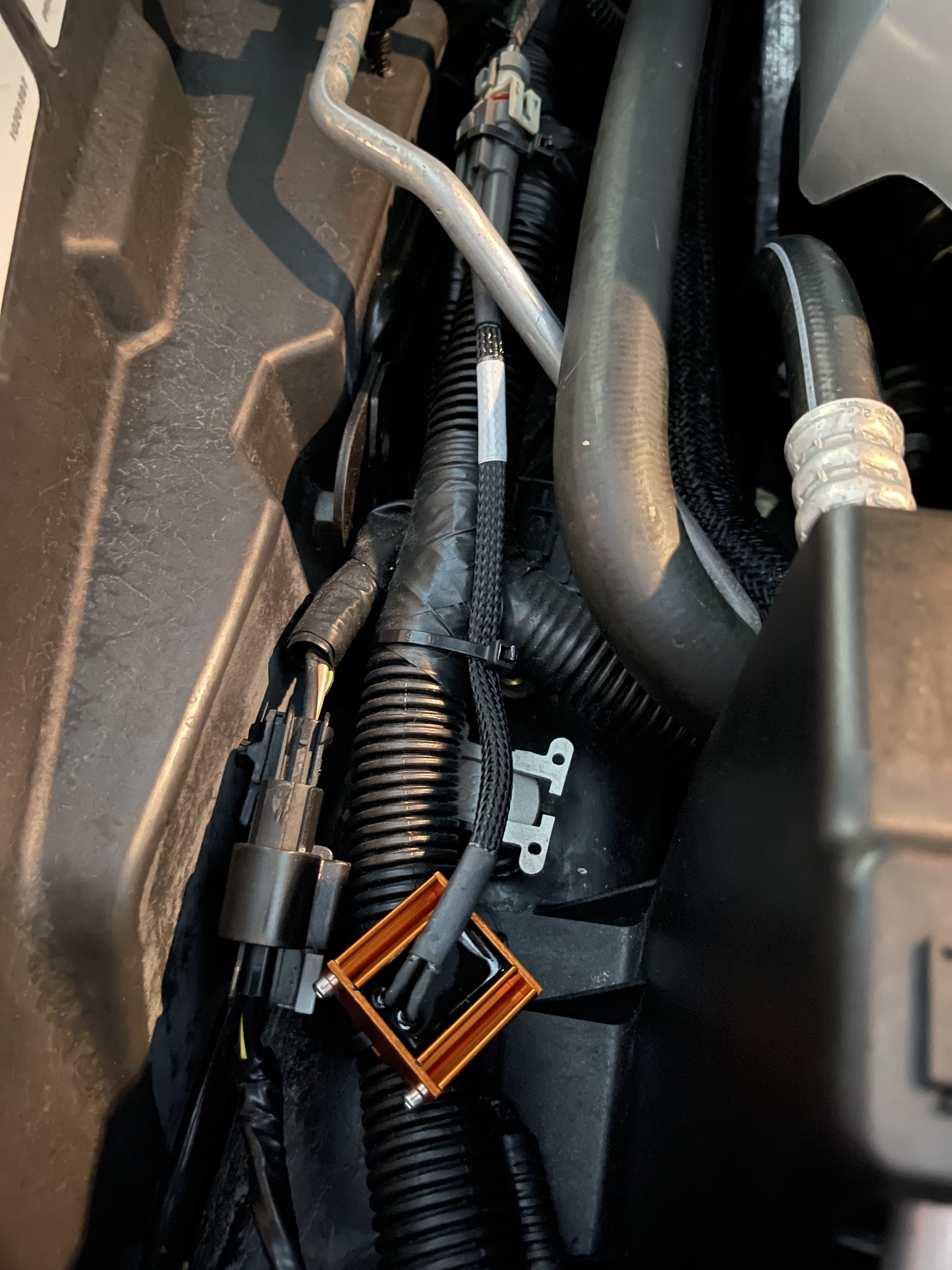

here is the user manual of the AFE and the installation at the front right. some manuals say to cut a blue cable but not on the casper received? thank you to enlighten me
