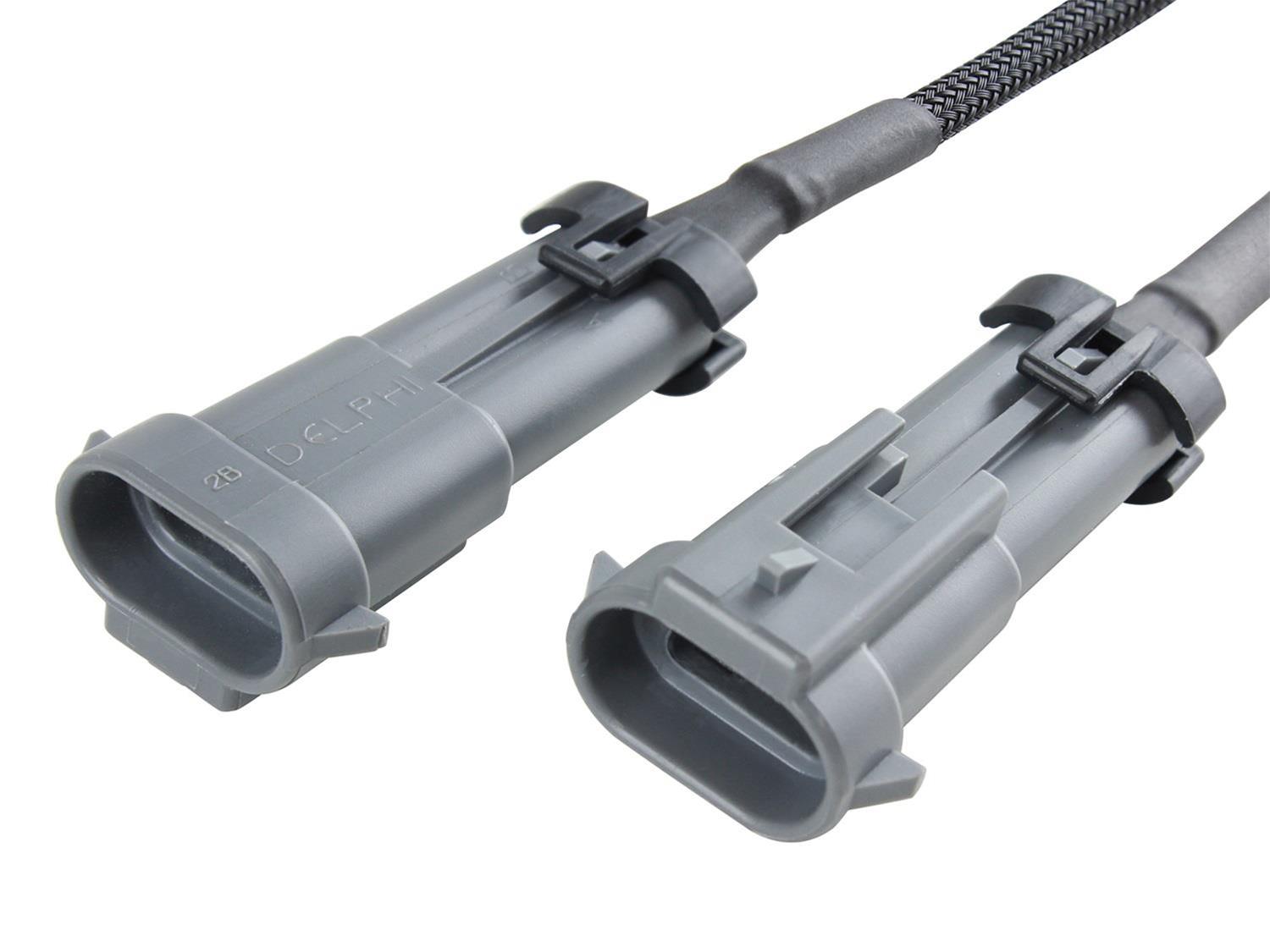

Great thread. However I have a potential problem. Ordered the simulators from Casper's. Lacking sufficient courage, I am having the modification done by a really good Corvette shop. Received a call that the Casper connector has a tab that doesn't allow it to go right into the XLR connector. Did you have to trim it to fit or was it an exact fit? THANKS!
Same thing happened to me TWICE, finally just gave up got them soldered in but after that if worked great and yes it's a 2005 XLR, just hit 41,000 miles
this repair works fine if you are just replacing your shocks and the module has not been water soaked. This replacement works on all years and the proper part number casper simulators are a direct fit .they just require a zip tie to hold them together better. This will not fix the car if your 04/05 module has been wet and the service ride control light it on. One person claims that it fixed a wet module but 50 have done it and know it usually leaves the 80 mph light on.
The little tab does not prevent them from plugging in together it just does not snap and lock them together . A simple zip tie is all that is needed

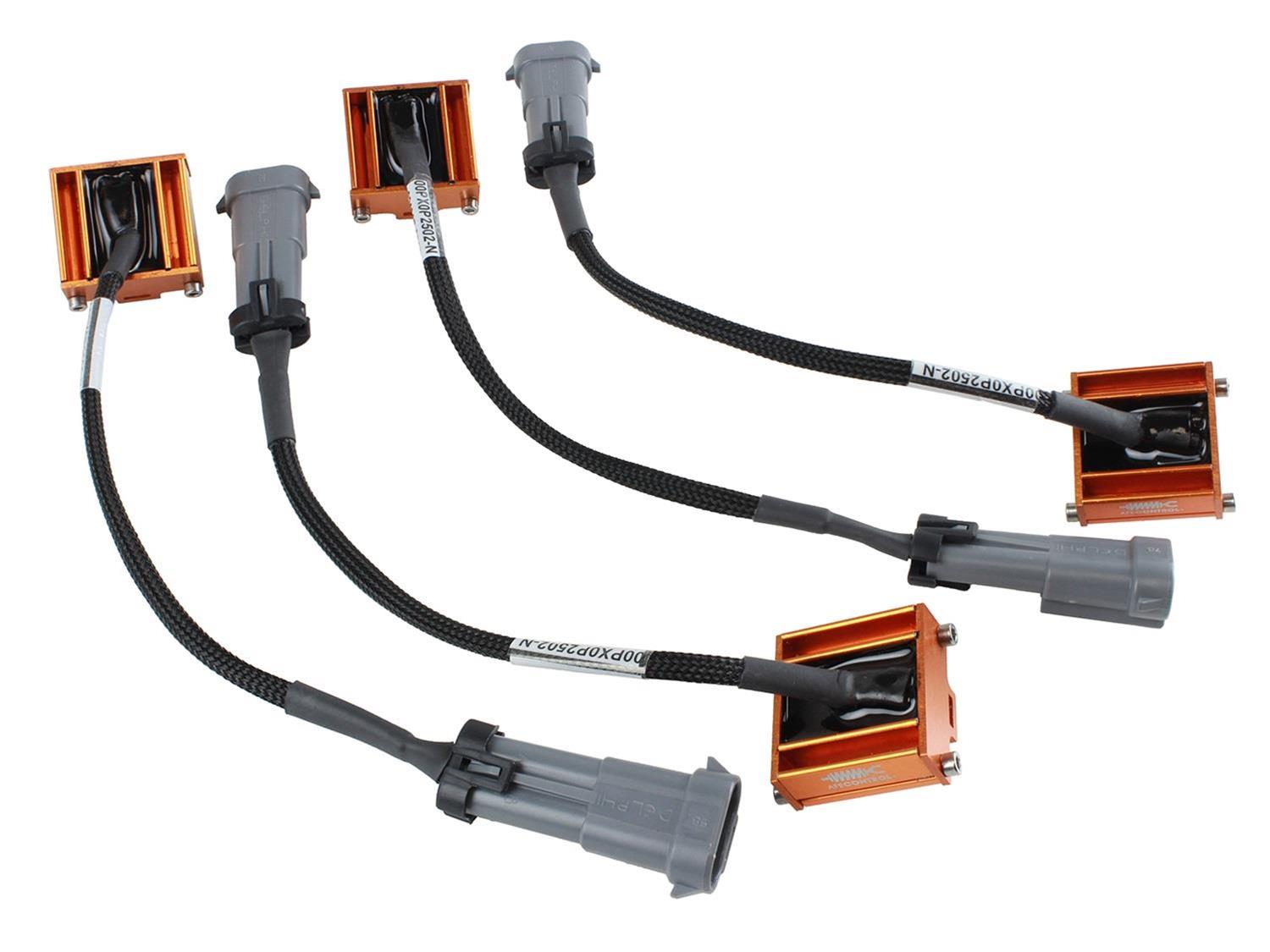

Wanting to have a firmer and above all better damped car, I ordered Bilstein B6 shock absorbers with Casper 106096 simulators.
Installation done without problems and perfect first road test. The next day a short walk and message "check adjustable suspension system" after 2 resets, a message indicating "maximum speed 139 km/h".
Control of the simulators, new test but nothing the messages come back. (I had no module problems before).
I have since ordered new simulators from SUMMIT: AFE-436-401001-N
Suspension Sensor Eliminators, GM Gen 2, Electronic Shock Delete.
do you think i will recover the no throttling message.
