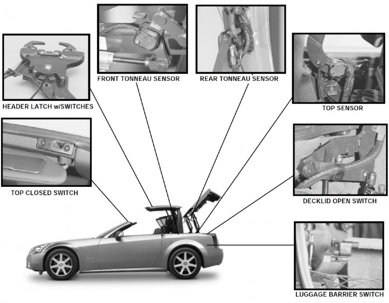

There are many switches and sensors for the retractable top, if one of those fail or has bad ground or not in place like te luggage barrier in the trunk, the module will not send the sinal for the operations of the top.
I have seen often that the deck lid open switch at its hinge could be defective, check it out, if the click sound happens it means that it is OK,do the same for the other lid switches.
As far for the sensors I suggest to visit the site of TopHydraulic, a video was done for that perticular problem, you could get the answert to your problem.

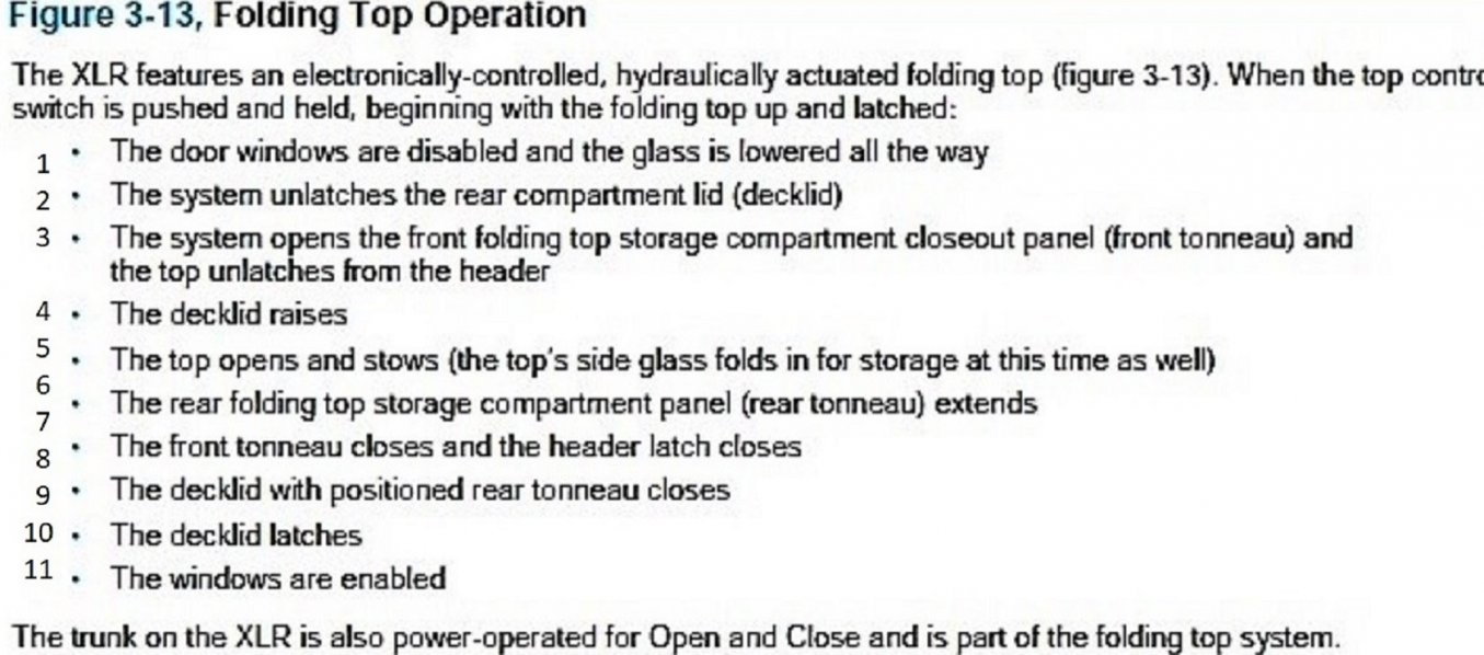

Enclosed are photos and a diagram that explain the top operations.

I thought it may be the trunk lid deck switch but the windows don't go down as the start of the sequence.
