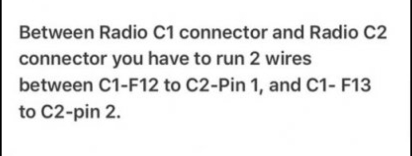

I followed your directions from your thread. The system sounded great until I sat back in the driver's side this morning ugh. The left side has sound but is weaker with less output.
When jumpering between Radio C1 and Cd changer C2 what type of connector is used?
Thanks for the input :)
