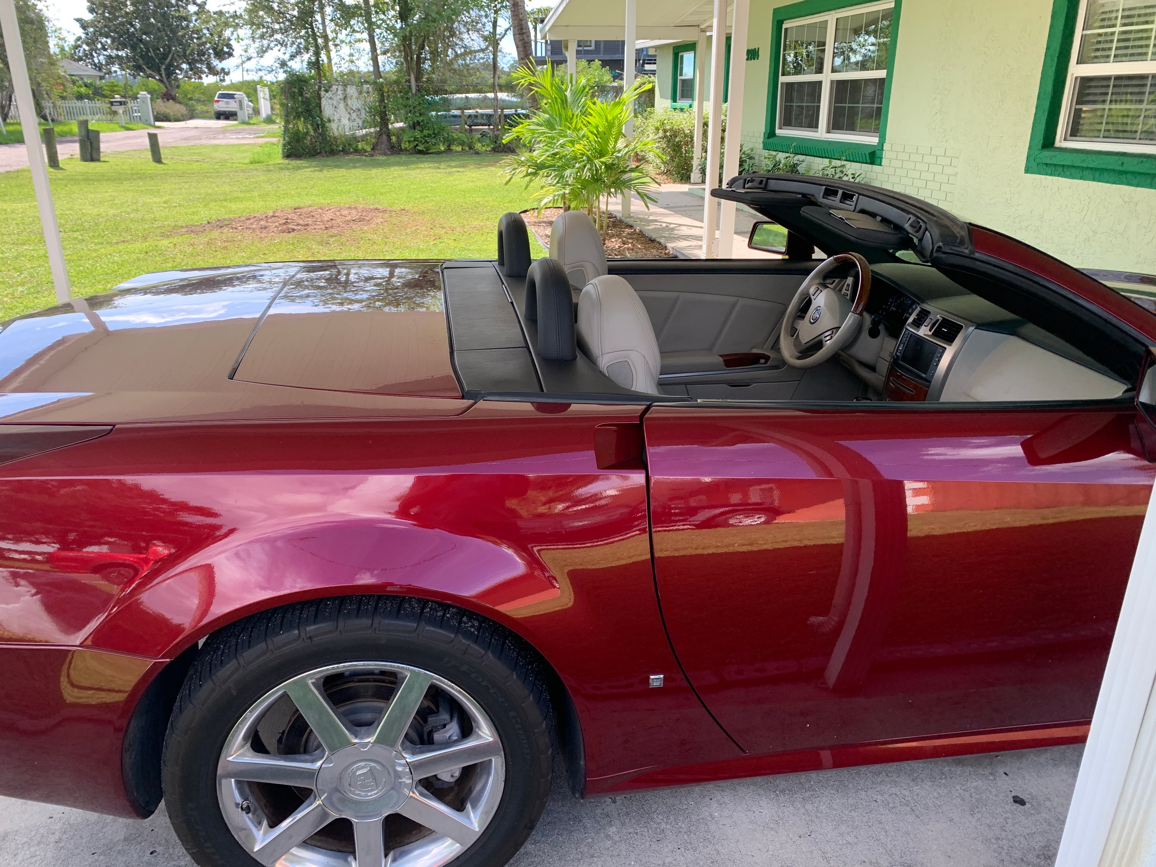

I have been posting in the new member thread, time to move on. I recently purchased a very nice Infrared 2006 XLR, but the top did not work. Previous owner said it need the hydraulic pump replaced. He had it laying in the trunk. So I replaced the pump (Top Hydraulics) Still no top function, but the trunk did open and close. I bit the bullet and purchased a Vertronix Tech 2 clone. (OBD2sales.com) After a top relearn, (Thanks "Rexster314" for posting the process, it would have taken me hours to find it) I was thrilled when the top went down. Very short lived, as the top would not go back up. I had to raise it manually. I had some lengthy conversations with member "Mickeytee" very helpful and informative. Thanks SO much!! I started over with the Tech2. Cleared all the codes from the top module, and did another Top Relearn. I am happy to report that the top is working perfectly now. I went thru the up-down sequence about 5 times and all is good. Now I can move on to the other small items that need attention. TPMS, Hood Stuts, CD Player, etc.
