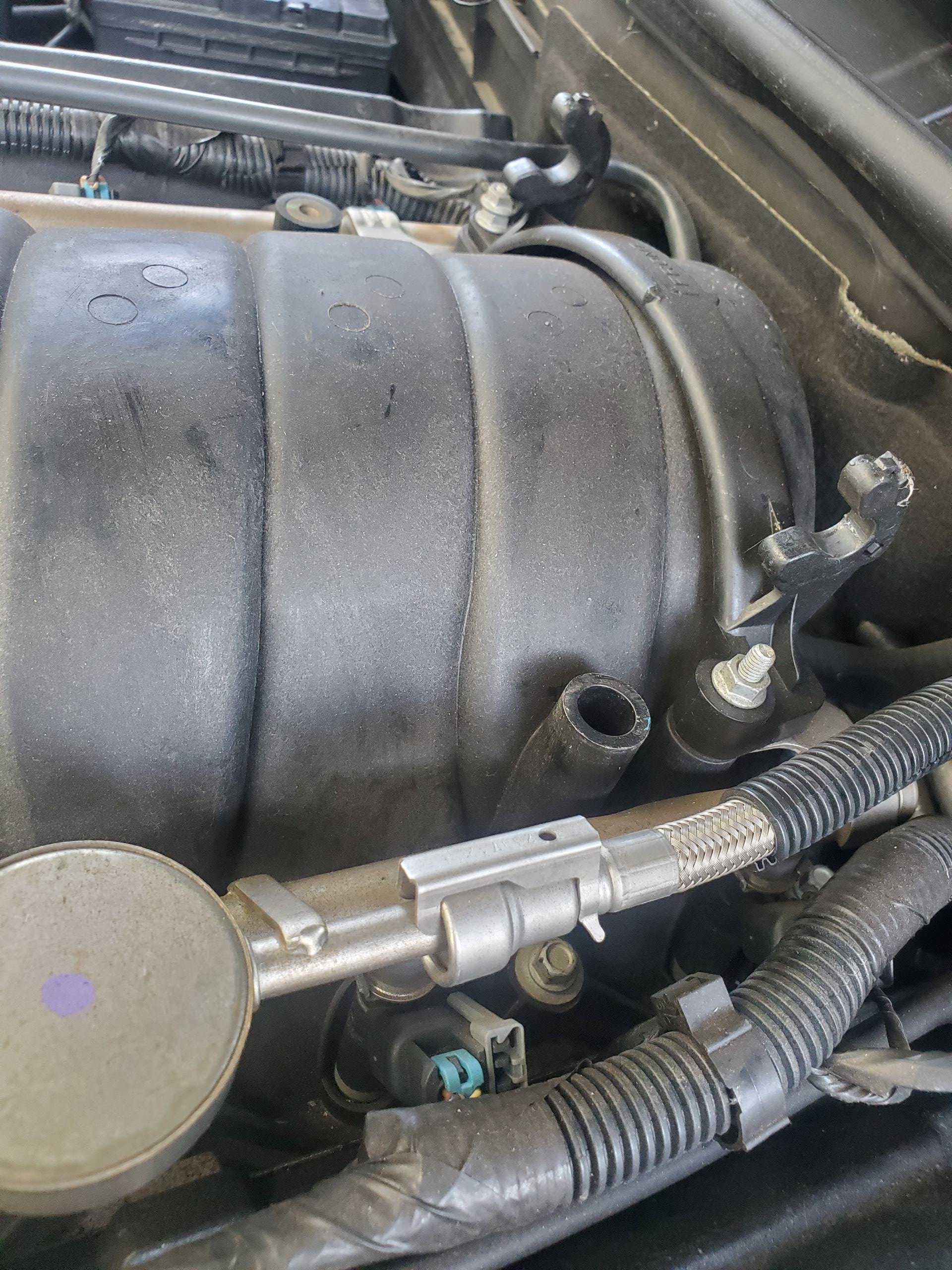

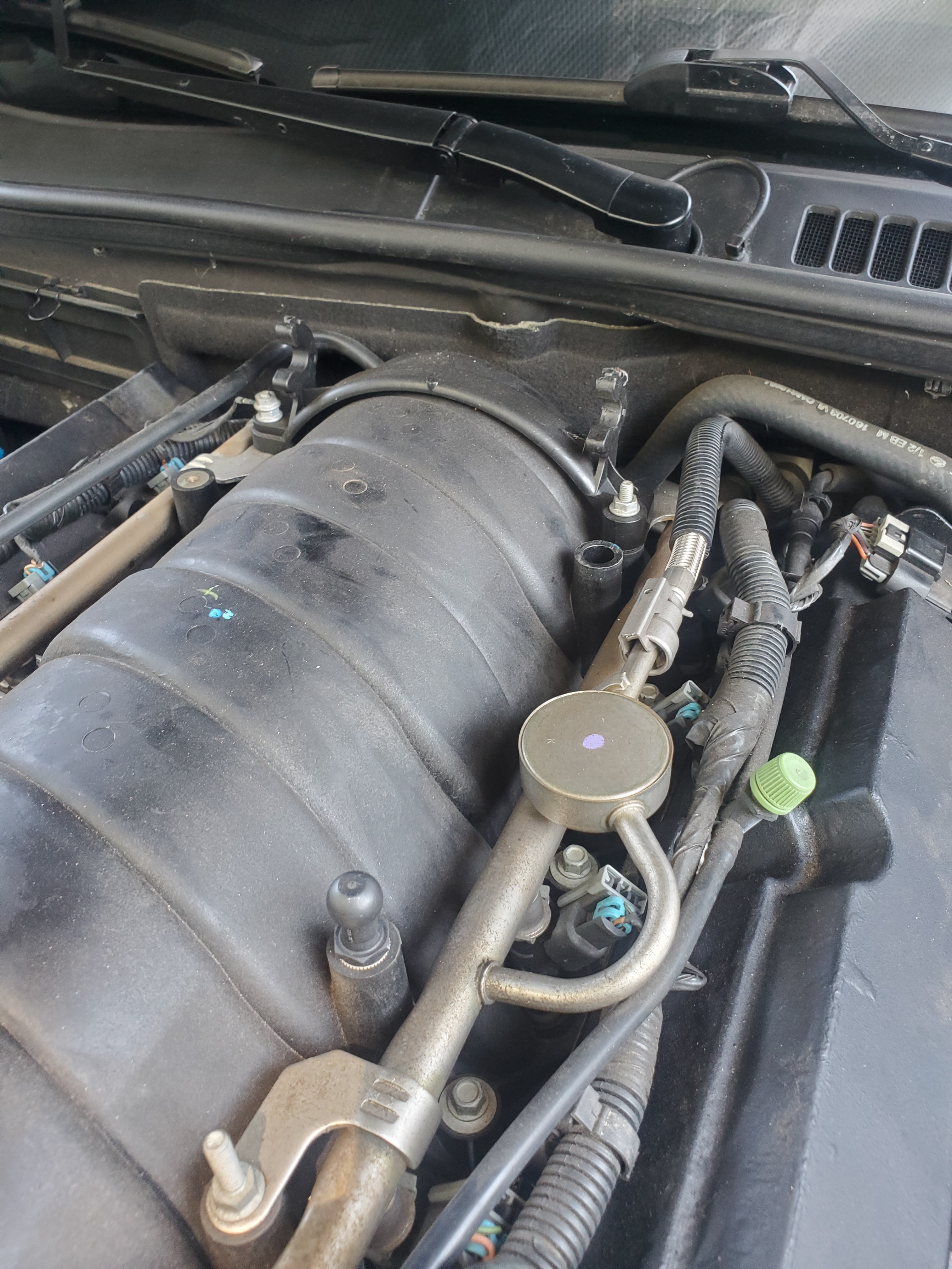

Question ......standing in the front of the car looking at engine about 3/4 of the way back on bank1 there is what looks a pipe sticking up with no plug or hose .......i am sure it have something attached or plugged
Sounds like PCV.
Conventional induction (I can't speak for SC).
On the right bank (your left when you are looking from the front), there is a hose which goes to #8's induction (at the back on your right, driver's side). If this is missing, you will get a serious vacuum leak into #8.
On the left bank, (your right), there is a similar hose which comes forward.

I am thinking something should go on this
Ah. No, I don't think so, nothing that matters too much. That looks like part of the clip mechanism for the engine cover. There is another one further forward in your picture, with the ball head on it. Check the underside of the cover and see if it lines up.

That big black plastic balls are the engine cover retainers. The 2 small metal ones in the valve cover on passengers side are for the sts engine cover. The sts 4.6 has them on both valve covers
