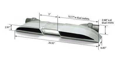

Was looking for some cheaper alternatives and stumbled across this exhaust made by SLP
www.slponline.com/view_product_site.asp?P=31076A&BIG=31076A-1
It's only $699 (1/2 the price of the Corsa!), and has a very cool, custom-looking tip. I looked the measurements to see if it would fit- and it seems like it should. However, I e-mailed SLP, and they couldn't confirm that it will fit on a 2005 XLR.
What's cool is you can purchase just the tip for $299:
www.slponline.com/view_product_site.asp?P=310305063&BIG=310305063-1
Aside from buying the Corsa, Magnaflow, etc....are there cheaper ways to make the car louder (without the drone) and still pass CA emissions?
I'm sure you "get what you pay for", but just curious as to what other options are out there.

I sat down with SLP marketing director a couple weeks ago and actually got to inspect some of their exhaust systems/components. (I was looking at purchasing this exhaust tip:
My conclusions - cast aluminum isn't nearly as durable as stainless steel; it doesn't polish as well; my EGTs will blue these tips quickly and no amount of polish will restore them; lastly, SLP systems are axle-back only, as opposed to the Corsa's Cat-back system.

Just to add my two cents on the matter. Slp is a great performance brand for GM cars. I saw this tip when I was doing my exhaust and the only problem is the inlet are pointed in the wrong direction which will give the exhaust to many sharp bends which arn't good for flow. I had hooker super comps. On two of my cars and loved it. I researched the noise level comparison and magna, Corsa, flow master all had higher readings through out the rpm range. I purchased the mufflers then I took the stock 2 1/2 h pipe which is large enough for a 4.6 and had ceramic coated which keeps the heat in the pipe and it allows the exhaust gases to flow better then I took the axle pipe cut the old muffs off welded my new ones then had them also ceramic coated. Everything is a chrome silver color and will never peel crack or loose color. The problem I see with thecorsa and other stainless models is their stainless which holds heat like 3-4 times longer than steel. That's no good. My car doesn't have any droning and have had multiple comments on how she sounds and there from car fanatics. I think people follow the masses and are misinformed ALOT but to each his own.<a href="http://s1246.photobucket.com/albums/gg620/topila/?action=view&current=null-1.jpg" target="_blank"><img src="http://i1246.photobucket.com/albums/gg620/topila/null-1.jpg" border="0" alt="Photobucket Pictures, Images and Photos" /></a><a href="http://s1246.photobucket.com/albums/gg620/topila/?action=view&current=null.jpg" target="_blank"><img src="http://i1246.photobucket.com/albums/gg620/topila/null.jpg" border="0" alt="Photobucket Pictures, Images and Photos" /></a>

GizmoQ - wow, I LOVE the exhaust tip photo you posted. Looks very close to the 2009 XLR tip. Is it currently for sale or just a prototype? Will it fit 2004-2008 XLRs? I'm not so concerned if it's not super shiny and doesn't polish well. If my car had 540hp, I'd be more willing to spend ~$4200 on my exhaust too (or at least $1600 for the Corsa)

Just to add my two cents on the matter. SLP is a great performance brand for GM cars. I saw this tip when I was doing my exhaust and the only problem is the inlet are pointed in the wrong direction which will give the exhaust to many sharp bends which arn't good for flow.
Can you say Hack Saw?? My autocross coach has these on her Z06, basically cut the tips straight across the back side and you're left with two gaping huge ovals, a little custom welding to the existing muffler pipe and Viola!
Yes they are still for sale. SLP Part #310325261 in their PDF Catalog, but its nowhere to be found on their online store, so I assume they have none in stock. Other online retailers have them listed for sale from $269 to 449, but whether they have them in stock is another matter. I've backed our cars up together to see how close a fit it would be and its close but the angle of the arc doesn't match our bumper.

Hmmmm.... "the angle of the arc doesn't match our bumper"....ok, sounds like the SLP tip is not worth it then- could look really bad.
