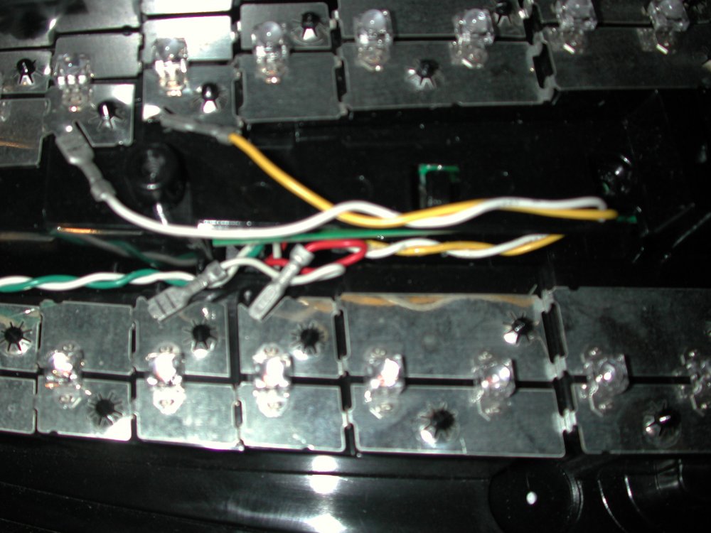

Give me you address and I will be glad to send you one that is already apart so you do not have to break the lens. You will see it is not soldered as you claim but is a pressed in LED. as you well know these are not made to be soldered. I can give you the contact info for the only manufacture of this bulb so you can explain your vast knowledge to him. I just got back from testifying in a 42Million dollar lawsuit in Texas for faulty repairs.. So I think I know a little about what I am saying, but you just go ahead and make those 3d lights. I will be the first to buy one. Oh and I have a good number of people that I have helped so It does not matter to me that you don't agree. :thumbsup:thumbsup:thumbsup OH and I don't think you ever followed up with an address for the scan program I have on the headlights. ? Its written in vxmodel and if you do not have the software already to read that and convert I will send you a trail edition. DSCN5387.jpg
for those who are reading and do not know what the bulbs look like. Here is a photo. You can see that the "simple" job of soldering is not simple because the bulbs are punched into the metal circuit board. The leds themselves have a special metal that resists solder and is made to prevent Galvanic destruction of the two metals that are not the same. So a new circuit board has to be fabricated if you want to use solder. Also you have to replace all the bulbs. When one dies it results in voltage change to the others and they will soon fail. But of course everyone knows that.
Again I state that Vettronic is very well versed in what he does and his price is very fair for the work involved. If you want to get set up to do the same repair there will be plenty of work in the future as Gm only required a bulb that would last 7-9 years and as we know that time is up. That is per the manufacture of the actual factory LED bulb. Not my opinion.
