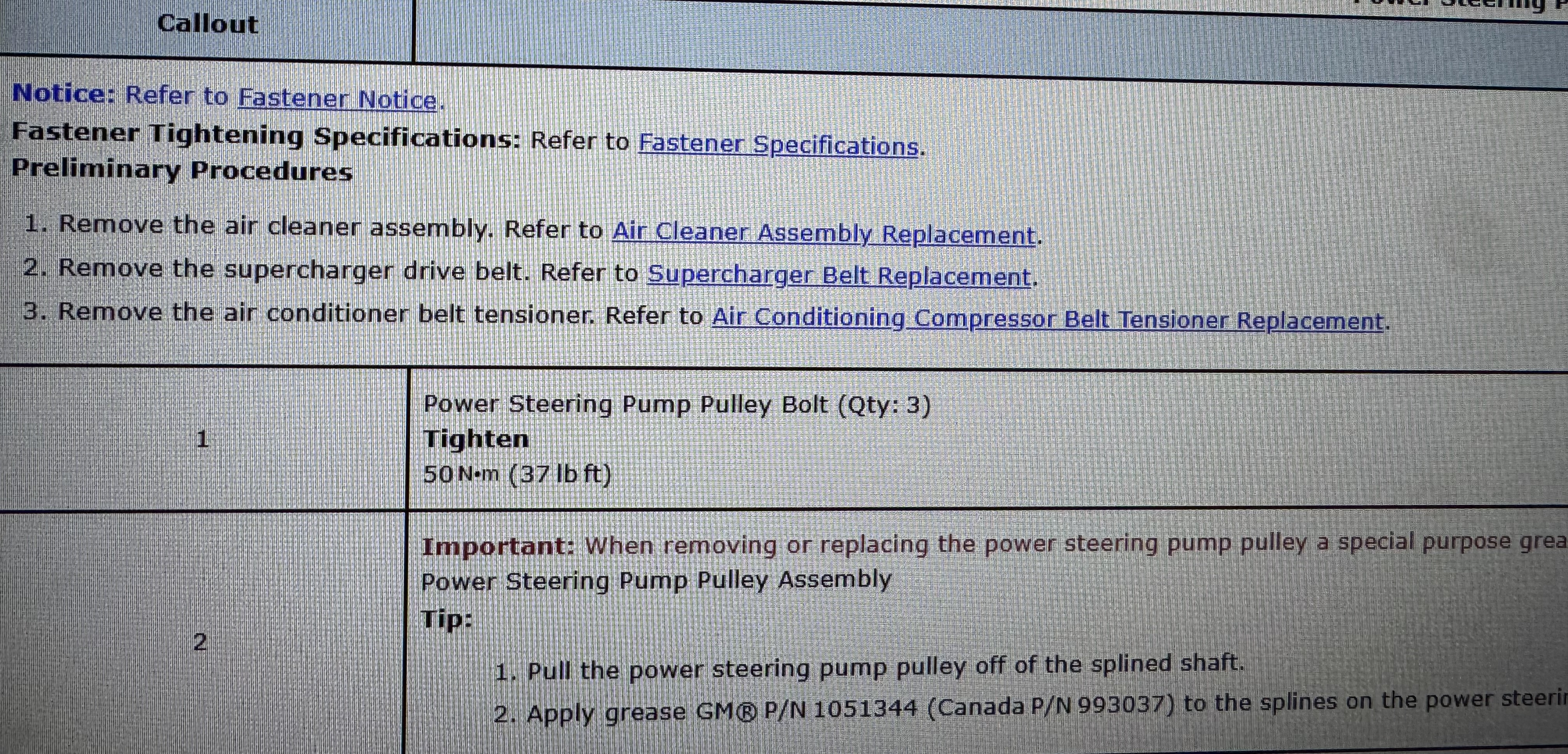

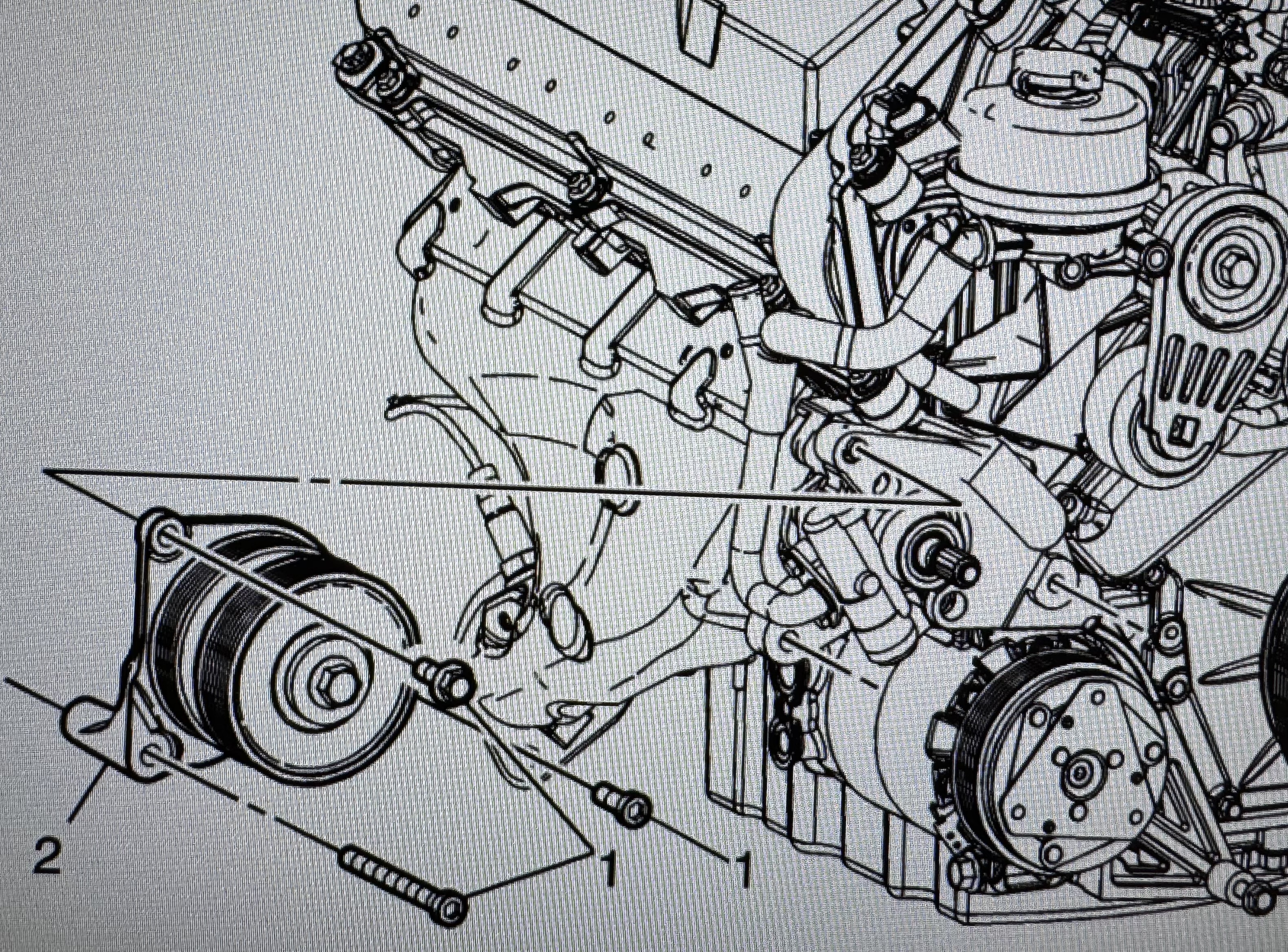

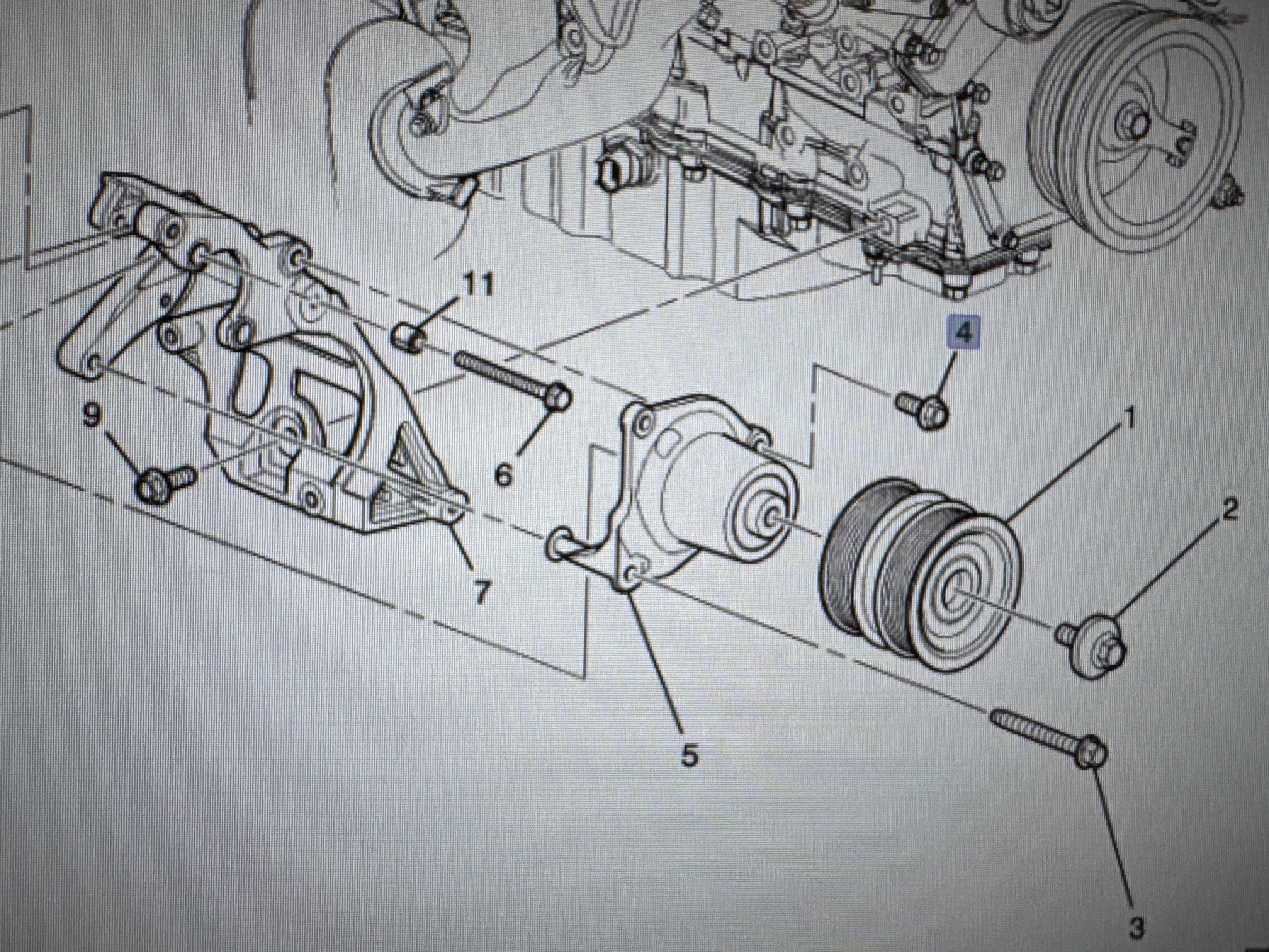

Adding for reference and future searchability, the doco I’m seeing. It appears to be LC3 specific.
parts catalog picture for reference too.

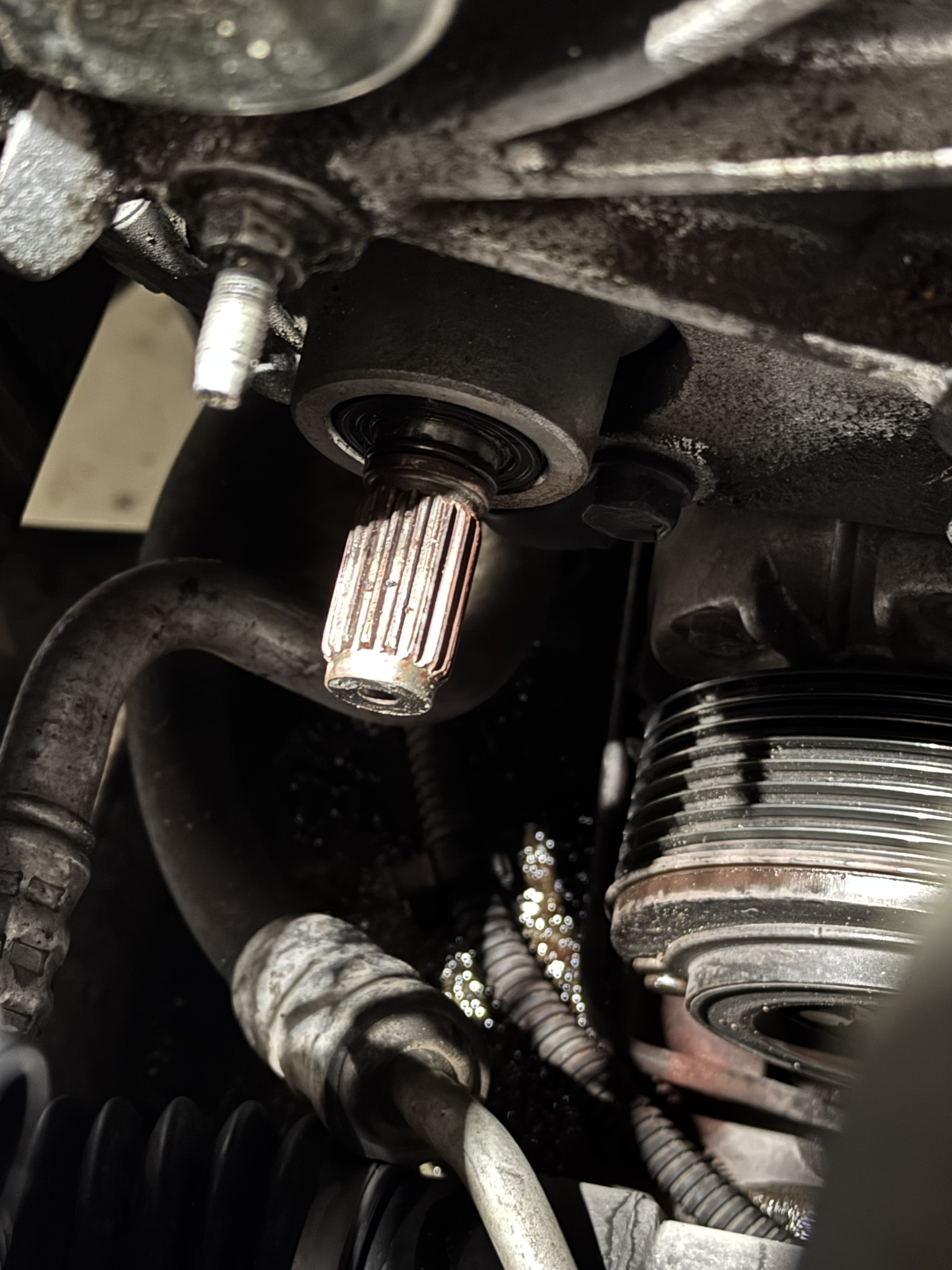

bolt got out, I move the ac line ever so slightly and the bolt came across the little bend in the line without interference. I don’t have clearance to bring it up the side of the engine, but currently thinking I’ll drain the PS fluid and remove the reservoir.
Here we go. Removing PS reservoir did the trick, those hoses are obnoxious to pull off.

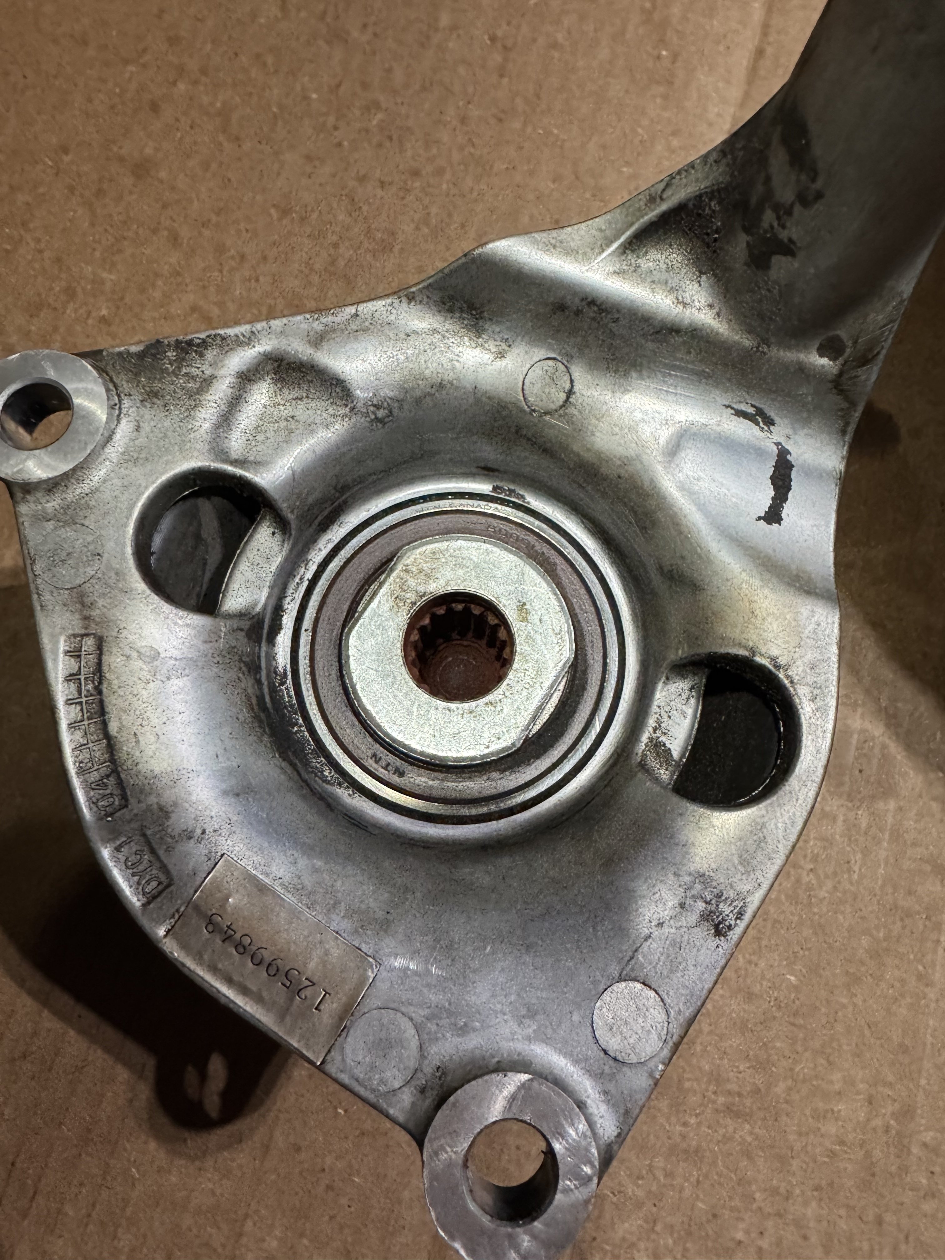

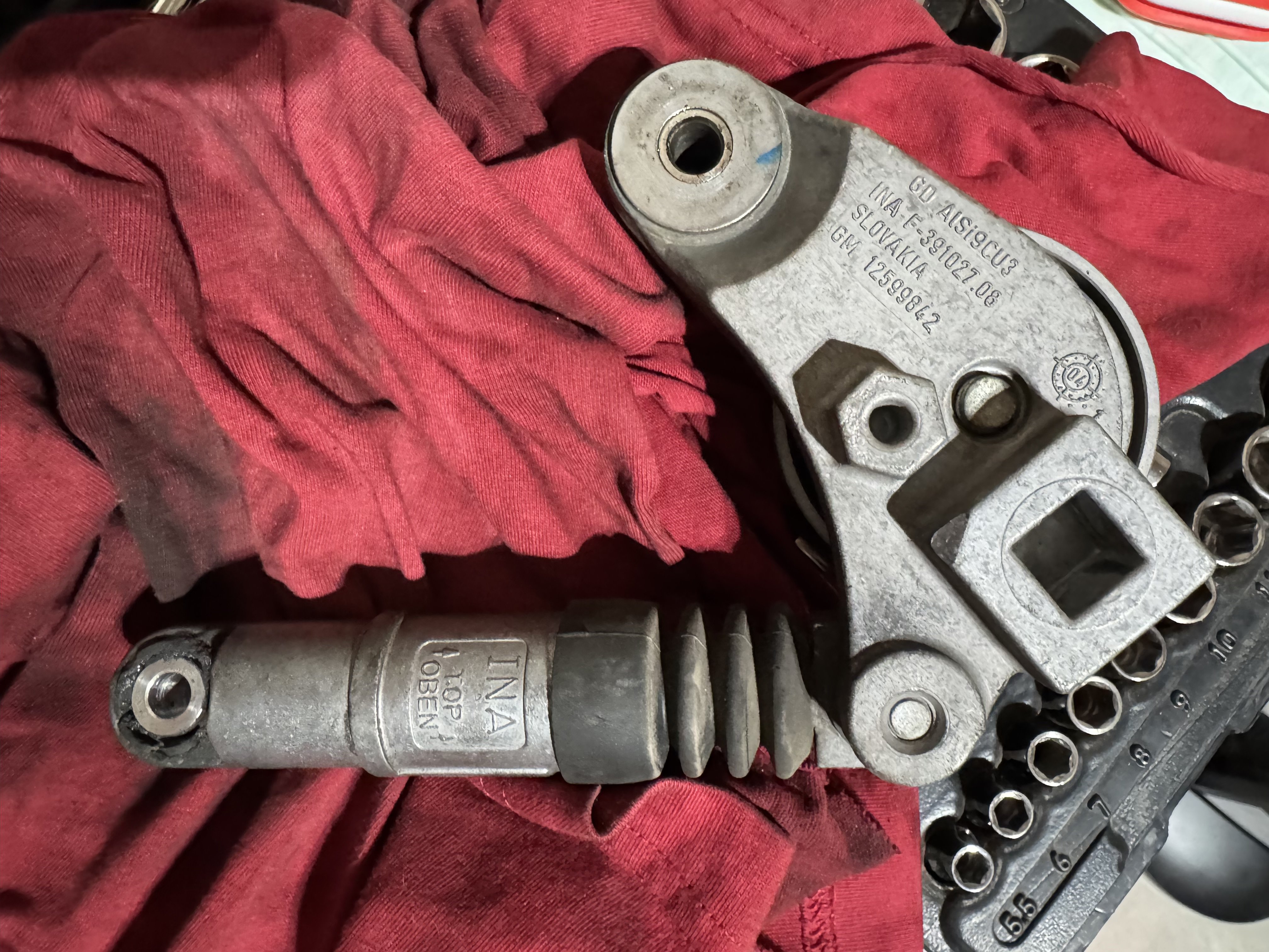

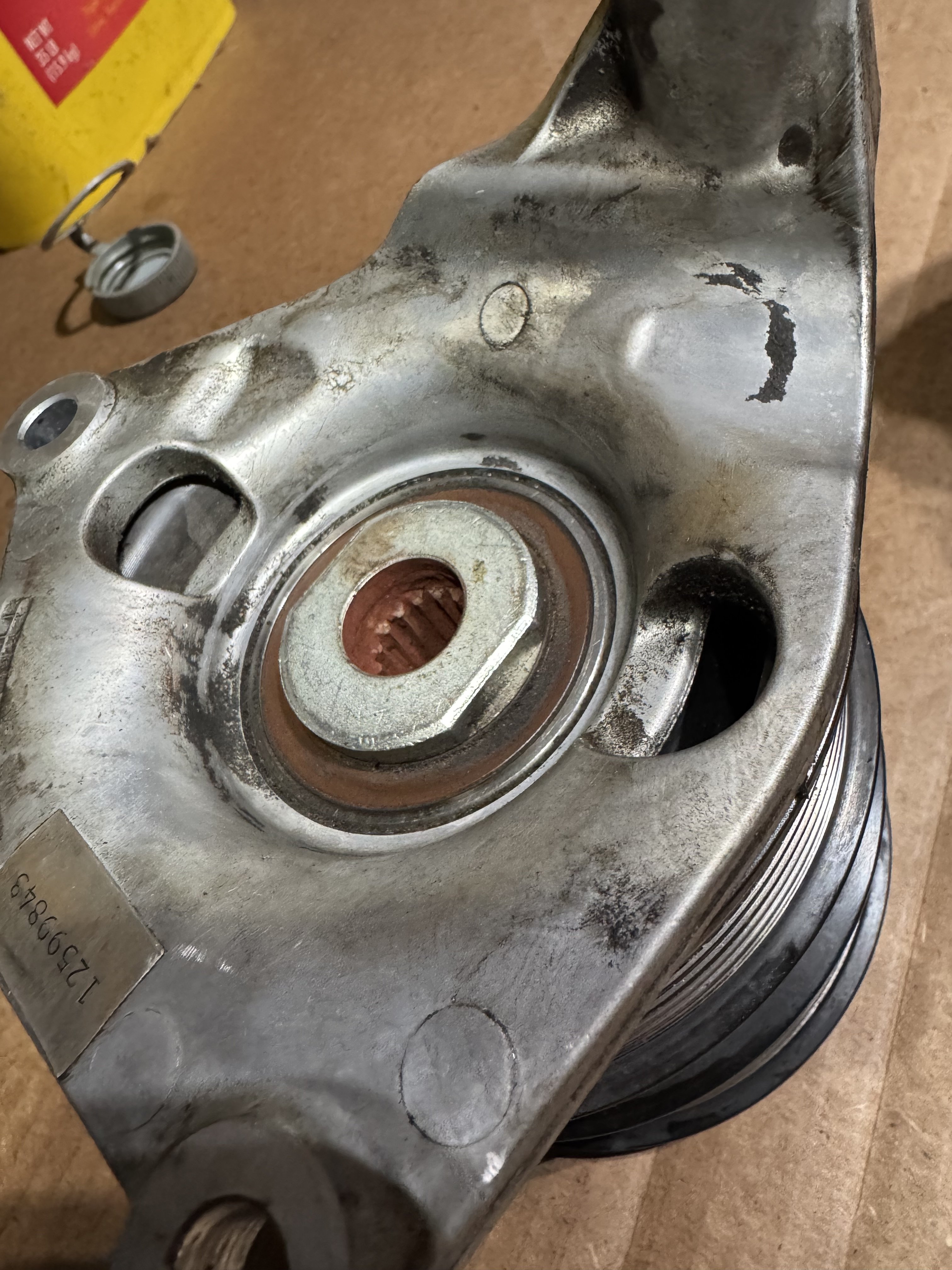

Pulley or tensioner look like they need attention?
Buttoning up this thread. Solution: removing the PS pulley required removal of the PS fluid reservoir. Putting back together was 50Nm for each of the 3 PS pulley bolts and 25Nm for the tensioner bolts.
