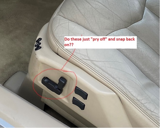

Wanting to verify if you can just "pry off" the two Seat control levers (fwd-back/tilt) with say a "door panel tool", so the cover can be taken off? I bought a new NOS GM cover and would like to replace it, but do not want to do something stupid like break the levers!

On my other topic, do those seat levers just "pry off"??

Peel paint would be good or if you are very crafty some wrap. I did one in just a target silver metallic a almost black but not. I thought the black just made all the detail go away. Several photos on line of the solid black. I personally cannot be live people are still buying those arcaic looking bar grilles from the 80's. To me that's the worse look out there but I guess if you needed a grille and the cost of a used one about the same you might try it. I used a lot of 09 grilles but now there are no more so I'm saving what I have left for actual 09 cars. Crazy the v style sell for 700-1000 when the show up. I have a couple but again if I ever need one foe a real v its worth more to keep it than sell it. Buttons pop off with a fair amount of force
