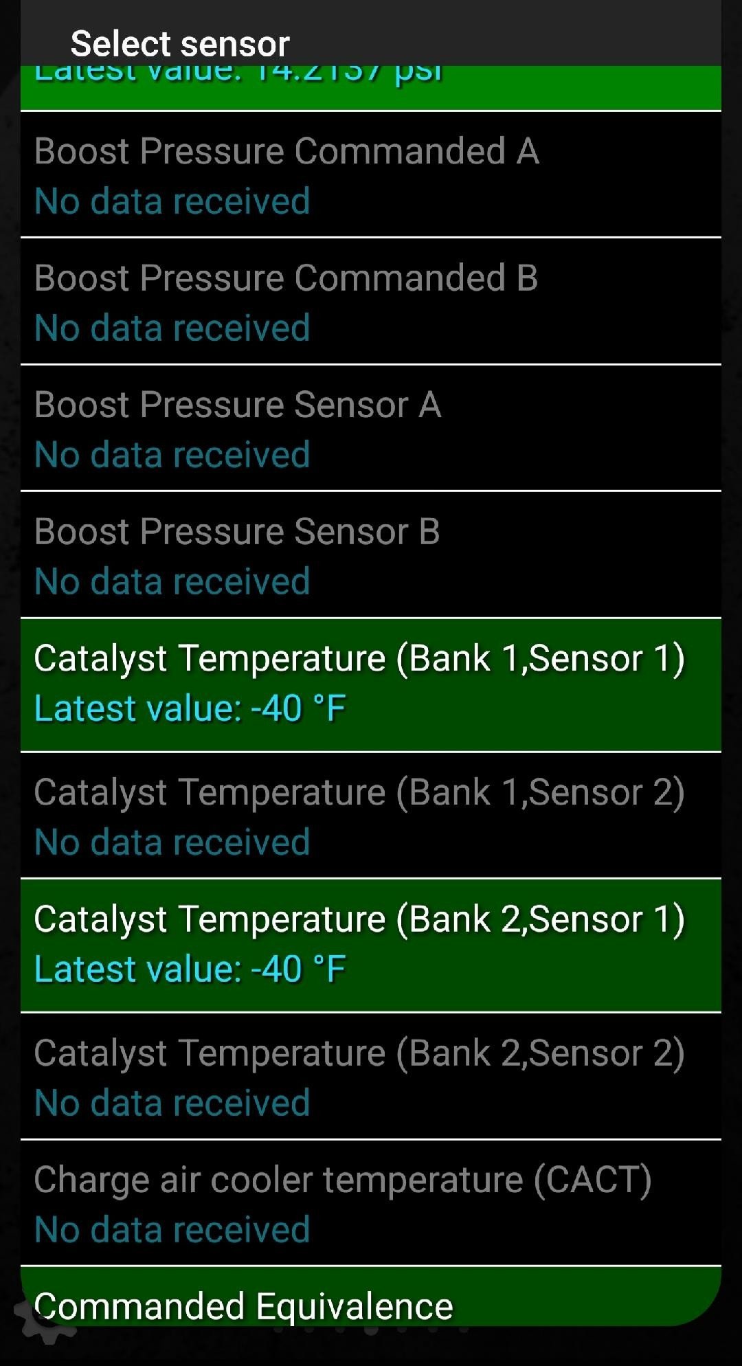

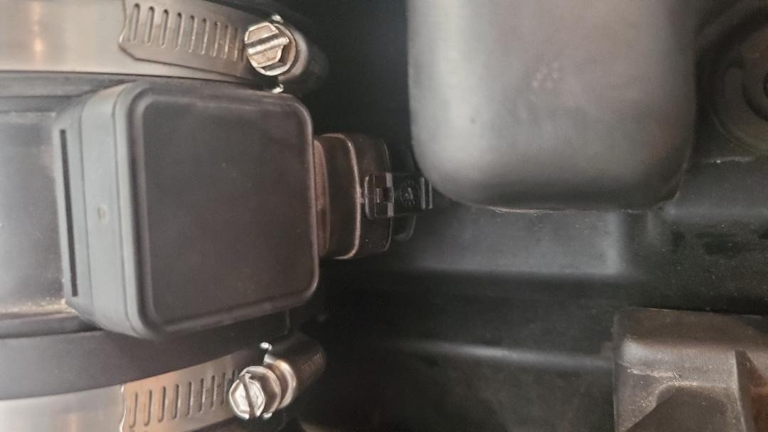

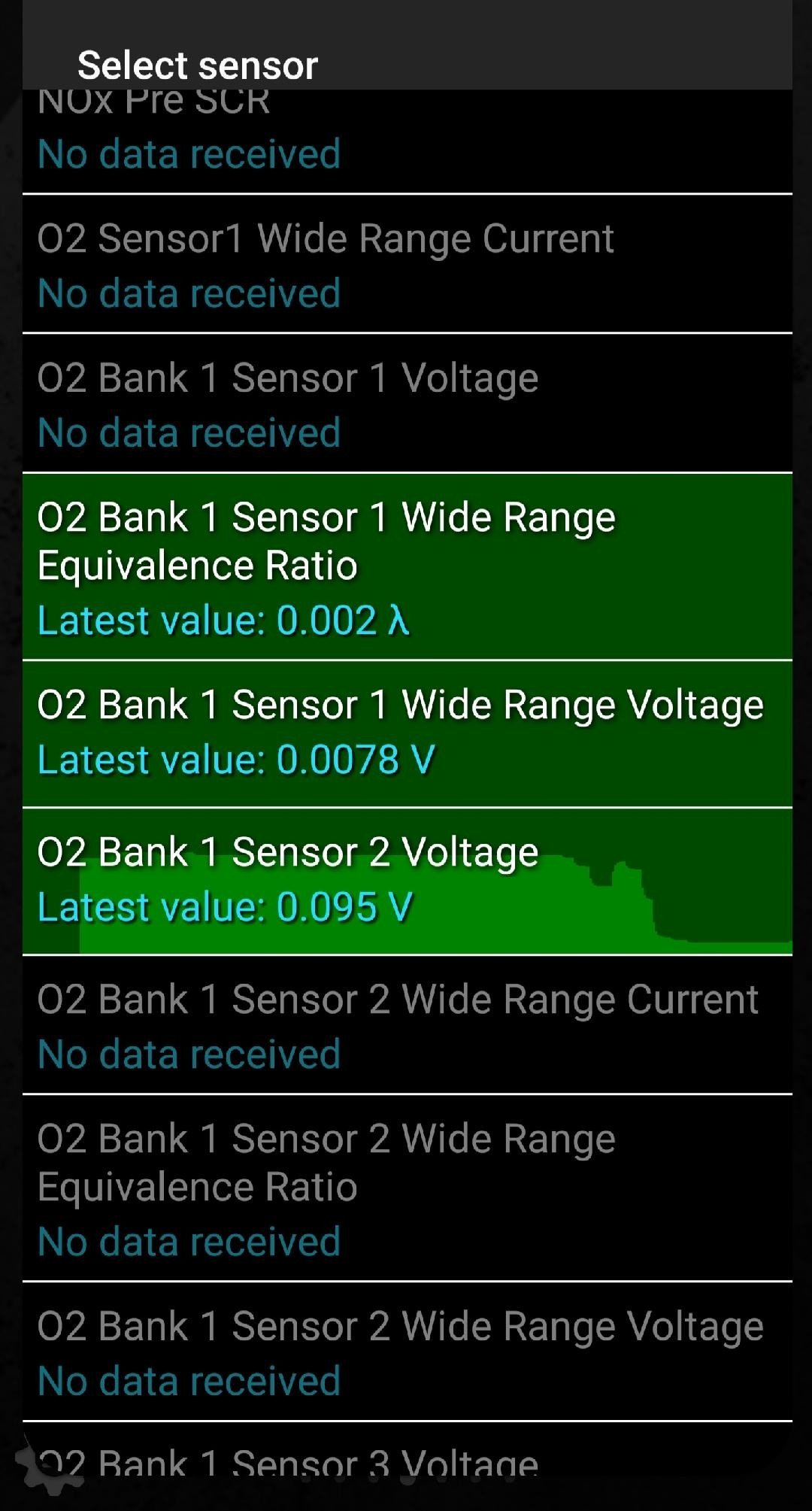

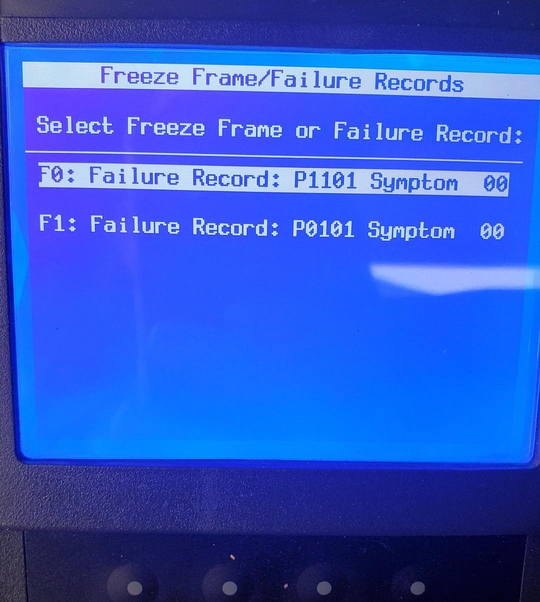

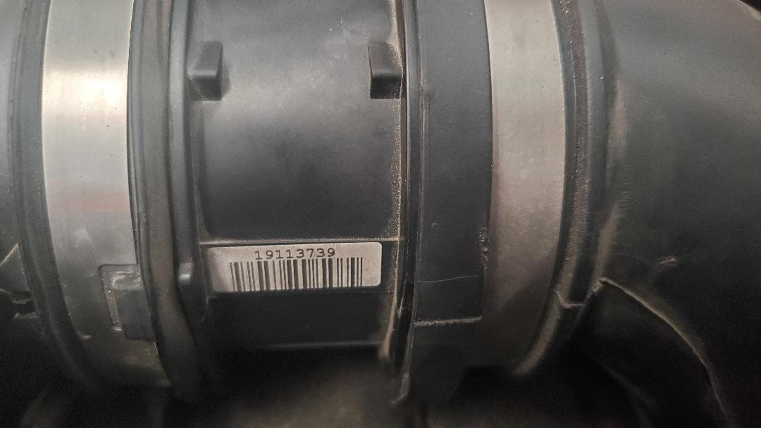

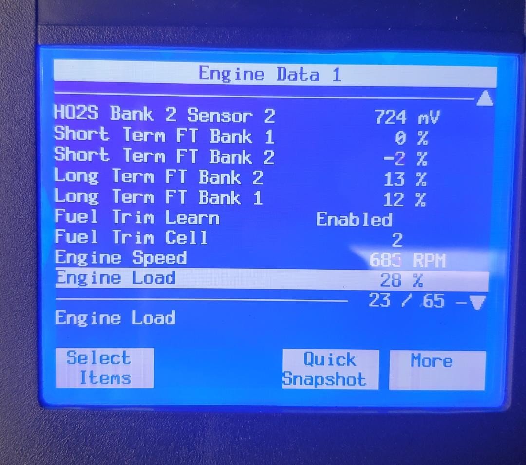

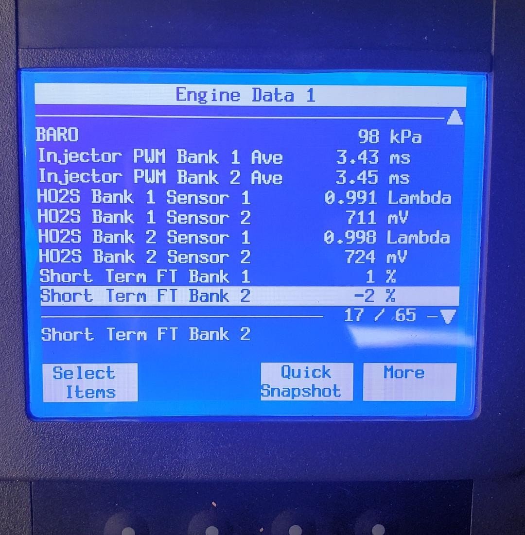

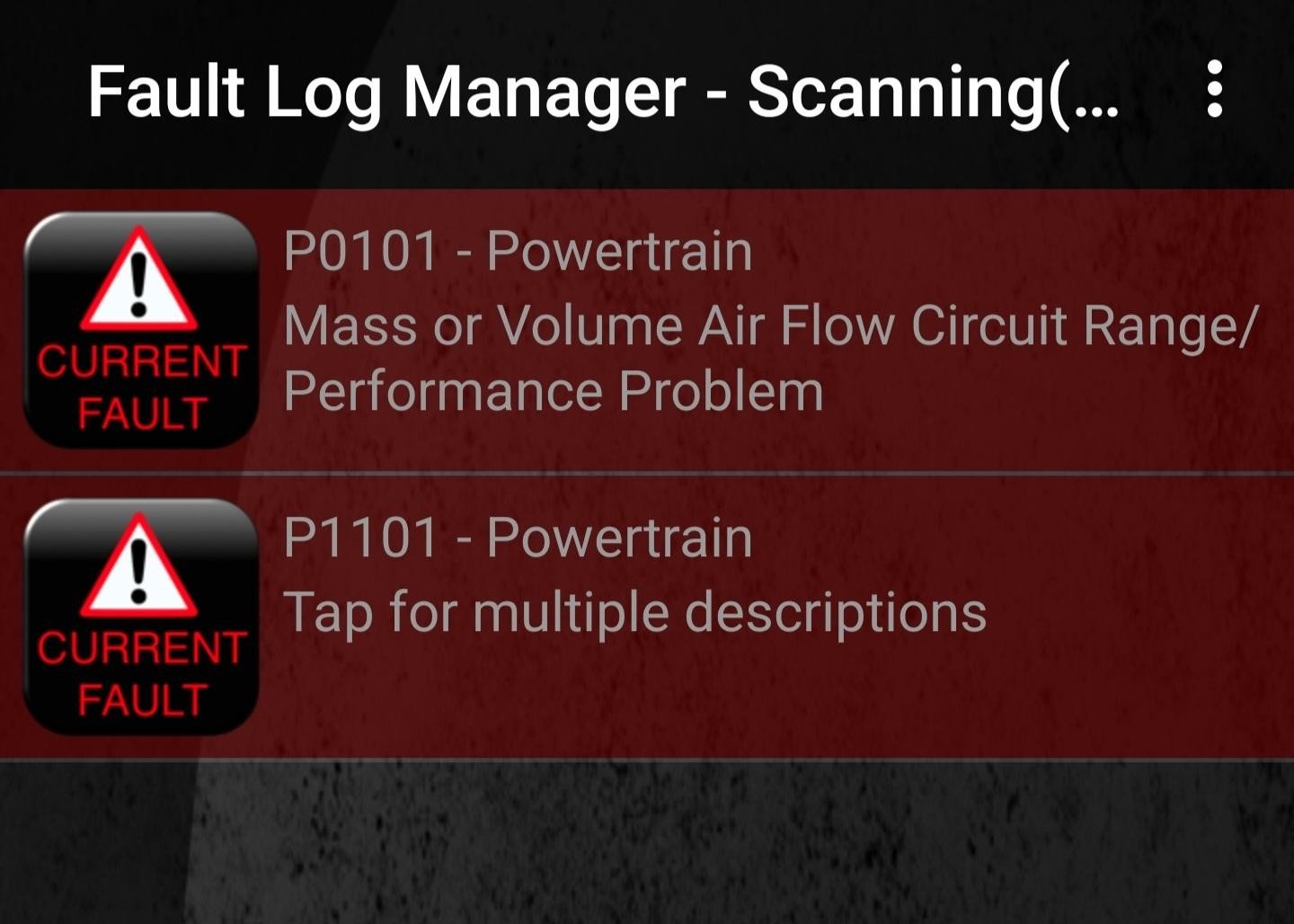

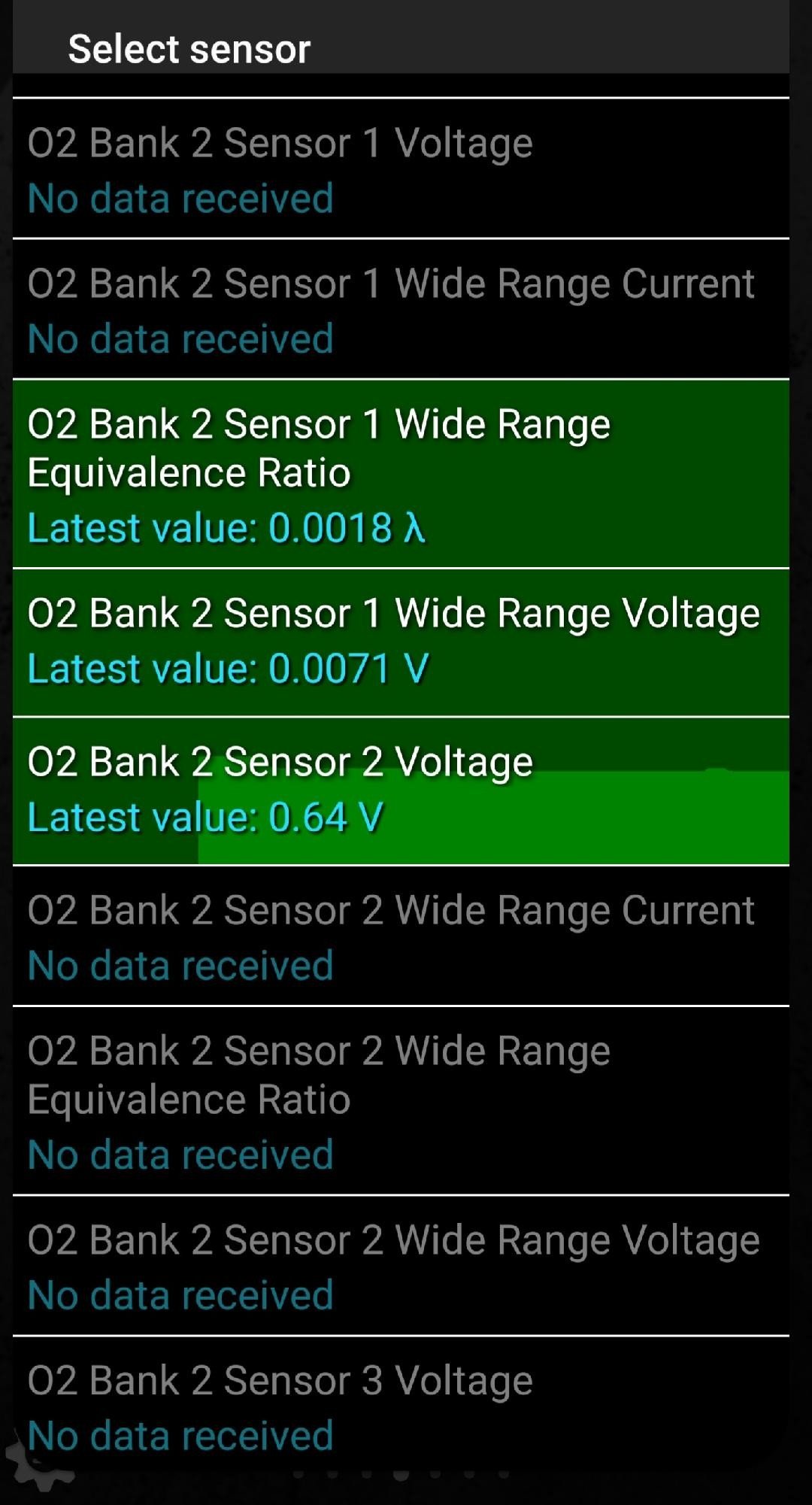

Check Engine light on. Used Tech2 to pull these DTCs. P1101 P0101. I cleaned the MAF with CRC MAF spray. Cleared codes. Drove 10 miles with no code. Shut off vehicle....Restarted and the check engine light came back on. This is the factory intake...new air filters. I used the Tech2 to look at the MAF signal and it would change from 3 to 6 when i doubled the RPMs....so it would seem the MAF is working. I also used my Torque app on my phone to view sensors. I've attached pictures of sensor readouts. Anyone have a fix for these codes?
