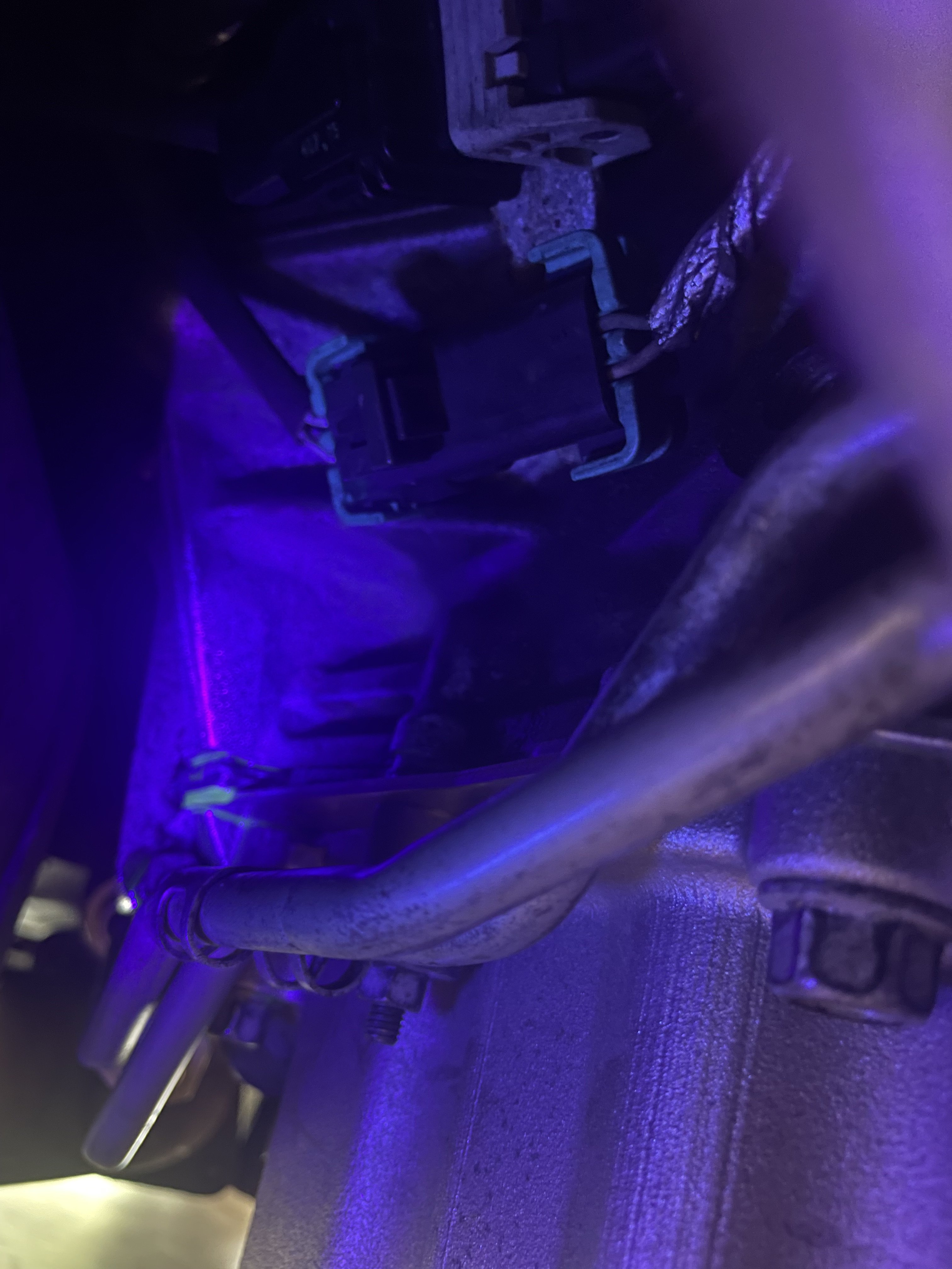

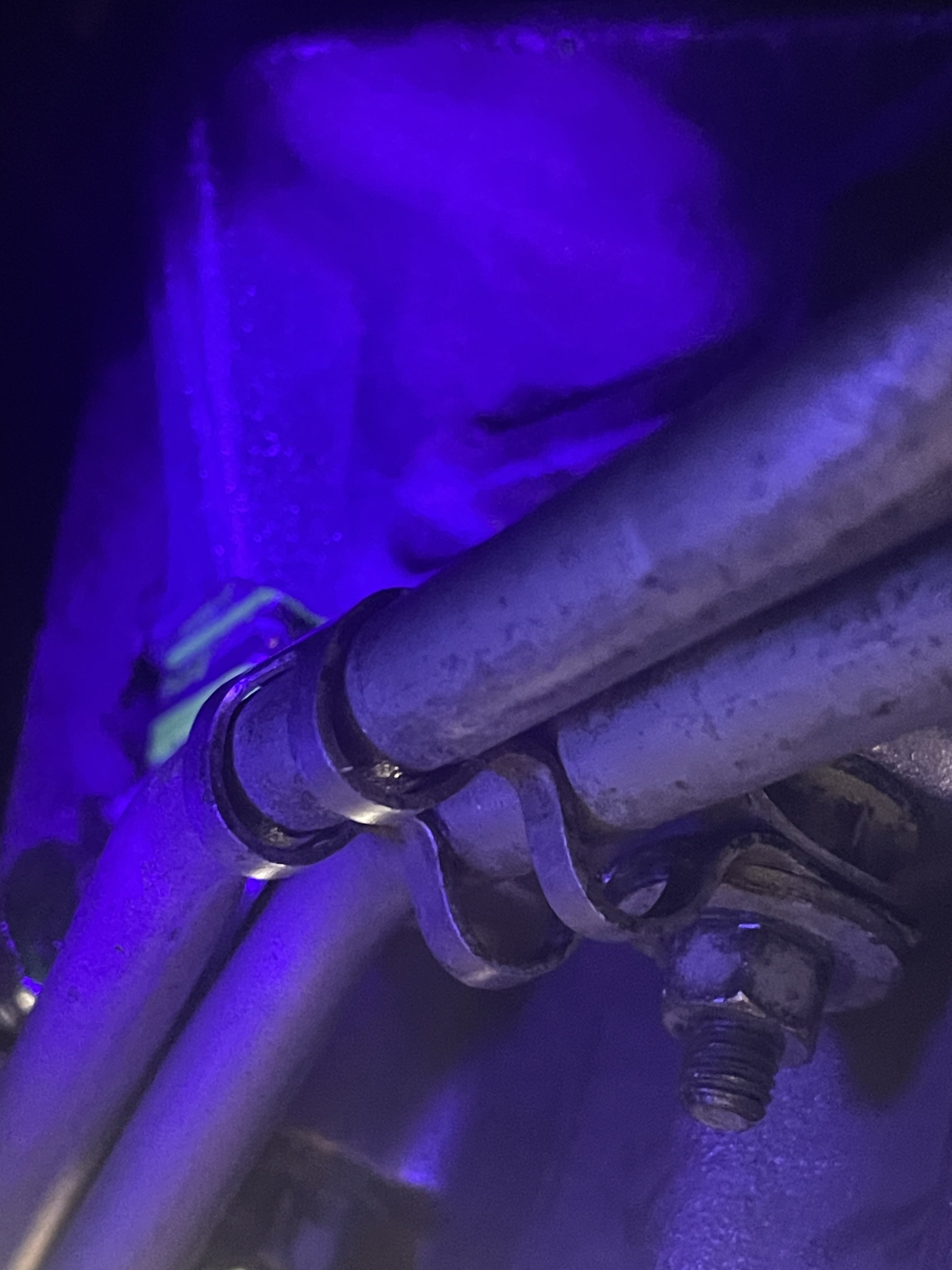

I have a pretty bad oil leak coming from the passenger side rear of the oil pan. I took it to the shop and they replaced the oil pan gasket and the windage tray above it. $1970 later it still leaks just as bad from the same spot. They put die in the oil and I have looked for a couple hours. It’s not coming fron the crankshaft seal or the ream main seal. Only the oil pan. I haven’t paid them yet. Now they want to pull the engine and do a total reseal. $5800. I just don’t know I trust them since the last repair didn’t work. Any input on how to advance would be appreciated

Not really a solid reply but the previous owner of my XLR did have to change out the valve cover gaskets - the resulting leak(s) ran down the side of the engine quite badly and made quite a mess. Just time, heat and age I guess.
I can't tell much from the pictures, sorry, and that's the only 'history of oil leak' I know of.
