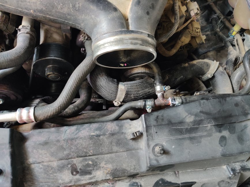

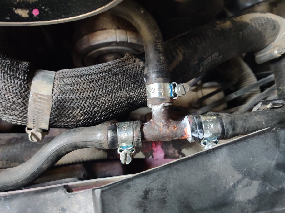

Hey everyone,
Just wanted to leave an update on what happened with my issue with the hoses.
I went to a shop that specializes in making custom brass connectors. They used the old hose, since it has a different size diameter on both ends. They fitted the connectors and everything is looking great so far.
