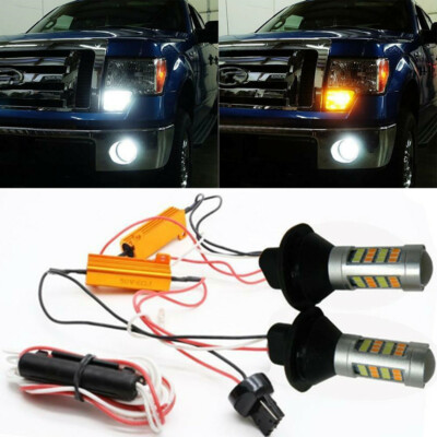

I installed these into my 2007 and they work great. If you read the amazon ad it states the protective case is heat shielded to prevent damage to anything nearby. Amazon ad says they will not fit the XLR but they do perfectly and no hyperflash or warning.
I tried to use these and the previously mentioned switchback bulbs in my 2005 XLR but they both produced Hyperflash only on the left (driver) side. Didn't matter the plug polarity or if I swapped the LED bulbs from left the right. Still had Hyperflash on the Left/Driver side. Right /passenger side had no hyperflash. Humm
