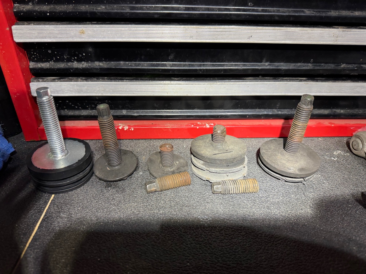

Have a replacement set of height adjuster screws to replace the ones on my 06. Found mine were missing the rubber pads entirely, and one of them was even snapped in half!
Anyways, I can jack up the spring, and with the shock and sway bar disconnected, I can get reeeeeaaaaaaal close to clearing getting the new one in there (it's taller than the old ones since it actually has the rubber pad).
Before I start doing dangerous math of how much I can push on the spring (where I'm lifting the car off the jack stands) to get the extra clearance, what's the safer way to do this? Disconnect upper control arm from the chassis, maybe? I figure that would let me lower the whole knuckle without having to fight a ball joint.

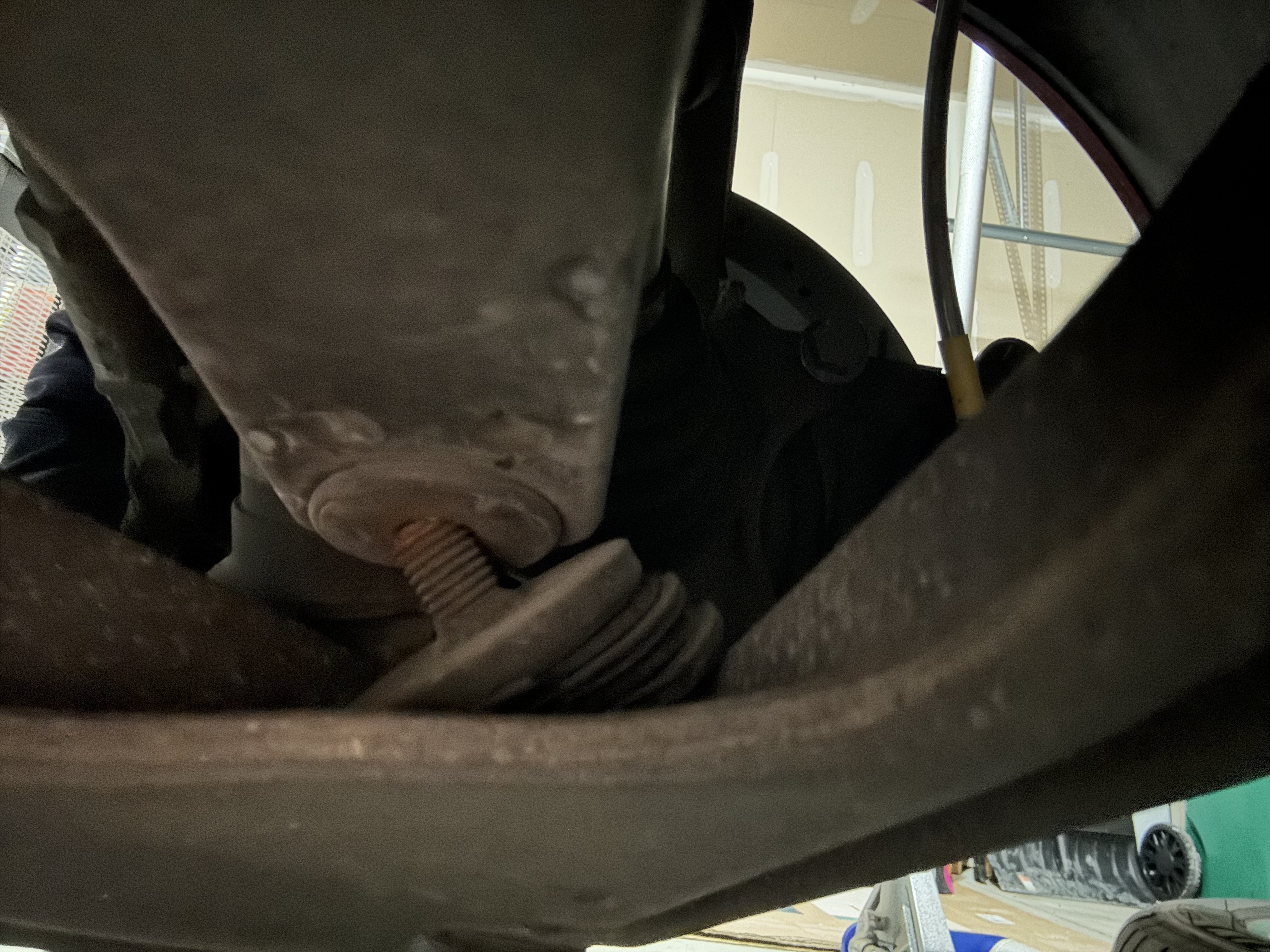

Above is front old vs new. Below is one of my rear screws. Check your height adjusters!

Posting more info, as I made an interesting discovery last night. Disconnecting the rear UCA from the chassis (as well as shock, sway bar link, and height sensor) doesn’t get enough clearance to drop the LCA far enough to get the height adjuster out of the spring. There isn’t enough clearance between the LCA and the driveshaft. The corvette guys and the video indicated above seem to be removing the whole knuckle in its entirety, I’m trying to avoid that as I don’t want to do battle with ball joints on this job.
I’ll be disconnecting the LCA at the frame, which means marking the alignment bolts to put them back in the correct position, and getting an alignment afterwards (which is advisable anyways).
Torque specs for the LCA cam bolts: 145Nm for the front bolt and 95Nm for the rear bolt.
Edit - confirming this method worked and got me the clearance I needed. Rear adjusters can be changed by only disconnecting the LCA at the chassis, sway bar, height sensor, shock, and tie rod end.

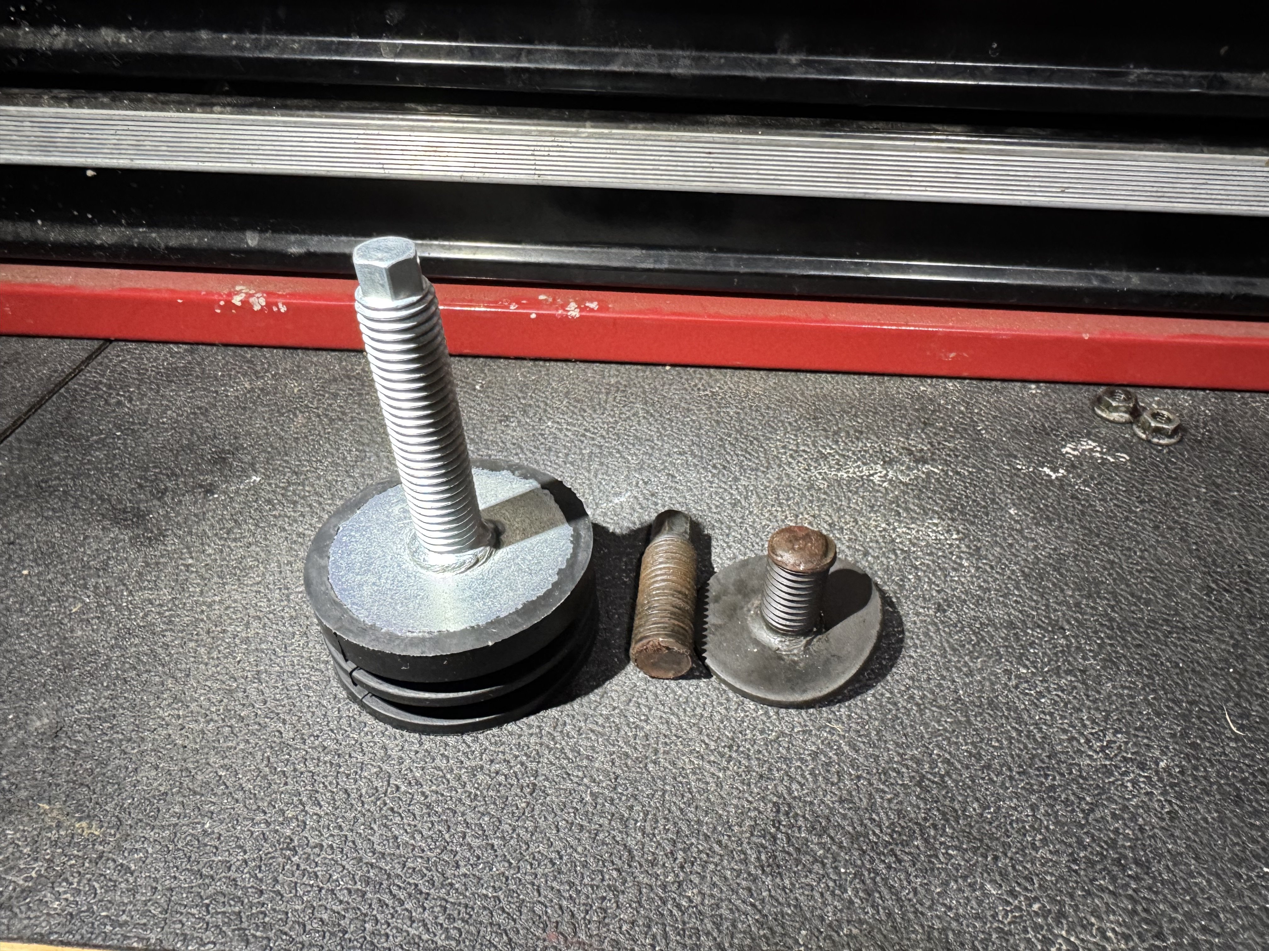

Adding final update, buttoned up the job tonight, got the photo of one new versus the four I removed. Holy smokes.

Good job. Thats a lot of work.to late to rrcommend but i sand the spring where the rubber meets the spring to make sure its smooth. Plus add a touchnof silicone grease to the rubber. Not much.. Ive used the kent tool to adjust the heights as its really simple to release pressur so you can turn them. Not sure if it would raise it enought to remove them but ill check
