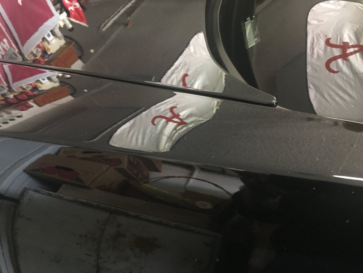

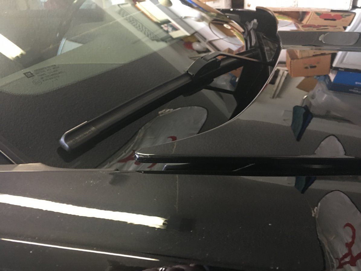

Just noticed that the windshield corner of my hood on the passenger side is elevated approx. 1/2" when closed. Driver side is flush with the fender as normal. I cannot detect anything that is preventing the elevated side from resting flush with the fender. The channel from windshield to grill is consistent from side to side. Is there an adjustment somewhere that may have become errant? Anyone had a similar issue? Any input appreciated... thanks!
These are photos of the hood corners on my V. There does not appear to be anything the hood is contacting that would force the passenger side to be elevated. Perhaps the bracket needs adjusting, but nothing is loose.

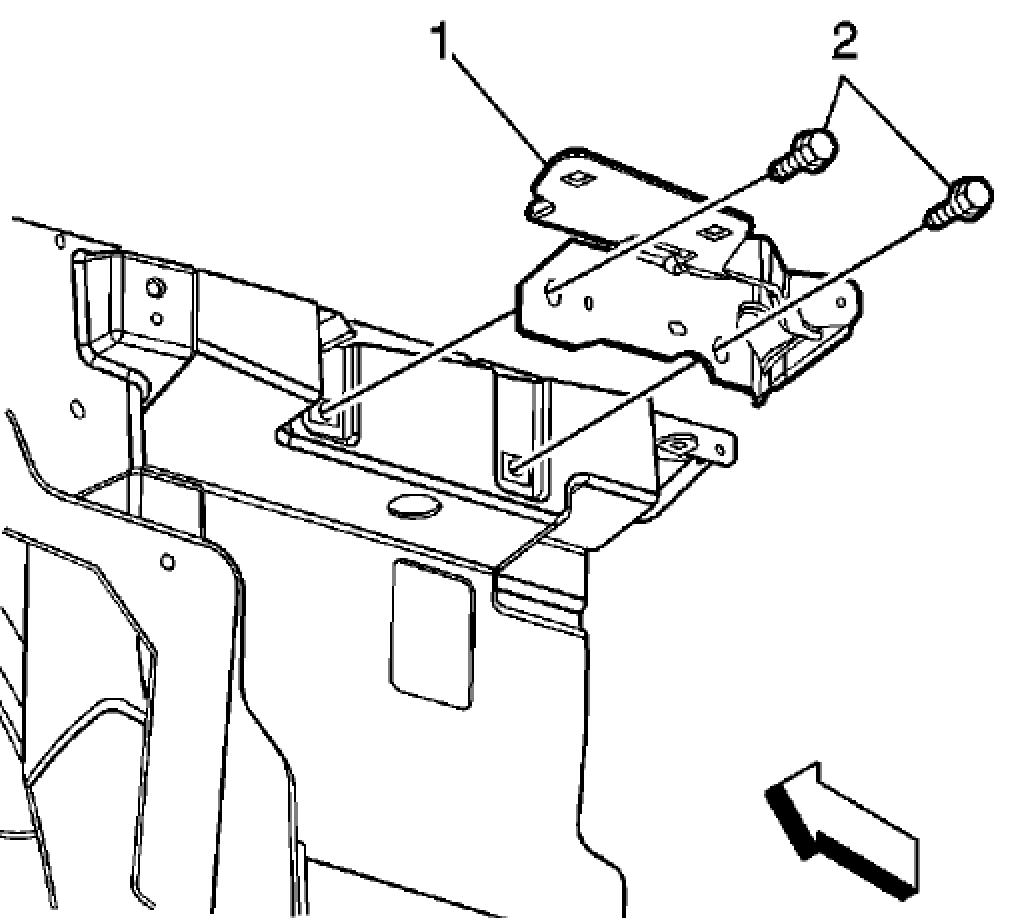

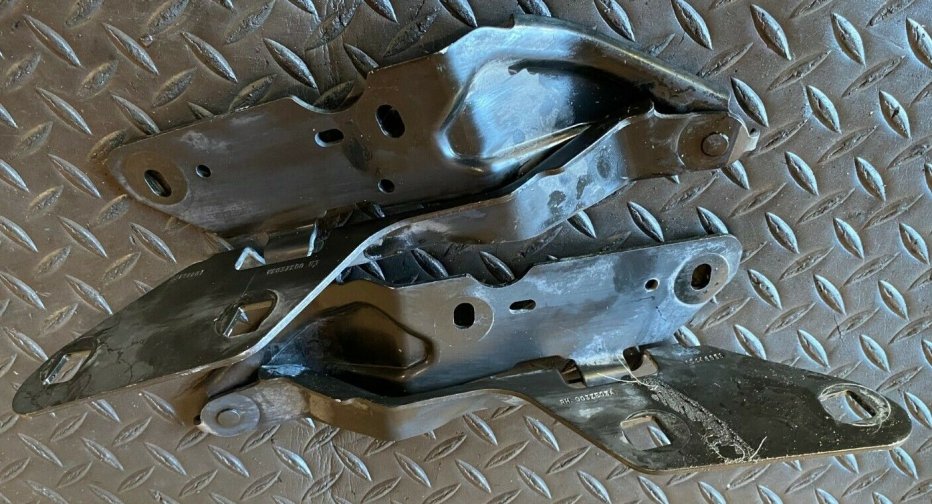

Hi JJSEA55.
The XLR hood hinges do not have the reputation to be defective, if the adjustments are fines it could be the hinge it self.
A unknow stress could have the levers of the hinge been bended.
The lower hinge lever is part of the inner fender structure and have the long adjustments holes for the up and down of the hood, a hood stopper is also part of this lever ( is it bend ? )
The upper level is bolt on the hood it self, the squares holes are for the front and back of the hood and are both hinged on rear of the hood that swing up and down for the maintenances.
If the stress happen, the levers could be bend and the hood could not close properly.
The purchase of a used fine hinge could be the solution, they are at a reasonable price on eBay.
Enclosed are the photos to help you in the search for the solution.
Good luck.
IAN. :wave:$_57[1] (2).jpgSans titre.png
