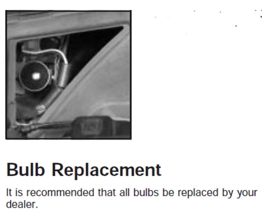

Hi TOM
Your owners manual recommend to have all the bulbs replaced by the dealer, obviously this safety aspect seems that only the Cadillac shops, could do the repairs.
Enclosed is a photo that shows you, were inside of the engine compartment that it could be done, however you need small hands and long arms and the know how.
The proper way to do it,
is to remove the headlights and the front wheel housing lower panels to access to the lights nuts and retainers, on a hoist its ideal…. the dealer has it and its labor rate is also hi for a such simple (usely)replacement.
Many owners have it done to the corvette/Cadillac repair shop,(supporting the XLR owners net work) they have the know how, many also knows the XLR product.
While you are in this repair, have you had the idea of replacing them with LED bulbs.
Good luck.
