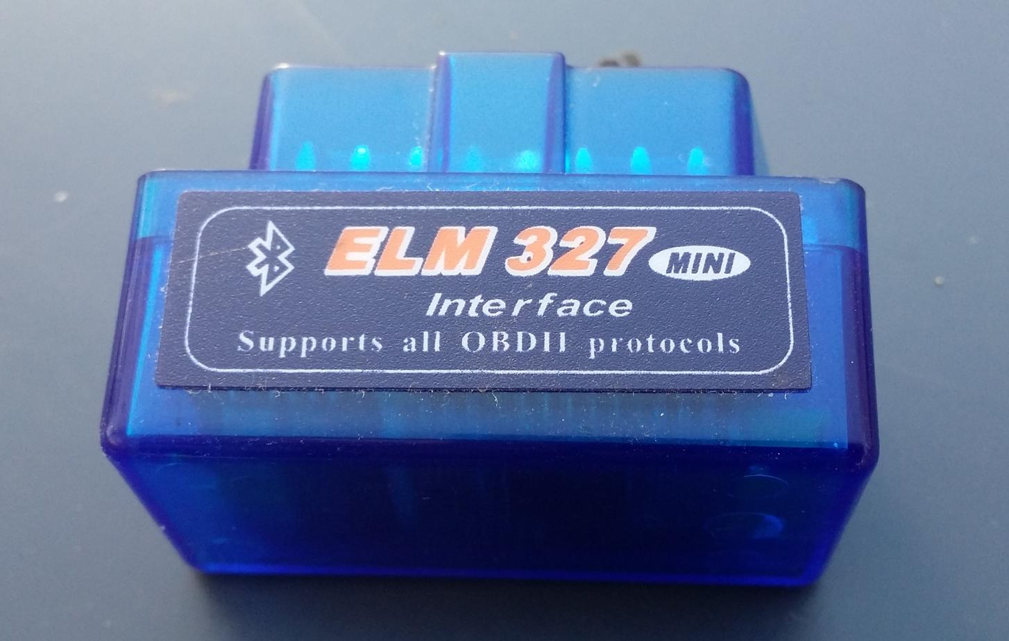

I'm on an Android phone so I can't say much about iPhone. The name of the app is Torque. It is more of a performance related app. with gauges, data recorder, GPS and G force charting etc. It does have troubleshooting codes and clearing. Not every function is available on every brand of car, but anything environmental is always available.
The bridge, or interface, looks like this 20150120_155500.jpg. At the time I purchased it on eBay a couple years ago there were many with the exact same appearance. Online research showed that some worked well while others did not and they were differences internally. It mattered a lot who you bought it from. I would be sure to get reviews of the vendor before purchasing. Mine works fine. Sorry, I don't remember the seller's name.
