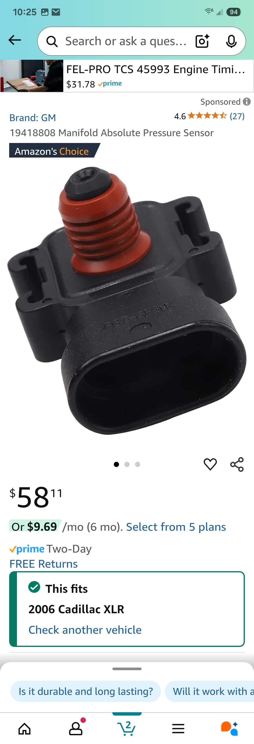

Need some help and clarification on fault codes P0171/P0174, that points to bank1/bank 2 lean. I have read through all the past threads about this issue. I have a Volant CAI on the car, and it seems to be somewhat common issue. What I am looking for is the exact part number for a GM AC Delco MAF sensor. My local mechanic suggests that a full tune-up is in order at a cost of $2200.00, the local gm dealership wants $3000.00. I figure I would start with the things that I can do myself with some certainty. I will check the manifold/plenum bolts and gaskets, new plugs, check for vacuum leaks, and MAF sensor. I am having a hard time finding the OEM AC Delco MAF sensor part number. Any help or insight will be greatly appreciated.
