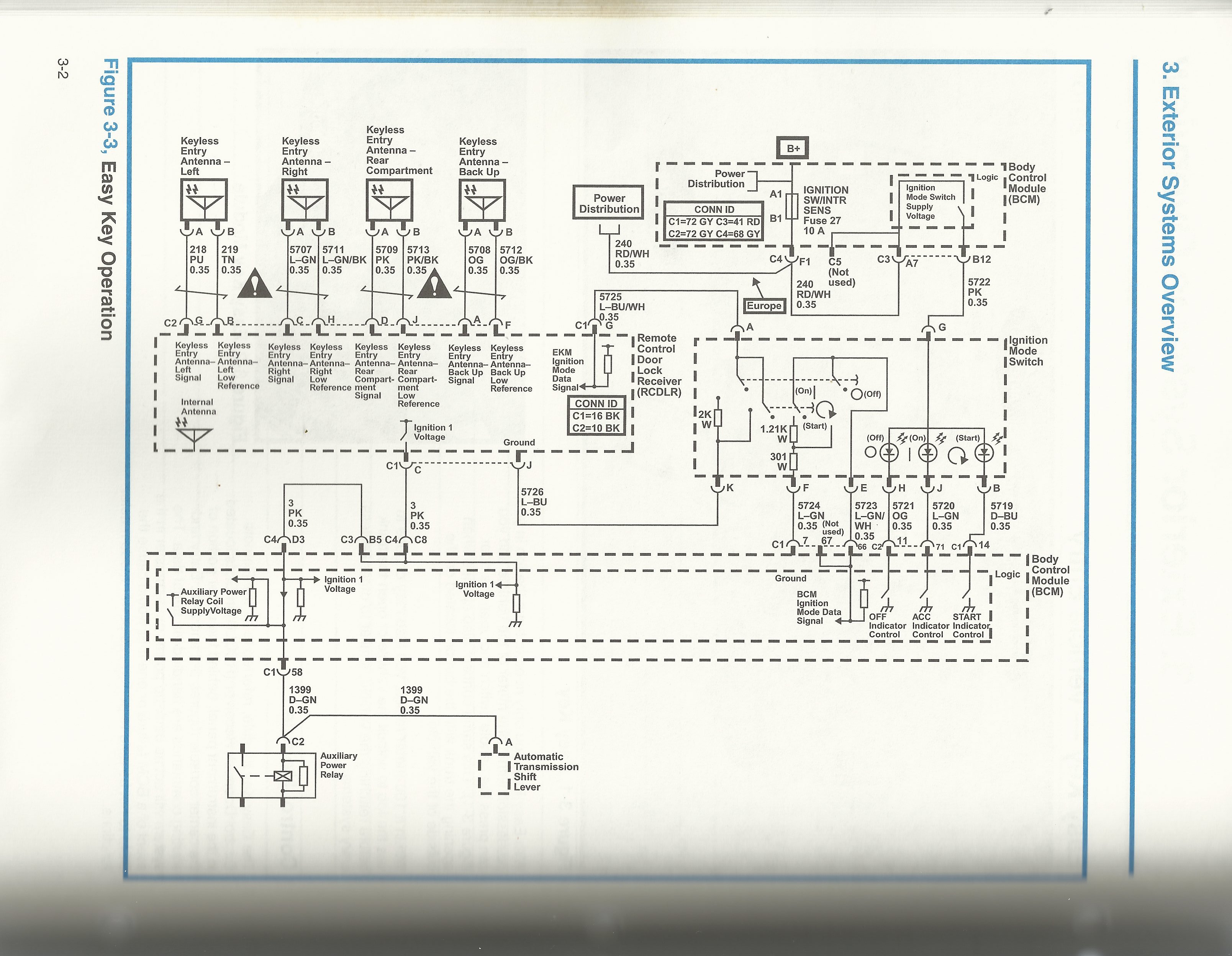

I agree with Amy. Most of the sounds you are hearing, is the car 'waking up' after sensing the fob. Pressing on the brake to start the car, sends voltage to the solenoid that controls allowing the shifter out of park, another clicking sound you probably hear.

Correct. One set of noises is the AC rolling film mode door, and the click heard when depressing the brake pedal is the transmission shift lock solenoid.
